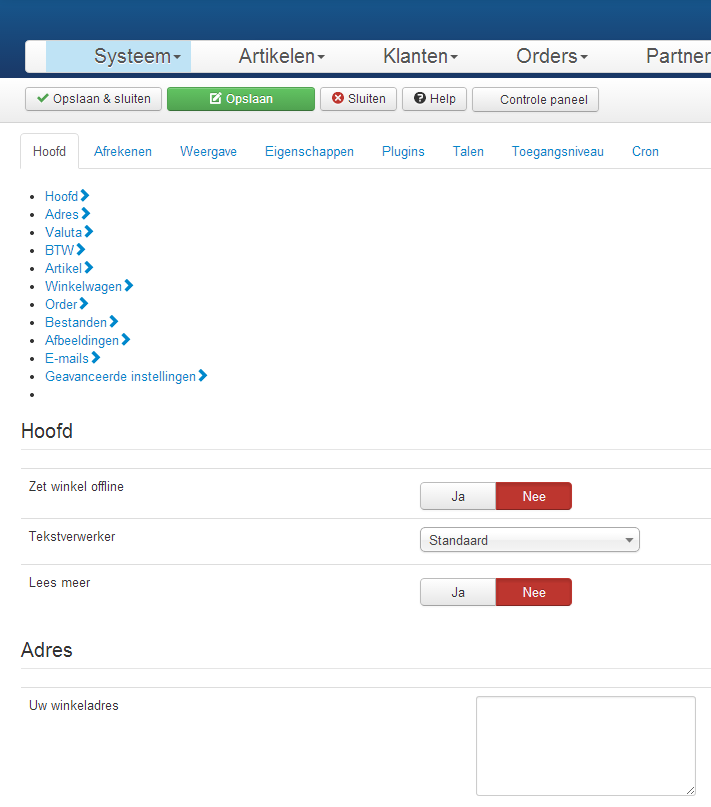

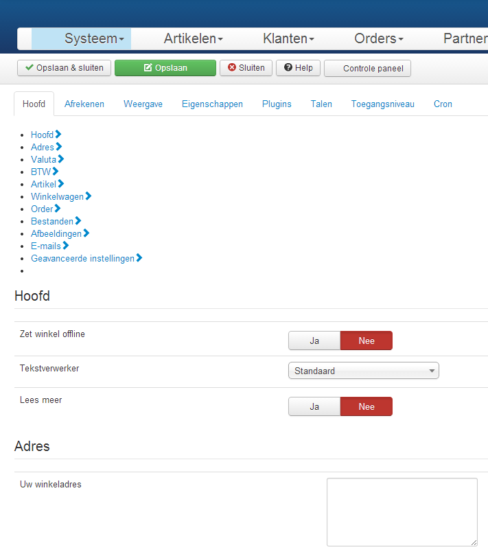

The problem is that i have set an option "on" or "off" and now i can not get enything via hikashop on the shop page.
and it is starting to Frustrate me...

You can reset all HikaShop configuration option by copying all values of the column "config_default" into the column "config_value" in the table "hikashop_config".
UPDATE #__hikashop_config SET config_value = config_default
You have to replace "#_" by the joomla database prefix.

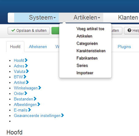

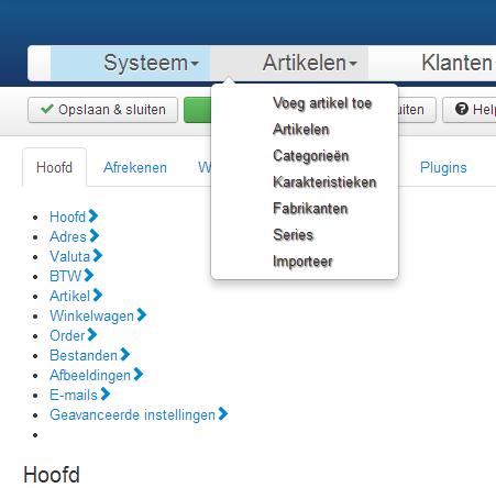

Got that done but now this has happened, is this due to resting of the database .??? ( this happened straight after the reset.)
i have reinstalled hikashop but nothing seems to help. (TNT is a option i suppose.) ;-))
thanks ;-)
12 years 5 months ago #145654
Can you change the "menu position" option of the page "Hikashop->System->Configuration->Display" to "above the content" and test it again ?

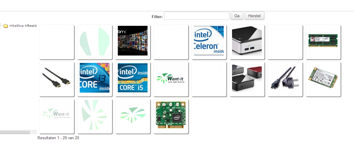

This is a capture of the image selection popup of the products. What is the problem with it ? It looks normal to me.
  • Posts: 8
12 years 5 months ago #146186
yes it is a capture of the image popup screen but half of them are white and do not display the image, and the images are not bigger than 300 x 300.

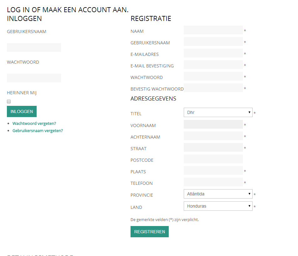

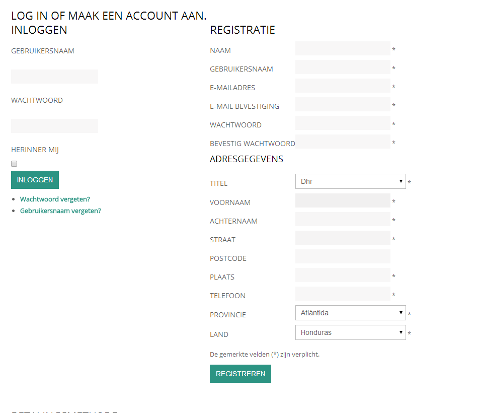

and for reason i can not select holland or netherlands in registration it is not there. how do i add a country in the registration section.??

12 years 5 months ago #146245
What is the image type ? JPG, PNG, ... ?
Regarding the size, thanks to check your parameters in Configuration > Main > Images.
For the countries not present in the registration, they maybe are no more published in the zones, you can publish them again via the menu System > Zones.
