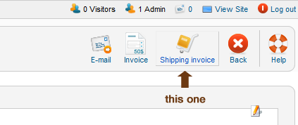

Hi Guys,
I cannot see in the backend a template for shipping invoice? Is there one in the views section?
Alex

12 years 3 months ago #147240
Hi Eliot,
Thanks for this, I see the invoice however there is another one, called shipping invoice, please find attached (this is button is visible on the order page).
Alex

12 years 3 months ago #147249
The "invoice" and the "shipping invoice" are using the same view in HikaShop.
You can customize the "(shipping) invoice" by overriding the view "order | invoice".
There are one view in the front-end (for the customer) and one view in the backend (for the administrator).
You will see in the page some " if($this->invoice_type=='full') " to make the difference between the invoice and the shipping invoice.

10 years 22 hours ago #244036
Where do you access the invoice in the back end. this screen shot pictured in your post. Where do i find this??? help. Im going crazy. I am sure I saw in the back end a simple way to add your own logo and customise the invoice . Yet now I cant find it anywhere. Please help
  • Posts: 85786
  • Thank you received: 14079
9 years 11 months ago #244731
You can customize the invoice of HikaShop by editing the file "invoice" of the view "order" for your backend template via the menu Display>Views.
