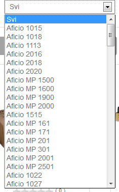

About subcategory order in filter....I think that you dont understand me....
Here is printscreen. I choose category filter to list all subcategories in category I chosen. But I want change to alphabetical order.

I investigated, and find in administrator/components/com_hikashop/classes/filter.php:
$database = JFactory::getDBO();
$query='SELECT * FROM '.hikashop_table('category').' AS a '.$left.' WHERE category_parent_id='.$parentCat.' '.$optionElement.' ORDER BY a.category_order ASC';
$database->setQuery($query);
$categories_name=$database->loadObjectList('category_id');
return $categories_name;
Should I change this parameter to solve this problem ? I tried to put ID of my parent category and change order to NAME, but nothing happens....but I think that I am close to solve problem.
Can you give me advice ?
  • Posts: 15
12 years 3 months ago #155076
I found solution. Just I don need to put ID category.
