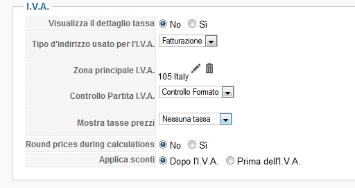

I enclose the current settings of hikashop VAT
thank you very much!

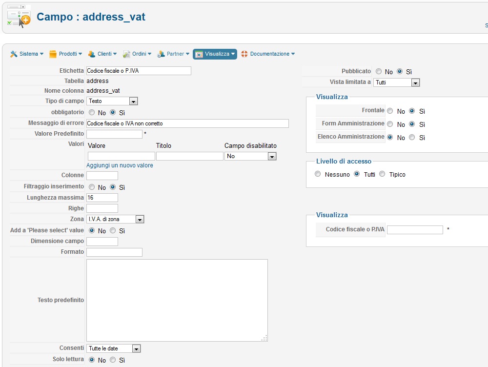

  • Posts: 22
12 years 3 months ago #153793
hello nicolas, such as putting only the letters in the field of VAT registration freezes and will not continue ... the settings are set as per the attached images. should fail and block the other hand, how is it possible?
I have not edited the file, and I installed component hika business
thank you!
  • Posts: 86042
  • Thank you received: 14175
12 years 3 months ago #153860
Can you provide a link to the registration page so that we can see that ?
  • Posts: 22
12 years 3 months ago #153955
ok here is the link cfiscuola.it/component/hikashop/user/form.html
at this time the settings are as shown and the VAT is Italian
I also tried to insert only letters but does not block .. what can be the problem?
thank you!
  • Posts: 86042
12 years 3 months ago #153977
I see that you removed the "country" field from your address form. However, the system bases itself on the country of the user in order to know if the user VAT number should be checked or not (Only customers with their address in the European Union will have their VAT numbers checked).
So that's probably why it doesn't perform any check as the system believes that it is not needed.
