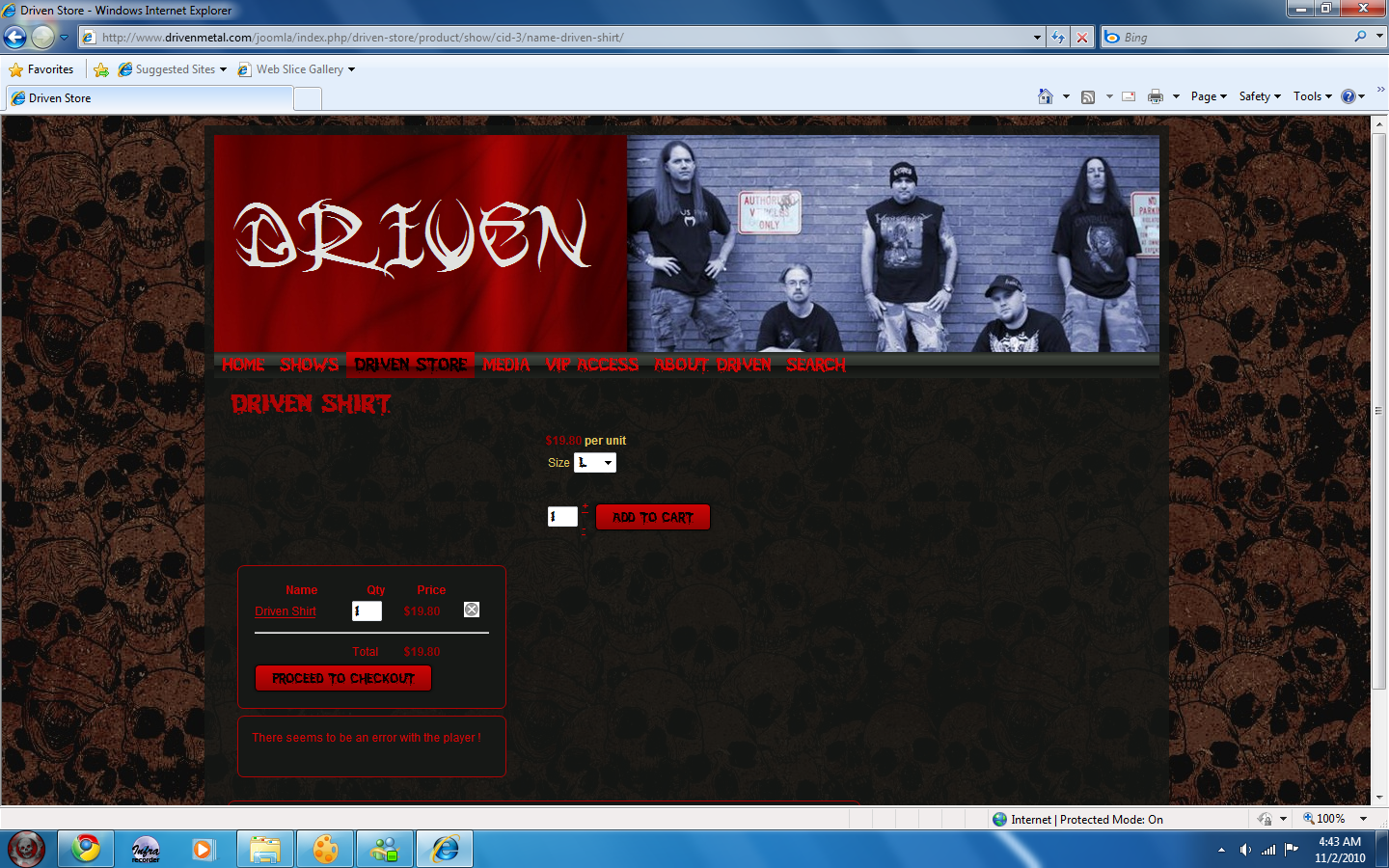

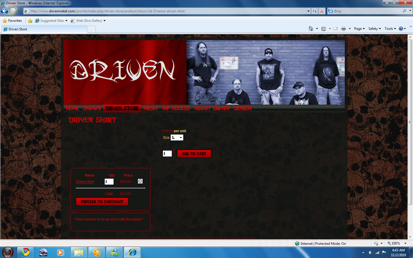

15 years 9 months ago #885
Here is a screen shot

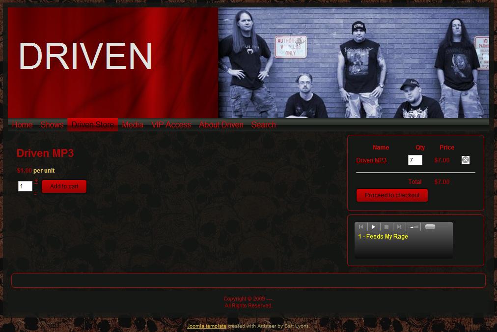

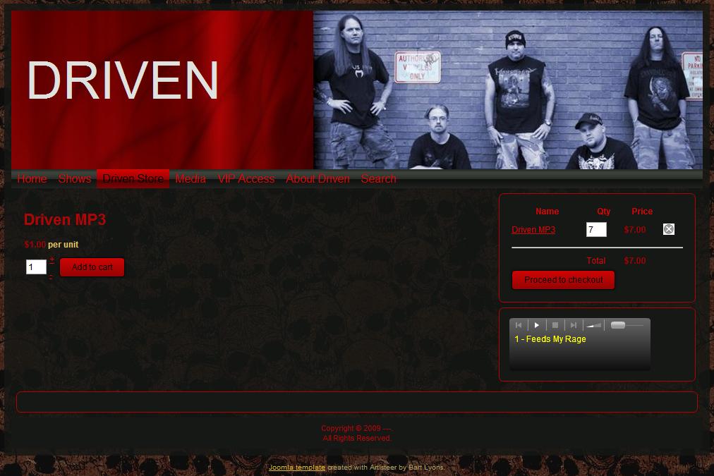

15 years 9 months ago #888
Here is what I have:

15 years 9 months ago #890
Ok it didn't do it when i added the mp3 download your using. Try the Driven T shirt.
