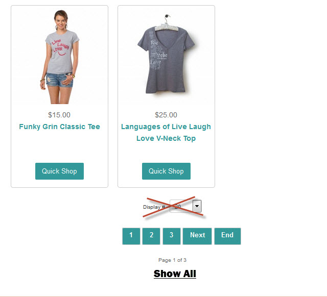

I would like to change the behavior of the pagination "Display #" or add to it somehow by having a simple link that displays all of the products in the category I am browsing.
in other words, I would like a link with the same functionality of the "all" value in the drop down. I have a mockup below (very rough)

1) Thank you. I already know how to accomplish that. The red cross on the select list is there for illustration purposes. as in "I do not want this but I want that"
2) I am aware that something is needed in listing_div in the place of the snippet. The question is what? Has anyone ever written any code in there to accomplish something similar?
