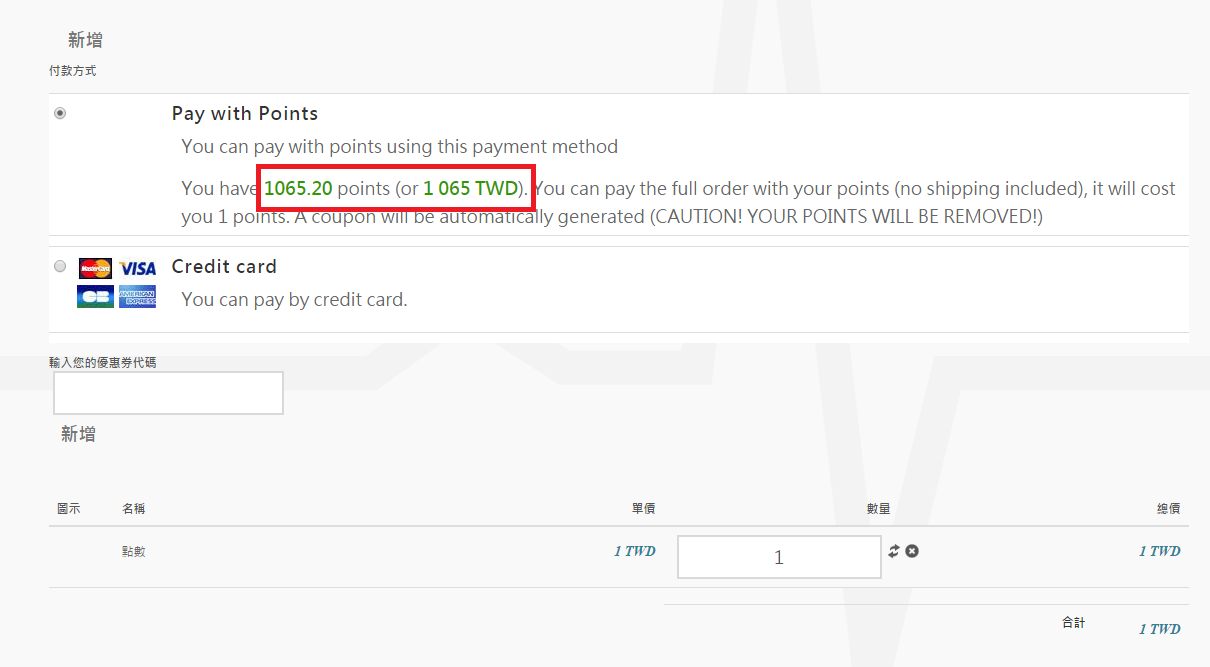

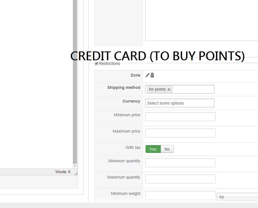

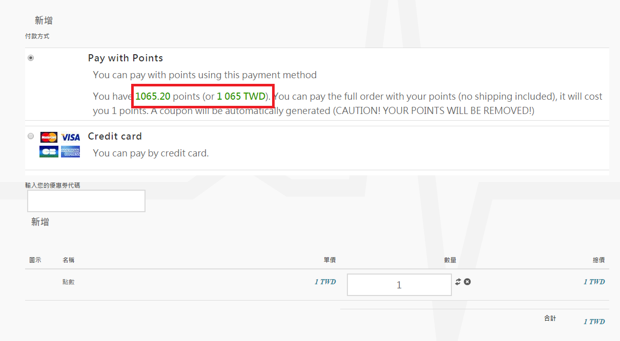

***GOAL : I do not want users to purchase userpoints with userpoints.
If I could assign different payment method to different categories, this could be solved.
But I have tried the "restricting to shipping method" way to do it, like others pointed out, even after restricted to shipping methods accordingly to warehouses, all payment methods are still shown on the check out page.

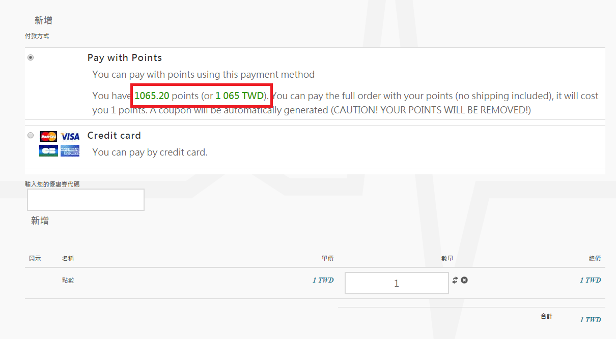

Restricted by currency could be another direction to resolve this problem, because I created a currency of userpoints, however, Hikashop simply auto-converts the currencies...as shown in the attached image.
Can anyone help resolve this?
Thank you very much!
11 years 9 months ago #175475

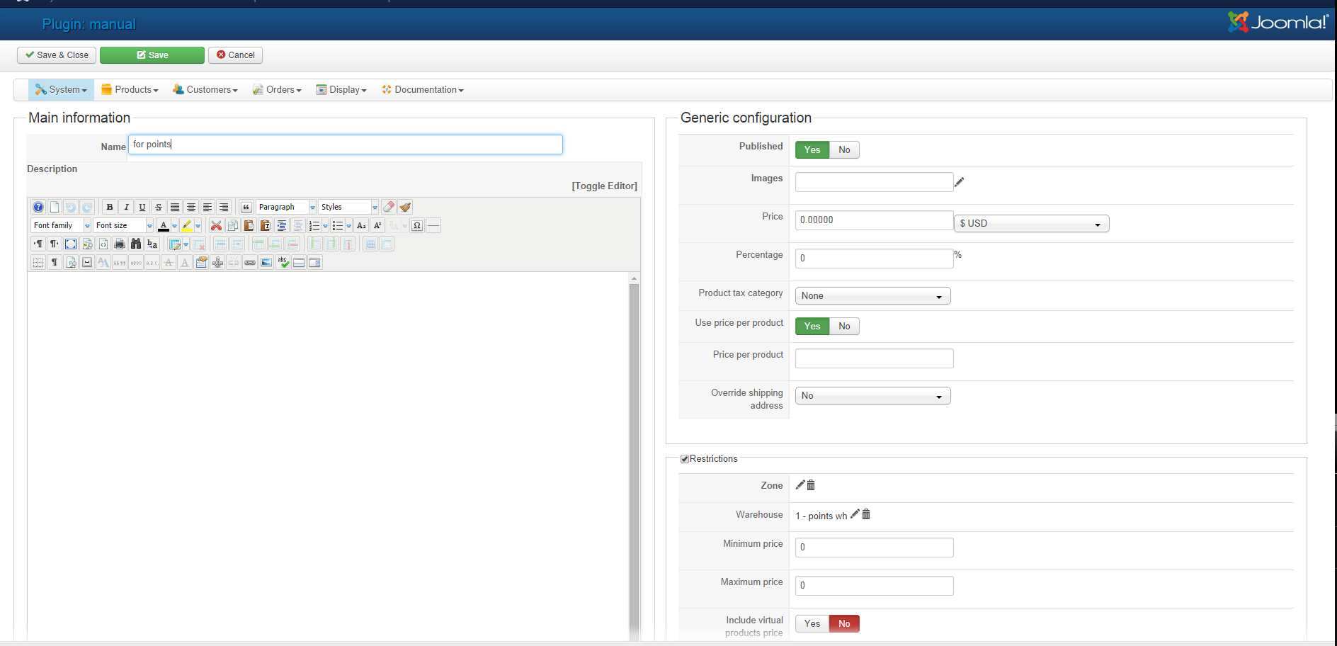

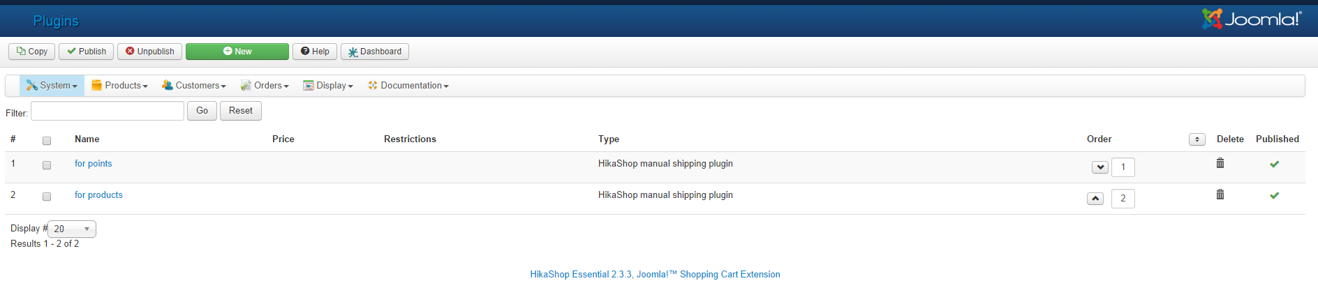

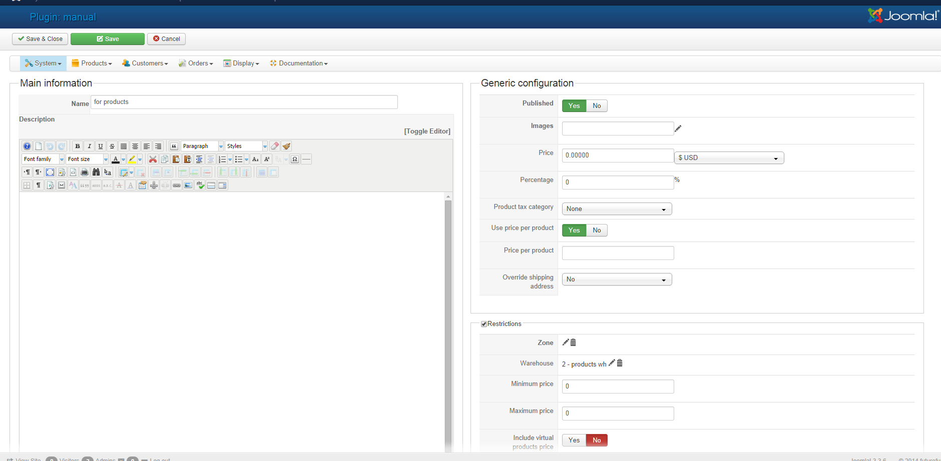

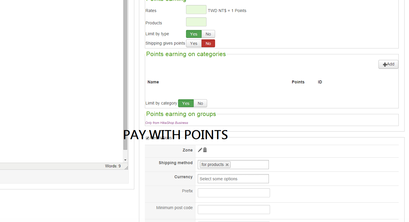

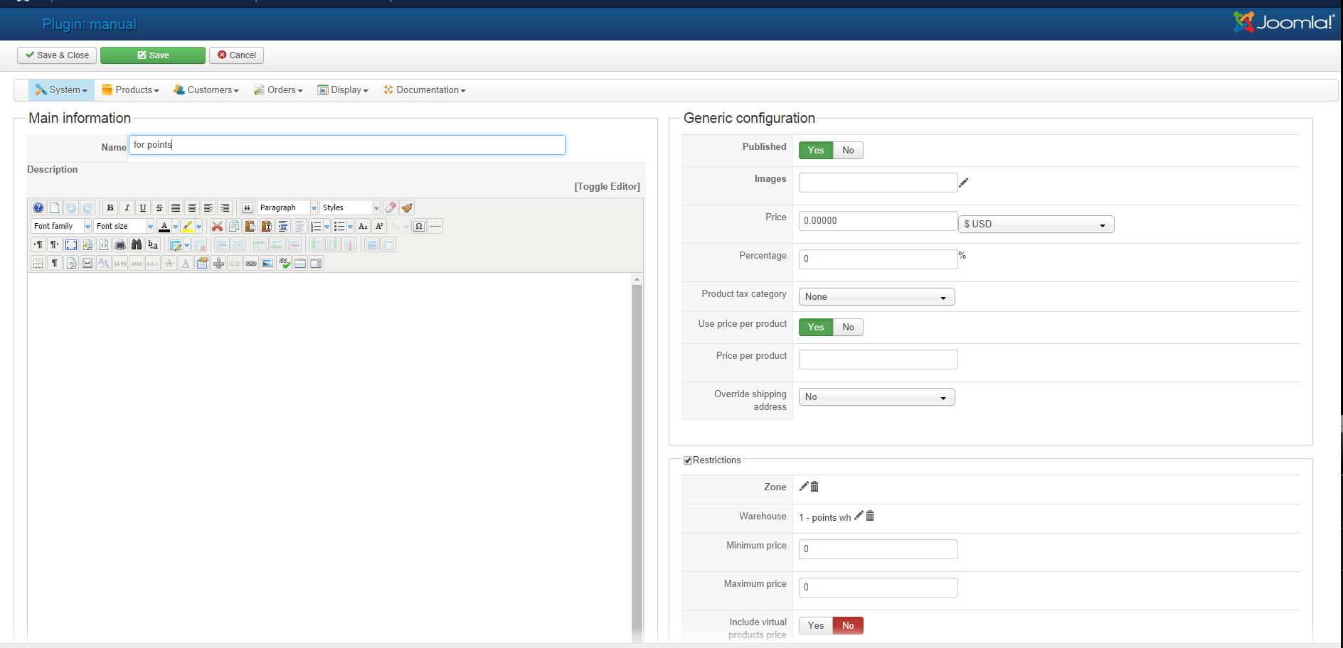

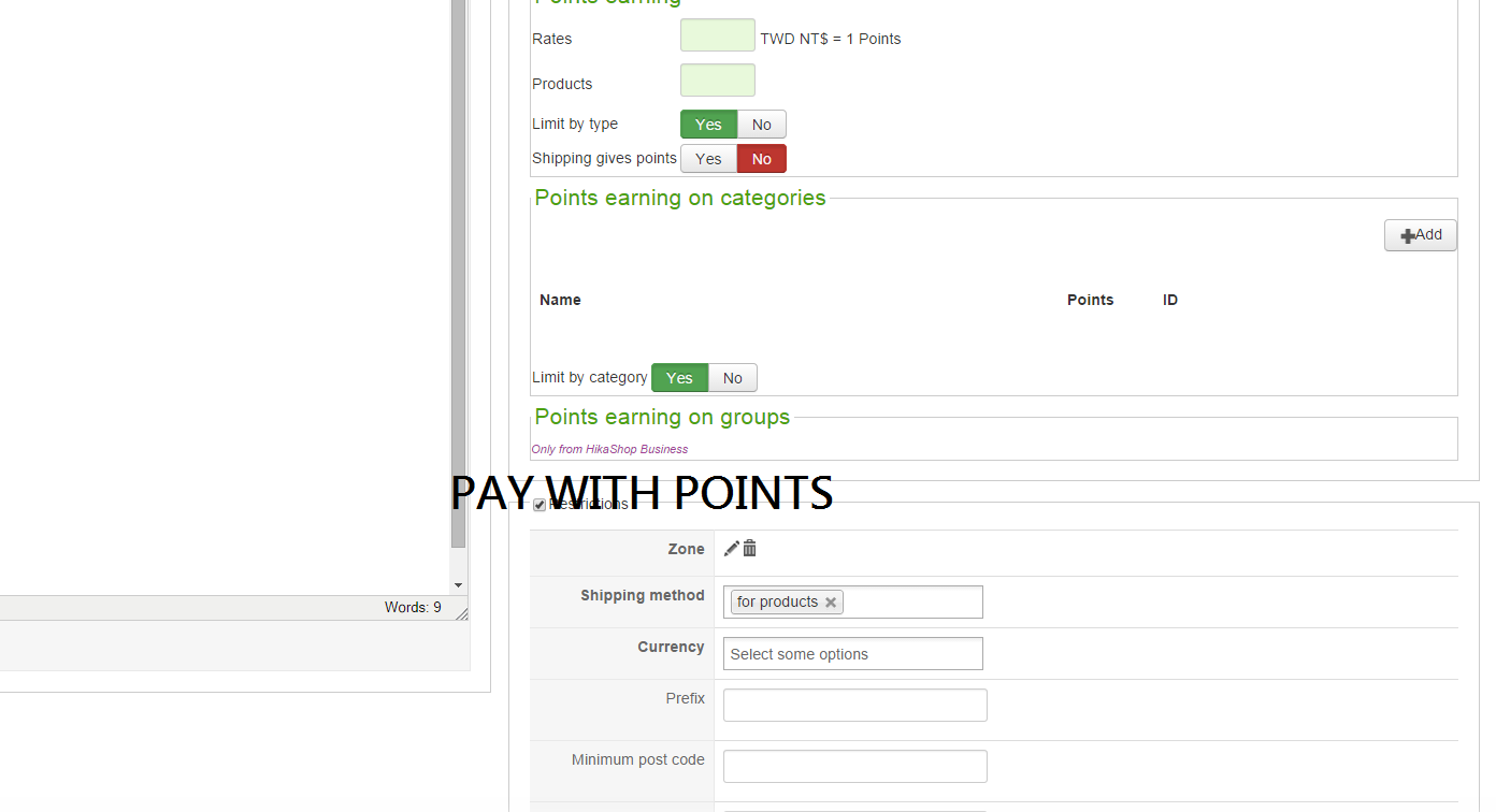

Note that the solution can be to restrict your product categories to different shipping methods (using warheouses) and then you'll just have to restrict your payment method to your shipping method through the "shipping method" option of your Payment method configuration page.
  • Posts: 7
11 years 9 months ago #175632
yes, that is what I did, but by doing that, all payment methods are still shown on the check out page
is there any other way to do it?

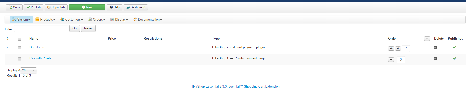

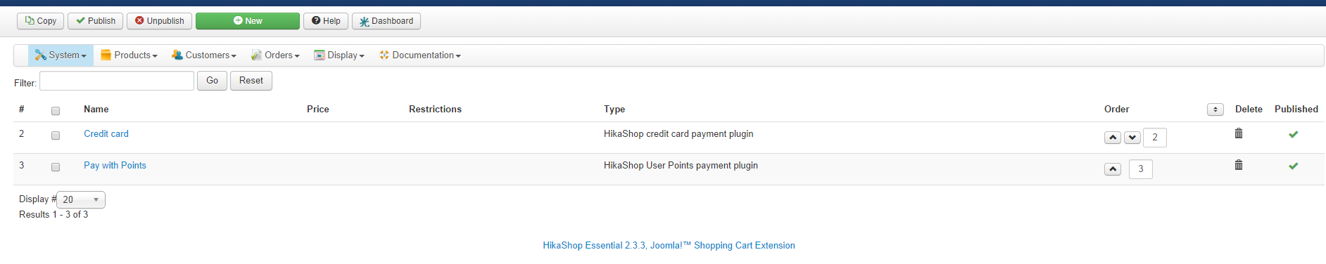

11 years 9 months ago #175786
Can you show me some screenshots of how you configured your payment method ?
  • Posts: 7
11 years 9 months ago #175851
I posted this before, was asked to start a new topic
11 years 9 months ago #175949
I just tested it on my end and it worked fine, can you give me a temporary access to you backend through a private message so that I can directly test it and find from where your issue is coming from ?
