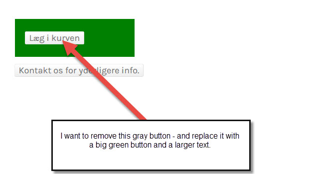

How can I remove the cart button - and replace it with an image, or style it in the 2.3.4 version of Hikashop?
I can style it a bit - but the button-image (the grey button with shadows and radius) won't go away.
What style class should i look after to completely remove the button-style cart and replace it with my own background color - both link and hover - and own font-size style (see attached file)
Kind regards
Thomas

Depending the HikaShop option "Button style" you're using, the button will be "HTML button" or "HTML link" (a tag).
www.hikashop.com/support/support/documen...html#display_general
Using "a" button, it will be easier for you to customize ; to use CSS in order to put an image.
Otherwise, you can use view override in order to change one specific button.
But depending the type of the button, some are not accessible in the views and might require plugin override (like the "add to cart" button).
www.hikashop.com/support/support/documen...tation.html#override
