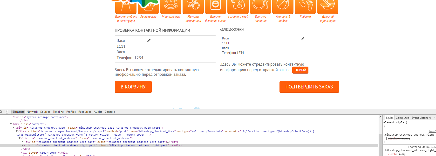

Third is: how to remove "hikashop_checkout_address_right_part", i'm don't need payment, i need only delivery address, i know that i can write "display:none;" but i want to remove it or turn off :) Screenshot with example is below
Last edit: 11 years 5 months ago by Rabbiteggs.
11 years 5 months ago #191029
1. That's potentially because in the Display > Custom fields settings you have set a default value for the custom field.
2. You have to enable the option "Use AJAX when possible for add to cart buttons" in Configuration > Main > Advanced settings
The following user(s) said Thank You: Rabbiteggs
  • Posts: 102
11 years 5 months ago #191089
Xavier wrote: Hi,
Ajax in settings is turned on, i mean quantity buttons in checkout, when you already make a order, and in display>custom fields i must set a default value because this field with * :huh:
  • Posts: 26381
11 years 5 months ago #191232
To remove a default value in a required custom field, you have to empty the setting "default value" and switch the custom field to not required.
Then, you can save the custom field, re-switch the "required" (to yes) and re-save.
The first save will empty the default value and the second save won't put a default value.
This issue will be fix in the next HikaShop release ; I already put a patch few week ago for that.
