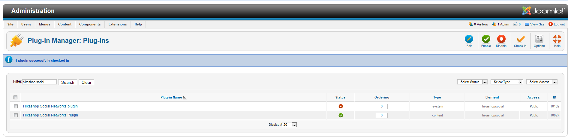

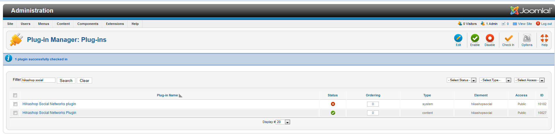

  • Posts: 13
11 years 3 months ago #200354
I did what you written but no luck, I noticed in the plugin there are 2 hikashop social network plug, I enabled the system but nothing happens, I disable the content plugin and the social network goes away. I have attached an image so you can see.
thank you
11 years 3 months ago #200360
Please disable the content plugin, and enable the system one with the indicated code changes.
