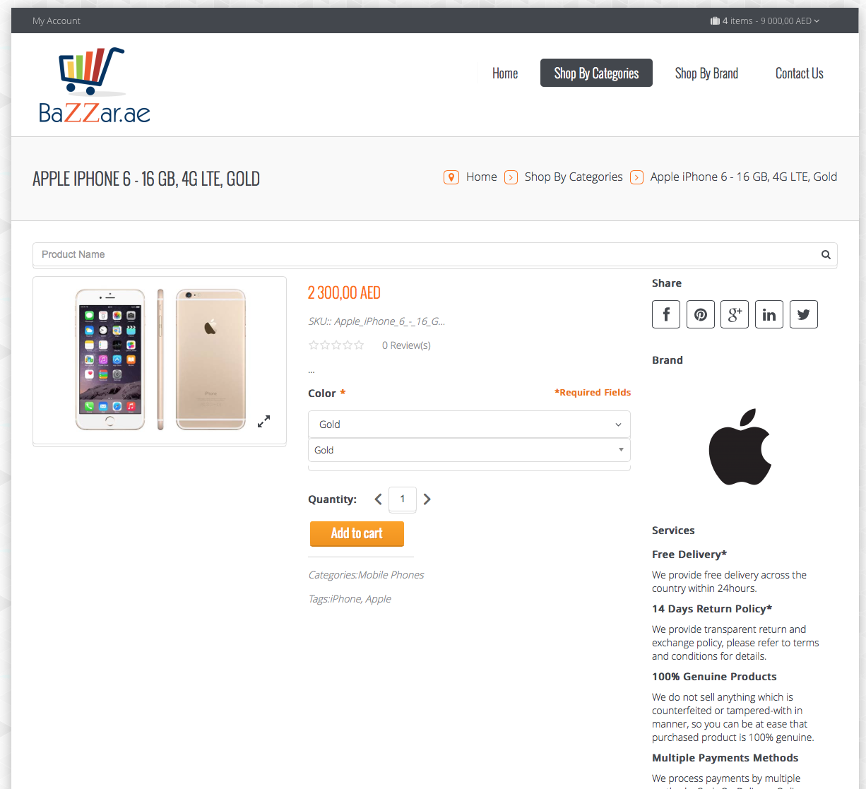

Hello!
How can i change the size of the photo in the product page?
I attached a screenshot!
Regards, :)

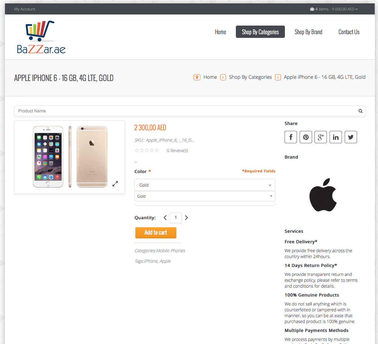

  • Posts: 125
11 years 2 months ago #201844
hello
1). I would like to change the size of the photo in the product description page. Ive tried everything it doesn't change. ( i Attached a screenshot for reference)
2). The variants ( charesterics) drop down is duplicated for some reason it shows 2 drop downs instead of one. ( I attached a screenshot)
11 years 2 months ago #201855
1.
Ok, so in that case using the "Product page image width/height" options should do the job, if not, your Template CSS file is probably forcing your product image size, so the solution can be to redefine your Product image by using some CSS code : www.hikashop.com/support/documentation/1...the-display.html#css
2.
That issue is probably cause by the way you configured your product, can you show me some screenshots of how you configured your product page, especially the "Characteristics" tab ?
Thanks.

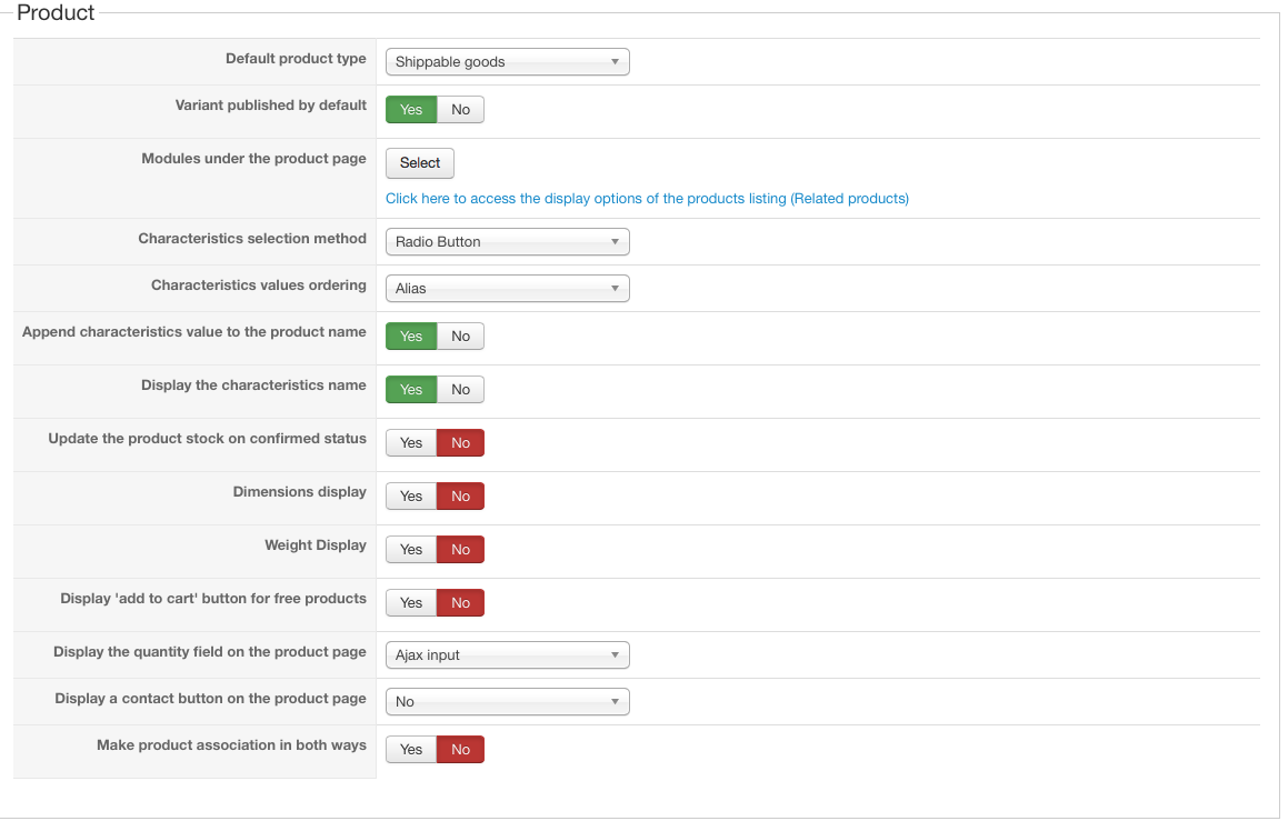

  • Posts: 86045
  • Thank you received: 14176
11 years 2 months ago #201938
There are no screenshots in your last message. Could you try again?

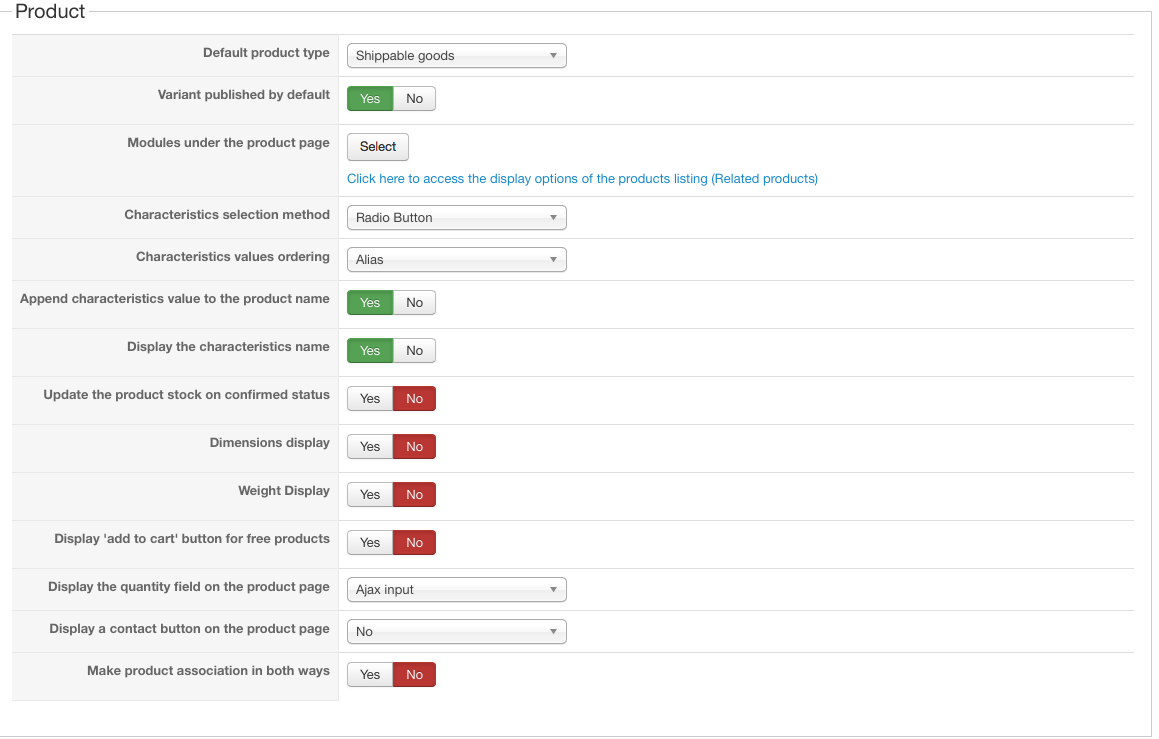

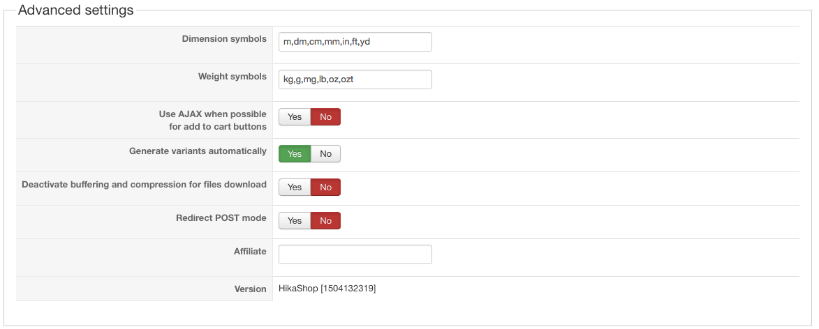

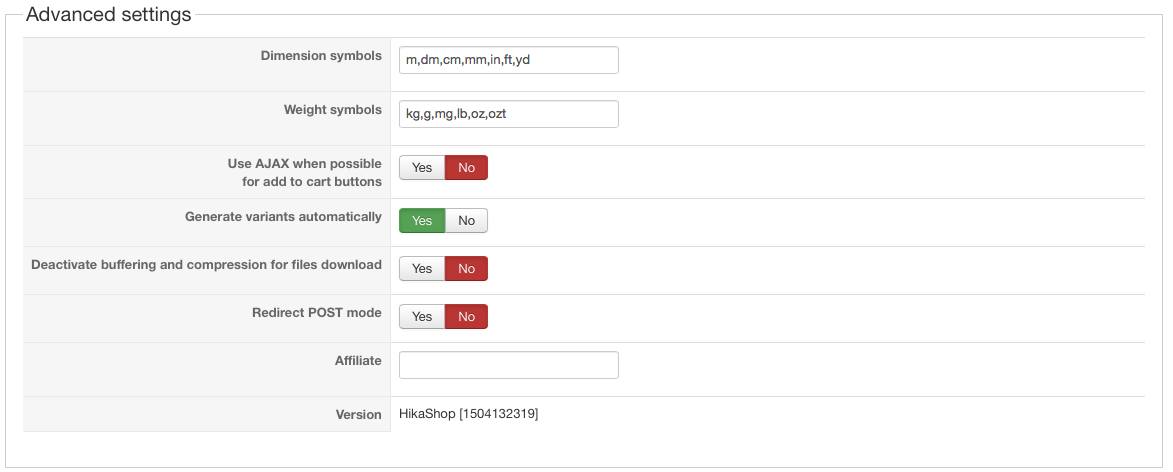

  • Posts: 125
11 years 2 months ago #201963
Yes here they are
regards,
  • Posts: 86045
11 years 2 months ago #201983
In my penultimate message, I was talking about the product settings not the settings of the HikaShop configuration.
Could you also provide a link to that product page ?

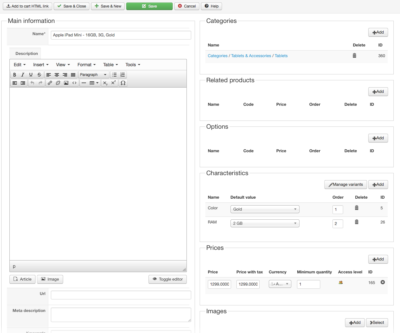

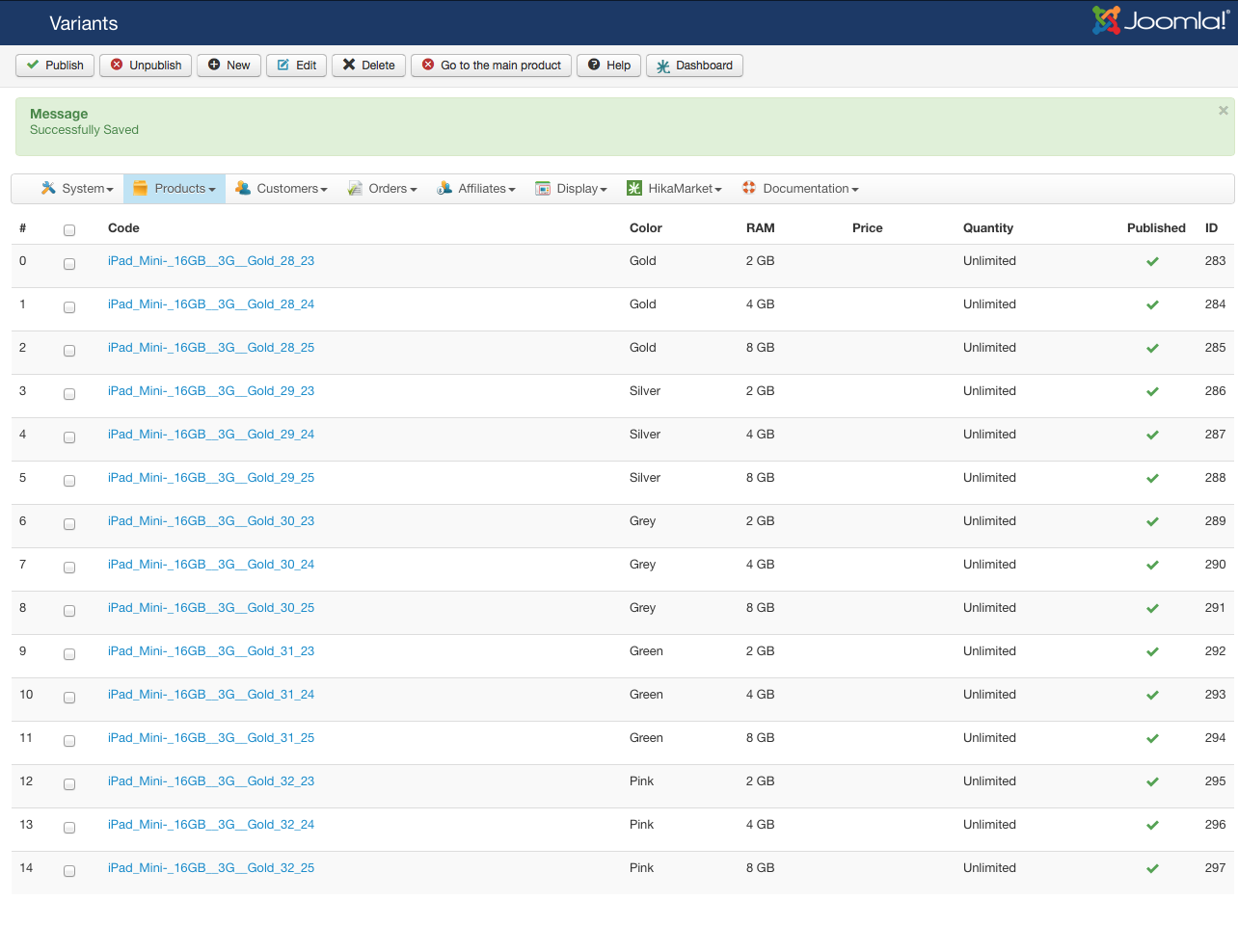

  • Posts: 26381
11 years 2 months ago #202005
Nicolas asked you how you have configured the product ; he want details about your product.
Because seeing the result in the front-end is not useful if we can't know how the product is configured in the backend.

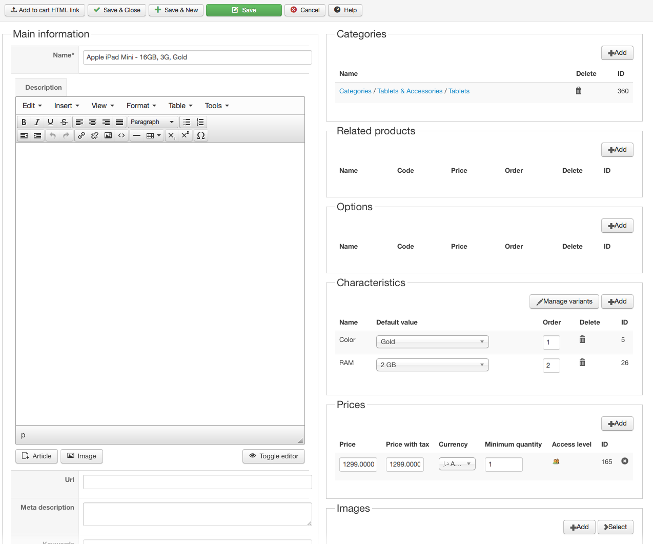

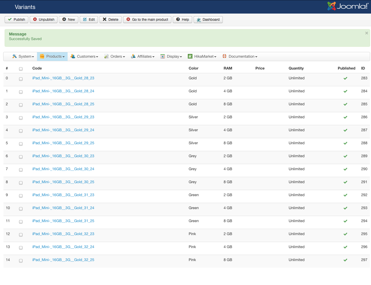

  • Posts: 125
11 years 2 months ago #202286
Ive attached the configuration
11 years 2 months ago #202299
It seems to be a JavaScript / CSS issue. The dropdown is a HTML "select" tag, but thanks to bootstrap this is transformed into a HTML "ul - li", so the select should be hidden and only the ul - li displayed.
Please check thanks to your browser console if there is no Javascript errors, and check in the html if an element shouldn't be hidden.
A link to your website could help us to find the reason of that issue.

11 years 2 months ago #202702
The issue apparently comes from a conflict between the Joomla chosen library and something called "selectify" on your website (maybe from your template ?).
Try to turn off the "Use Chosen library" setting of the HikaShop configuration, as it is by default.

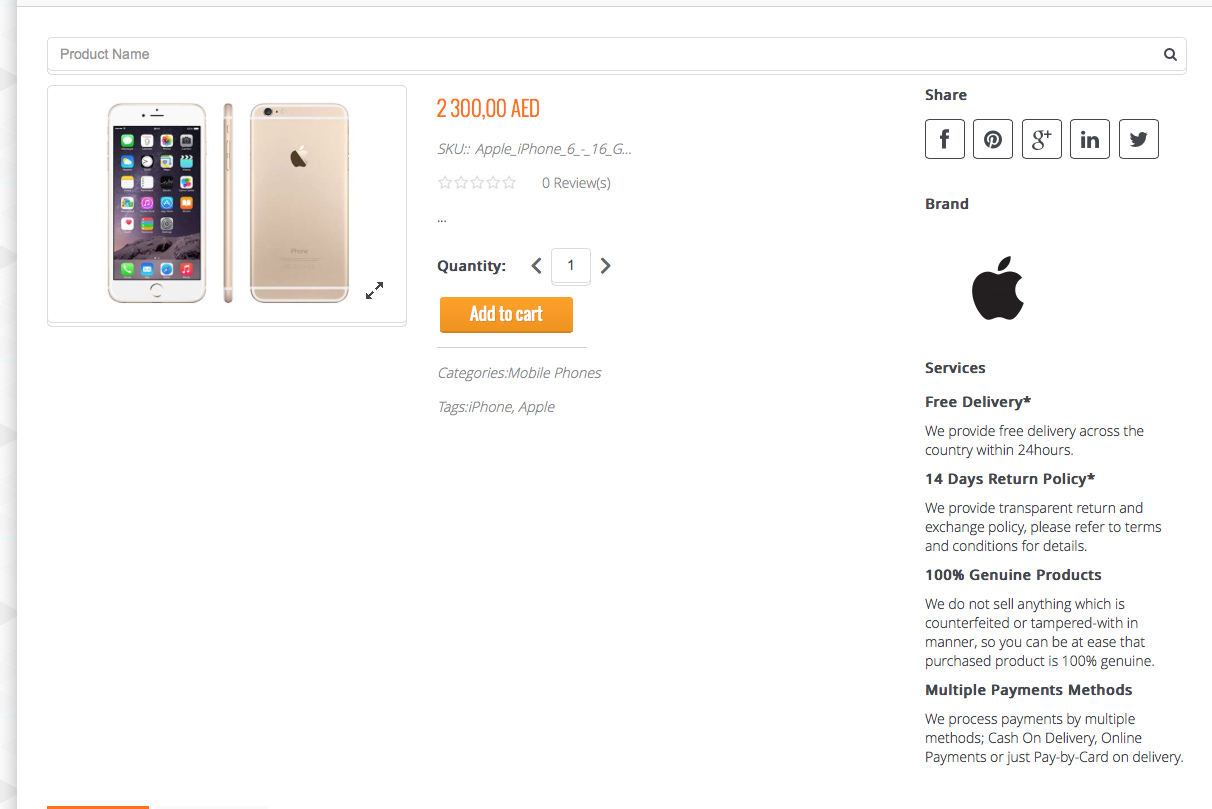

  • Posts: 125
11 years 2 months ago #202780
hello
haha i turned of the "use chosen library" the problem is solved but now the image of the product isn't showing due to the library being off.

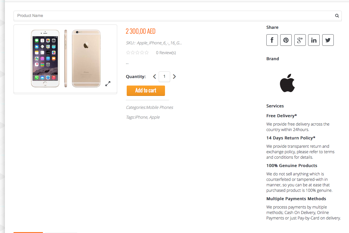

  • Posts: 125
11 years 2 months ago #202872
Soryy about that, you can access the site back i activated the account.
I have tried switching the library off but when i do that, the product pictures don't show anymore as you can see now on the site.
  • Posts: 26381
11 years 2 months ago #202875
The issue is link to your template or some plugin you have installed.
When you have such kind of issue, please open the "console" of your browser, you will see errors and more precisely, javascript errors
js-395b0.js:8 - Uncaught ReferenceError: jQuery is not defined
js-efe24.js:6 - Uncaught ReferenceError: jQuery is not defined
279-hublot-classic-fusion-carbon-gold-rubber-strap:219 - Uncaught ReferenceError: jQuery is not defined
279-hublot-classic-fusion-carbon-gold-rubber-strap:698 - Uncaught ReferenceError: $JVAS is not defined
As you can see, jquery is not include anymore in your website.
And it's not something related to HikaShop or his configuration because we have our own jquery library and for the four errors you can see in the console, none are in HikaShop.
But the fact that there is javascript error stop the rest of the javascript processing and could affect things ; like the gallery which is provided by your template.
The product page you're currently using is not the default HikaShop product page, it's something which has been override by your template ; so the best will be to contact your template provider.
Here the code that we could find in a product page :
<div class="col-sm-6 col-md-4">
    		<div id="hikashop_product_image_main" class="hikashop_global_image_div shop-content-item" style="">
	<div class=" shop-slider-container">
				<ul id="hikashop_main_image_div" class="hikashop_main_image_div gallery product-slider owl-carousel" data-thumb=".product-slider-pager-">
		<li class="item" rel="zoom"><img id="hikashop_main_image" title="" alt="" src="/images/com_hikashop/upload/hublot-501-pm-1680-rx.jpg"><a class="zoom-item" rel="prettyPhoto[pp_gal]" href="/images/com_hikashop/upload/hublot-501-pm-1680-rx.jpg" title=""></a></li>		</ul>
		<!-- End slide -->
		<div class="bottom-border"></div>
		<div id="hikashop_small_image_div" class="shop-slider-pager owl-carousel product-slider-pager-">
					</div>
		<!-- End Thumb -->
	</div>
</div>
The image is right there but due to the template modification, the image is hidden, the "shop-slider-container" is 0px height so it is not visible.
And we do not have any "shop-slider-container" in HikaShop. So I won't be able to help you for that.
