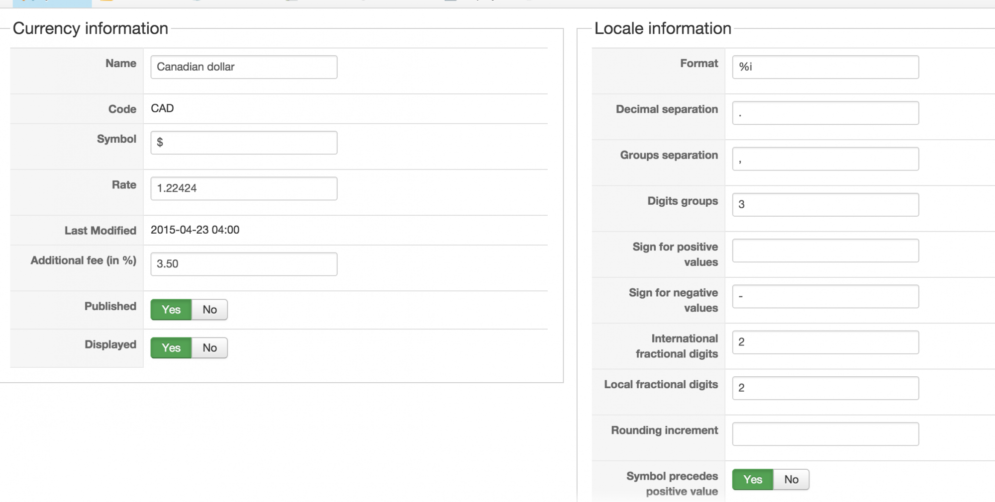

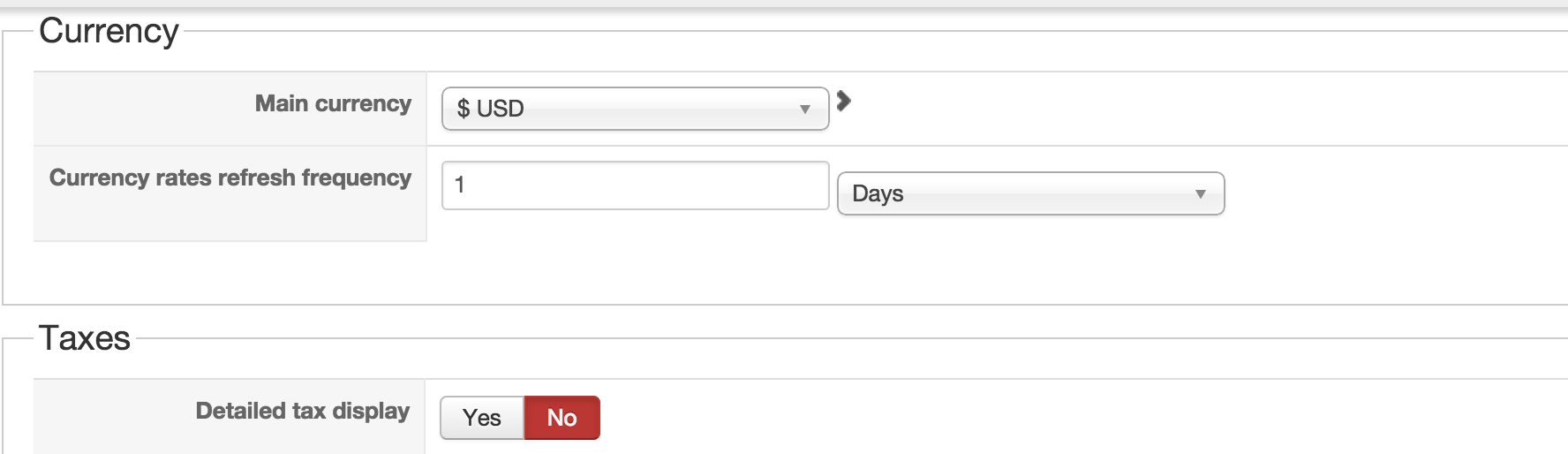

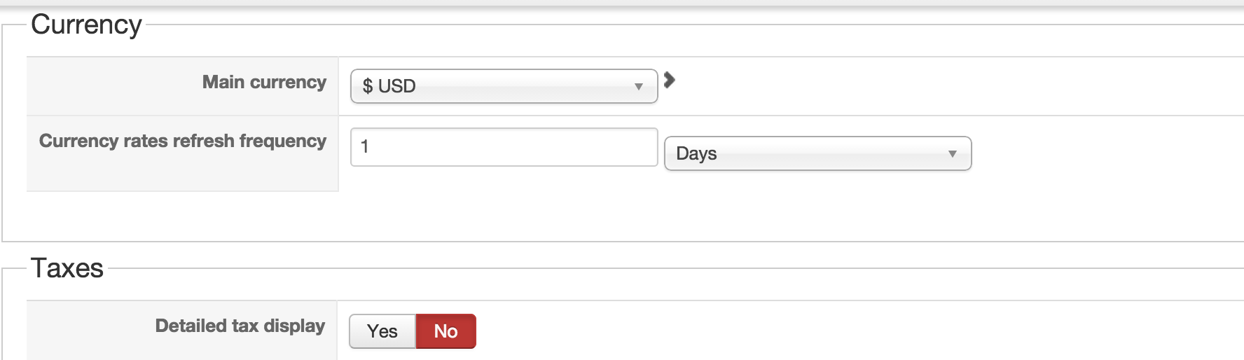

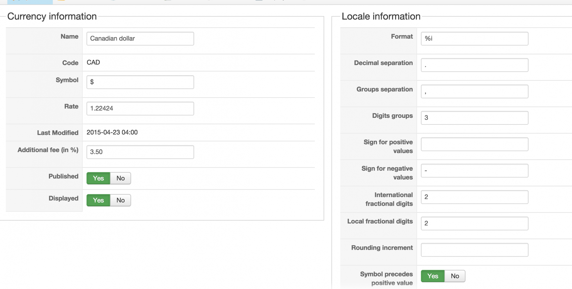

We have multiple currencies activated but they are not updating.
Is there something I need to change in our settings?
It created a bit of a issue for a number of our events.
I have added a screenshot of our settings and you will see the last update was 4/23.
You will also see that I have asked the currencies to refresh every 1 day.

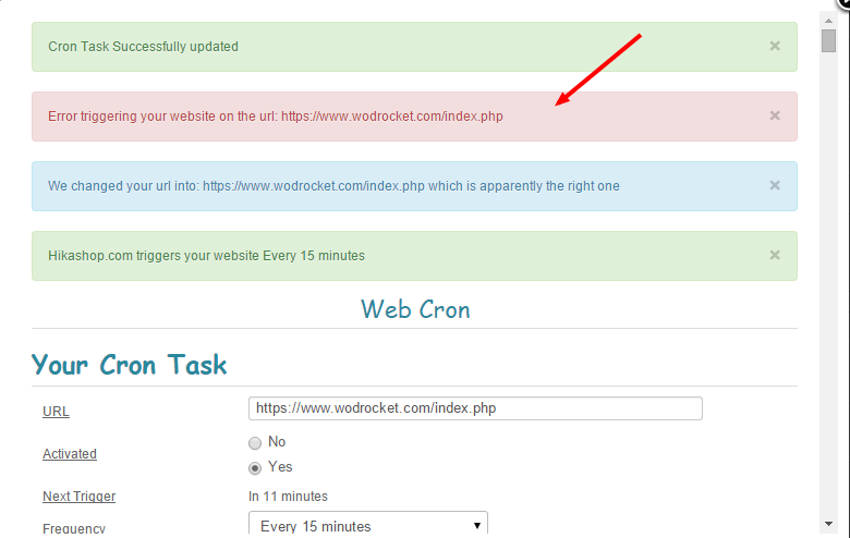

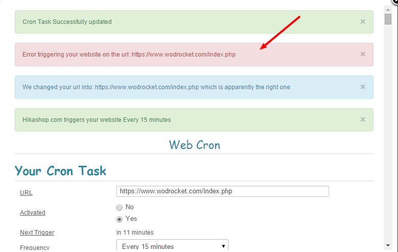

I am sorry, I have done what you suggest in the link, but it did not work, I get this error:
  • Posts: 85788
  • Thank you received: 14079
10 years 11 months ago #208121
The issue is that you have changed the cron task URL from
Part of the message is hidden for the guests. Please log in or register to see it.
to
And thus our server is triggering your home page instead of your cron processing page.
So the cron task was not working. I've changed that for you. It should work better now.
