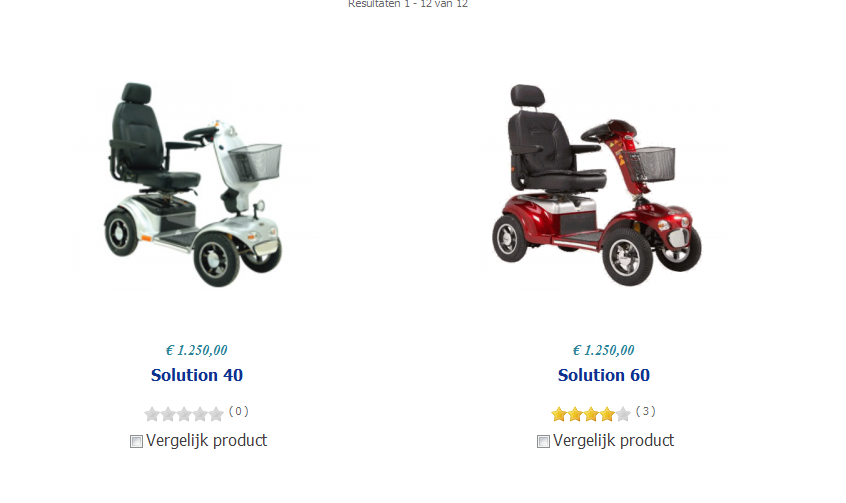

want a button on the product listing view page.
  • Posts: 424
  • Thank you received: 11
10 years 11 months ago #214123
-- HikaShop version -- : 2.5.x
-- Joomla version -- : 3.3.6
-- PHP version -- : 5.5.x
-- Error-message(debug-mod must be tuned on) -- : no error
We have created a menu item to show us the various products of a particular category, nicely in blocks. In the attached picture you see 2 standing next each other. We see that the whole is clickable to go to the product but we want a button to let the potential customer to go through the product information. Soo above the compare we need a button. Like "More Info" Or is it possible to adjust the add to wishlist button that it will go to the product itself as when clicked on the whole image?
Hope you understand what i am asking.
Michiel
10 years 11 months ago #214131
Hello Michiel,
To do what you want the solution will be to directly edit the code of the "Quantity" file of the "Product" view of the front-end template via "Hikashop->Display->Views".
Note that to have a button which will redirect you through your product page detail, you can copy the code of the "Choose options" button and replace the name :
echo $this->cart->displayButton(JText::_('CHOOSE_OPTIONS'), 'choose_options', $this->params, hikashop_contentLink('product&task=show&product_id='.$this->row->product_id.'&name='.$this->row->alias.$url_itemid.$this->category_pathway,$this->row),'window.location = \''.str_replace("'","\'",hikashop_contentLink('product&task=show&product_id='.$this->row->product_id.'&name='.$this->row->alias.$url_itemid.$this->category_pathway,$this->row)).'\';return false;', '');
Best regards,
Mohamed.

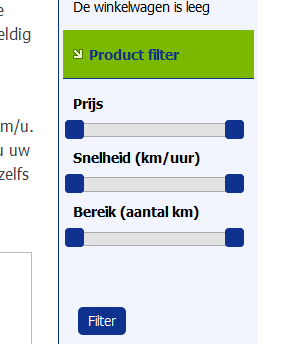

Another thing i came accros is about a module filter in the sidebar of our site. see attached picture. The name of the filter option is within a spanclass and then we get on a new line a :(filteroptions) how can i get the : after the the name off the filter option i can not find it.
Please help
Michiel
10 years 11 months ago #214208
Hello Michiel,
Using some CSS code to lower the font-size or add more space for your filter module will probably do the job : www.hikashop.com/support/documentation/1...the-display.html#css

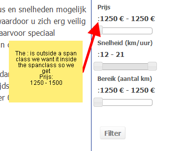

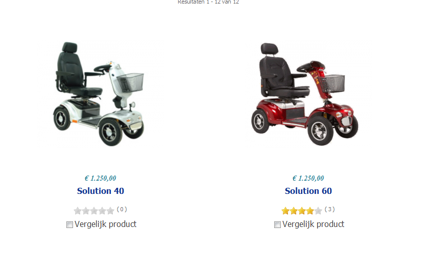

10 years 11 months ago #214388
Have tried to adjust the css, but that does not do the trick.
In the img i send u i need the : before the 1250 inside of the <span class of the price> in the css i can not do this.? And in the views product_filter i cannot find the : after any span class.
so where does the : comes from?
Another question is why is the currency in the filter not before the price as said in the configuration? or where can i adjust that also..
Thanks.
  • Posts: 86106
  • Thank you received: 14206
10 years 11 months ago #214518
The exact CSS to use depends on how everything is configured and the CSS of your template.
So we can't give you precise help without analyzing the page on your website. Could you give a link to the page ?
The HTML of the filters comes from the file administrator/components/com_hikashop/classes/filter.php
The currency settings are not used for the display of the cursor filter as the normal function to generate prices is a PHP function but the filter prices are calculated dynamically in javascript. Some CSS might allow you to revert their position with the CSS "direction" attribute.

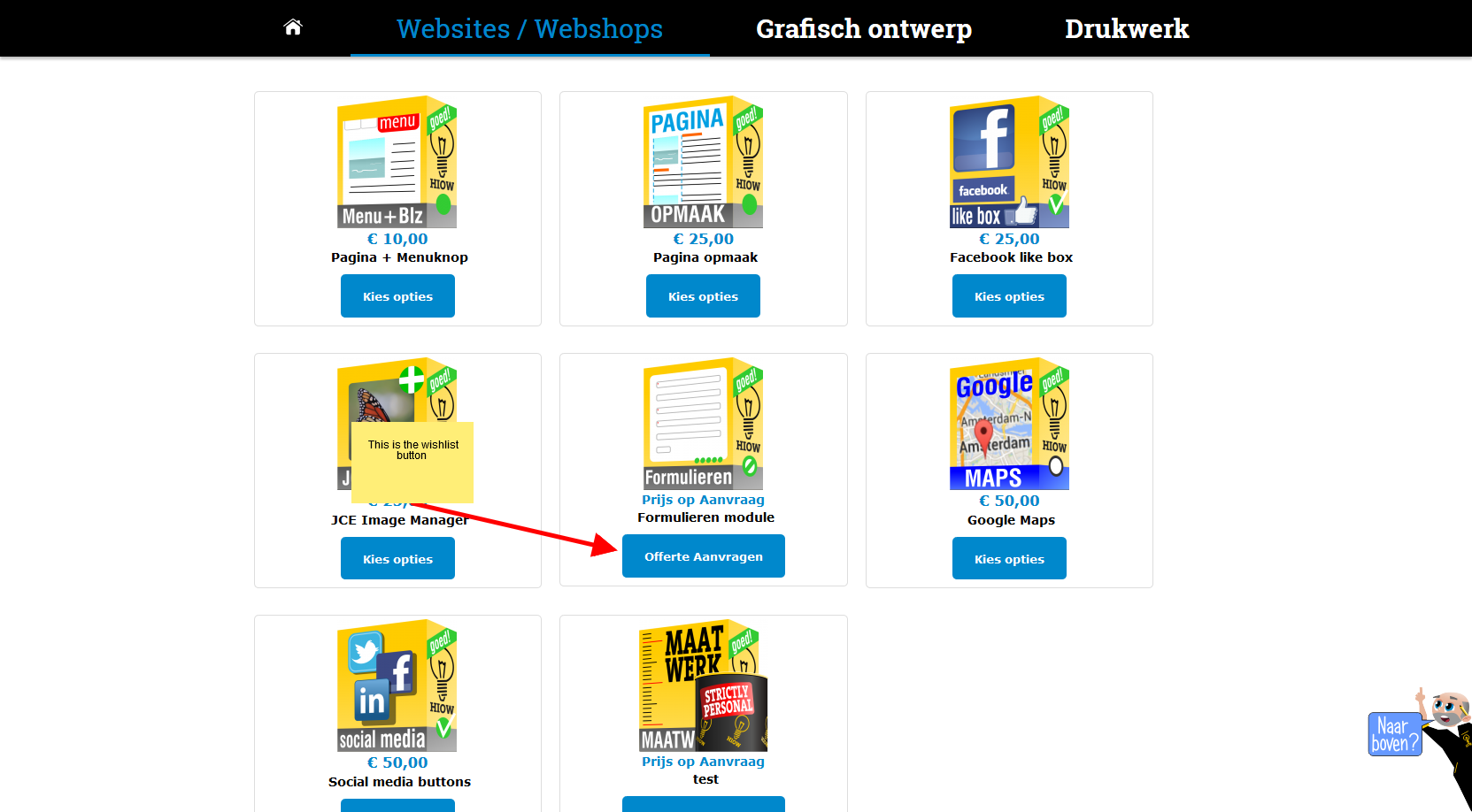

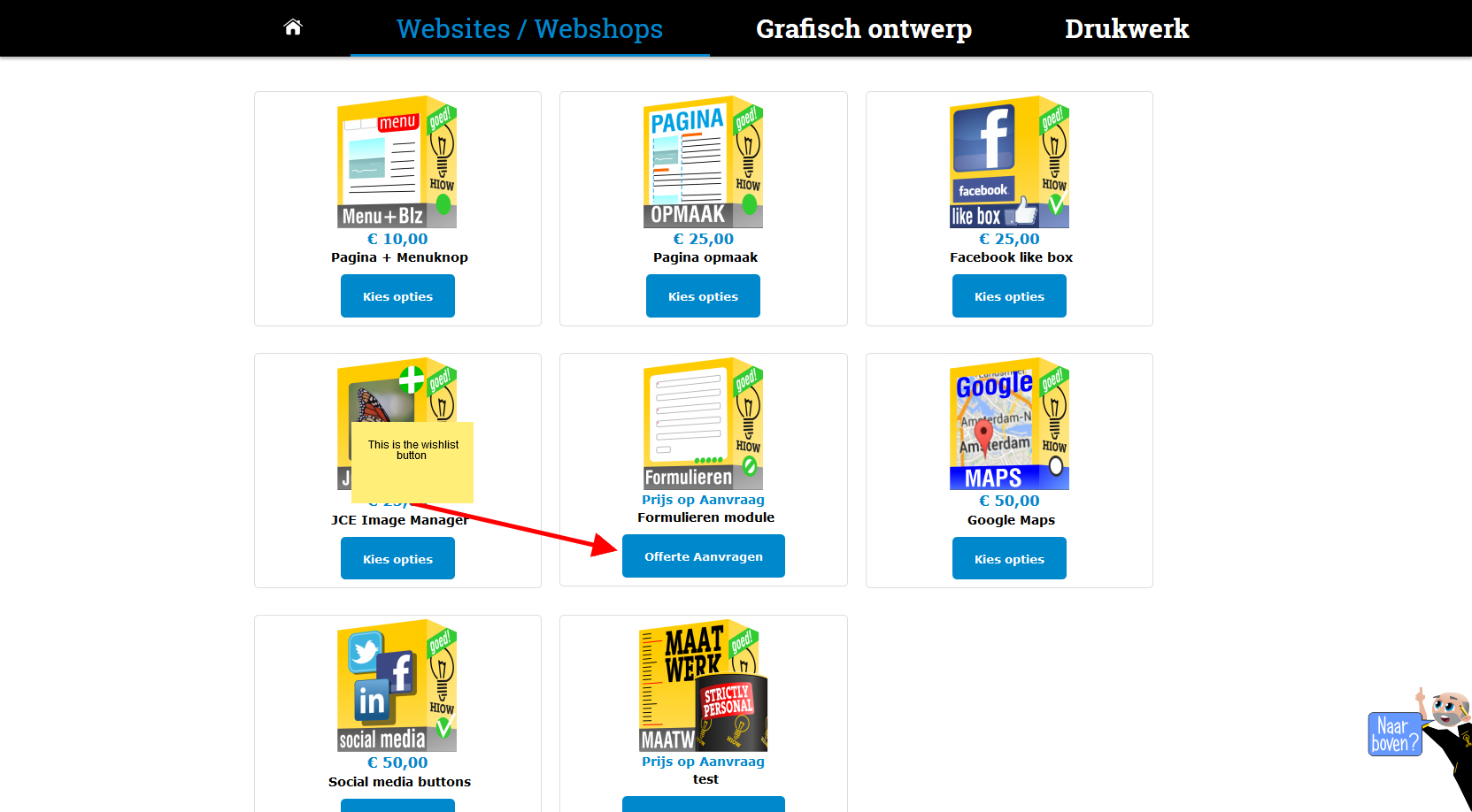

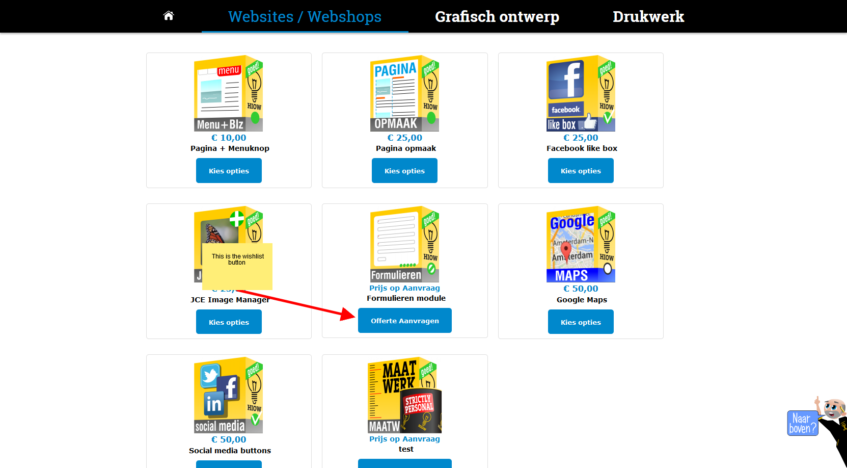

10 years 10 months ago #219985
We like to have a variant of this. Let me explain. We don't use the wishlist in our shop, but we want to use the button option build in. So how can we make the wishlist button to link to another page in our website. I know i need to modify it from the quantity php in the product view..
10 years 10 months ago #219995
The best would be to disable the wishlists and add a custom button in the "product / quantity" view directly.
Something like:
<a class="hikashop_cart_button" href="/your_link"><?php JText::_('ADD_TO_WISHLIST'); ?></a>
and of course replace "/your_link" by the desired url.
  • Posts: 424
10 years 10 months ago #220103
Hello Xavier,
That would be a nice solution, but when we do that it will appear on every product, we only want it on some products, so if we set the system that only the free products can be added by the customer to the wishlist to let that button appear, so is there a way to make the wishlist button to link to another page in joolma?
Now it is going to the shopping cart, we want it to another page.
Hope you understand, what i mean.
Thanks.
10 years 9 months ago #220108
So in the view "product / quantity" you can replace the four occurrences of:
				echo '<div id="hikashop_add_wishlist">' .
					$this->cart->displayButton(JText::_('ADD_TO_WISHLIST'), $btnType, $this->params, $url, $wishlistAjax, '', $max, $min, '', false) .
					'</div>';
By:
That way this button will be displayed based on the wishlist button settings and will redirect to the desired page.
In my example it will redirect to the "/your_link" page.

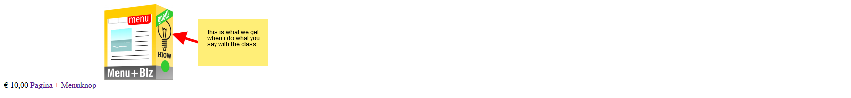

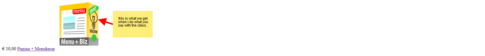

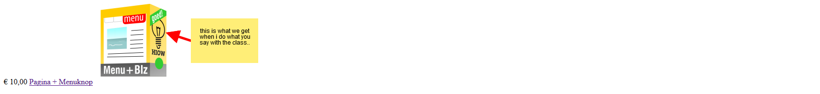

10 years 9 months ago #220247
When i do what you say to get the button working the way we want. We get the following. I have attached two images, 1 how the site looks like with the button, and one what happens if i implement your code. I can not figure it out. hope you can give me some more help. thanks.
  • Posts: 86106
10 years 9 months ago #220410
Replace that code to this instead:
echo '<a class="hikashop_cart_button" href="/your_link">'.JText::_('ADD_TO_WISHLIST').'</a>';
The following user(s) said Thank You: BluepointWebdesign
  • Posts: 424
10 years 9 months ago #220456
Thanks this is working! :cheer:
