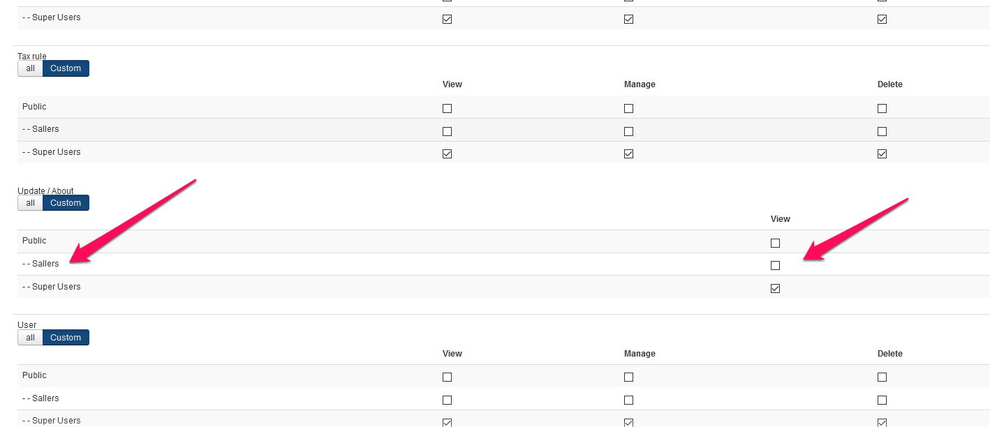

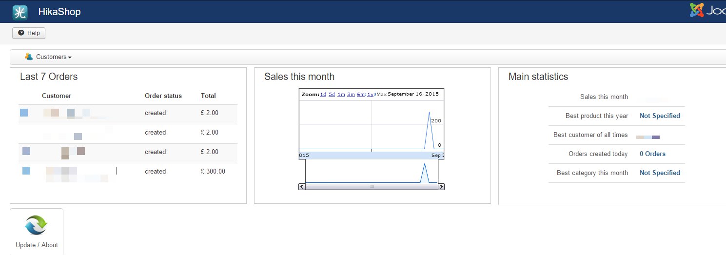

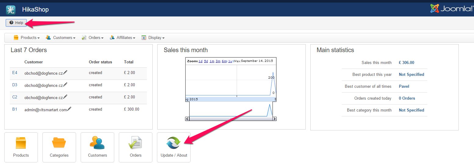

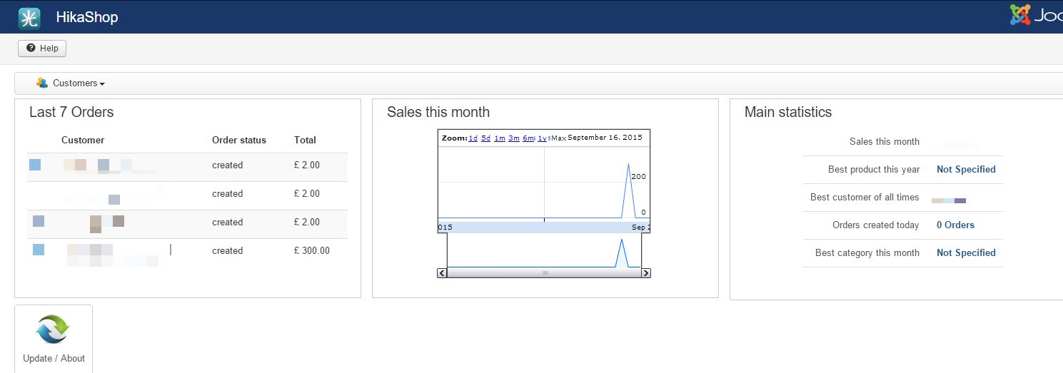

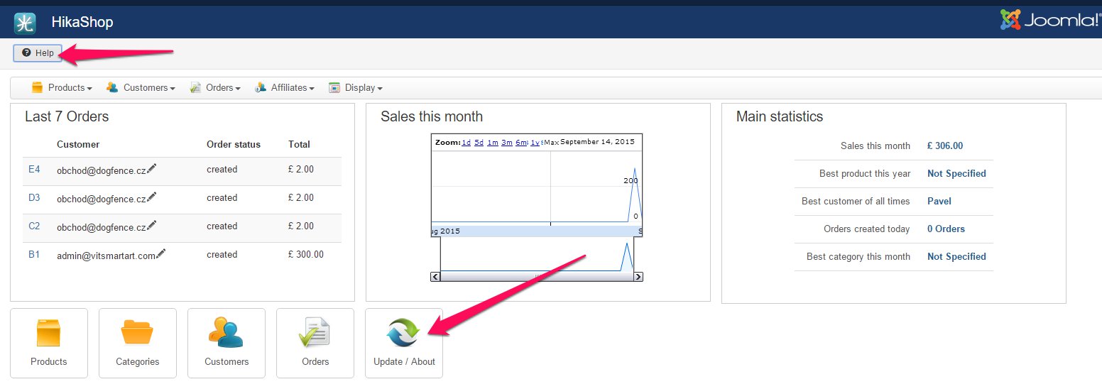

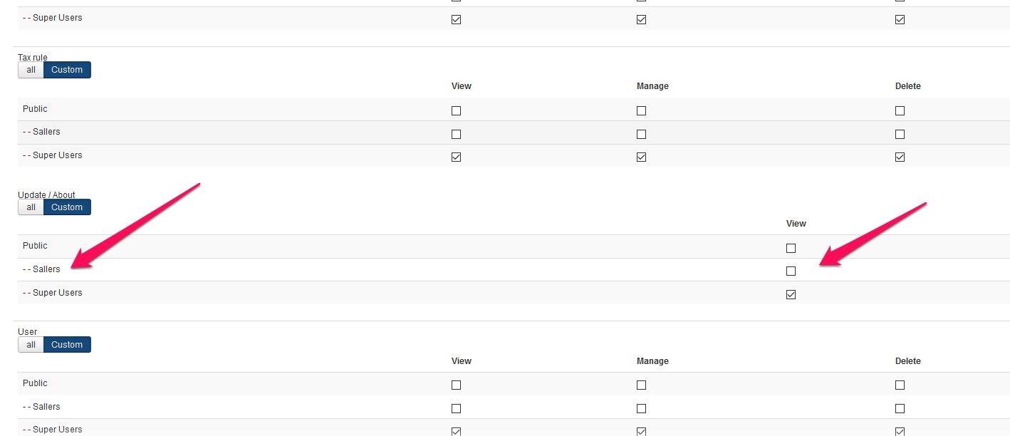

I know, I found this setting (see. image) but I when I log in as a user Sellers, I still see the button. I tried to turn off all the buttons in the settings Acces level as the test, but button Upgrade / About still appears. (see image2)
Help button I understand that it is right to let on ;)

10 years 10 months ago #214382
Change the code acl_help_view to acl_update_about_view in the file administrator/components/com_hikashop/views/dashboard/view.html.php and that should fix that.
  • Posts: 30
10 years 10 months ago #214722
Your advice is brilliant. I changed the code and everything works super
