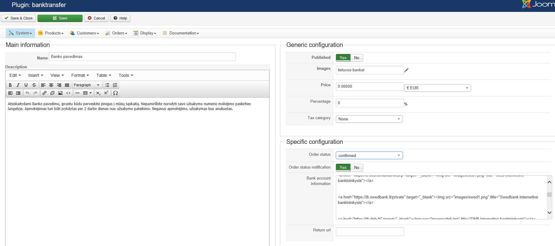

It's the second solution you want.
Edit your bank transfer payment method via the menu System>Payment methods and you'll see that you can use the "Order status" and "Order status notification" settings so that the order status of new orders would be changed automatically to another status and the order status notification email would be sent at that moment.
So then you just have to disable the "order creation notification" email via the menu System>Emails.

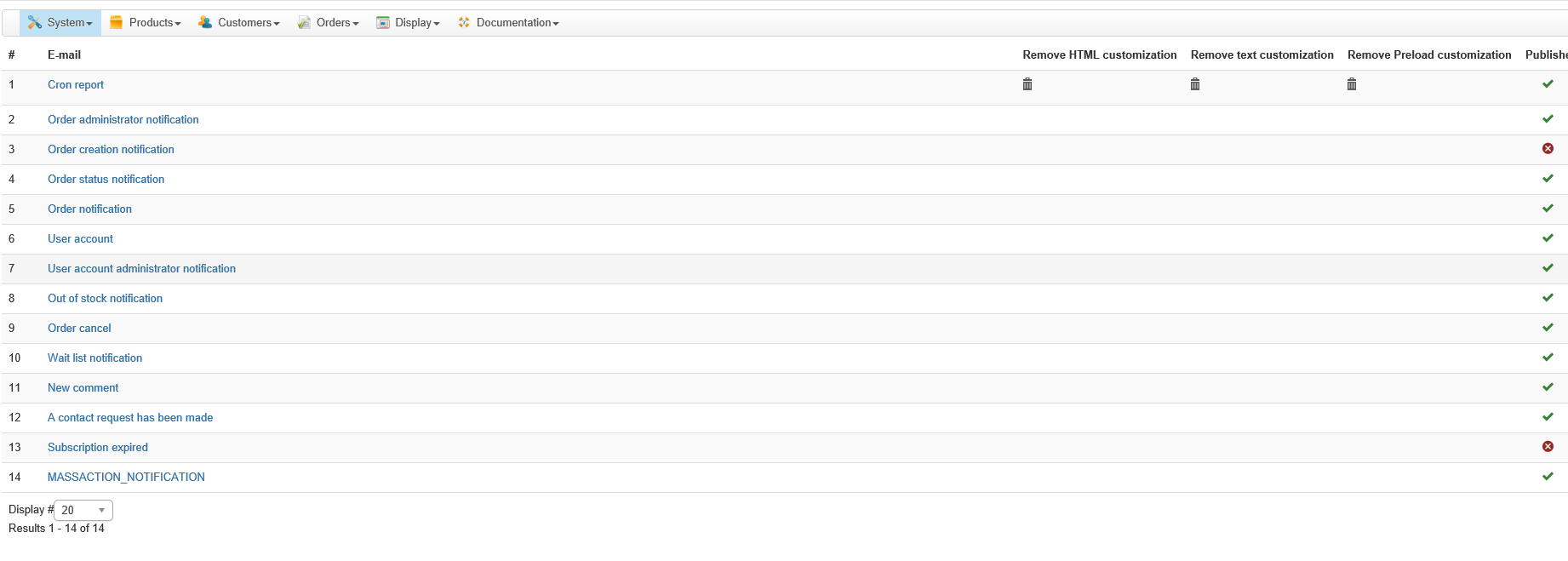

Can you make sure that you didn't disable the "order status notification" email via the menu System>Emails then ?
  • Posts: 1119
  • Thank you received: 114

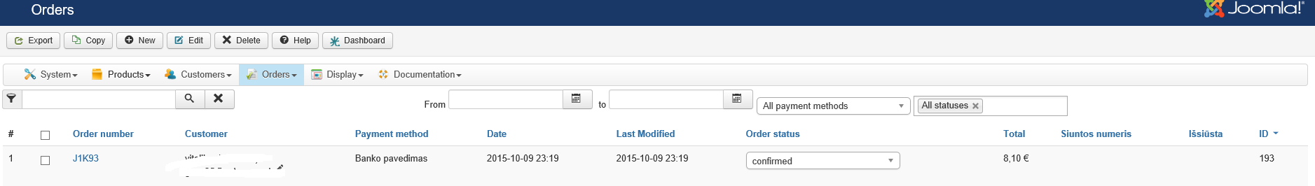

10 years 10 months ago #216865
Well I am sure, and it is not working...
I have uploaded some pictures of my settings.
Tried once again and no luck.
I can give you access so you could try it your self.
