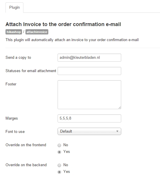

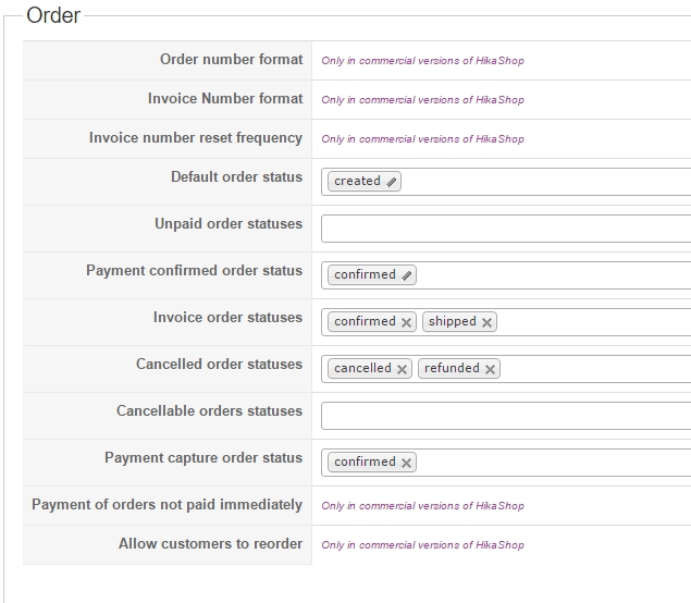

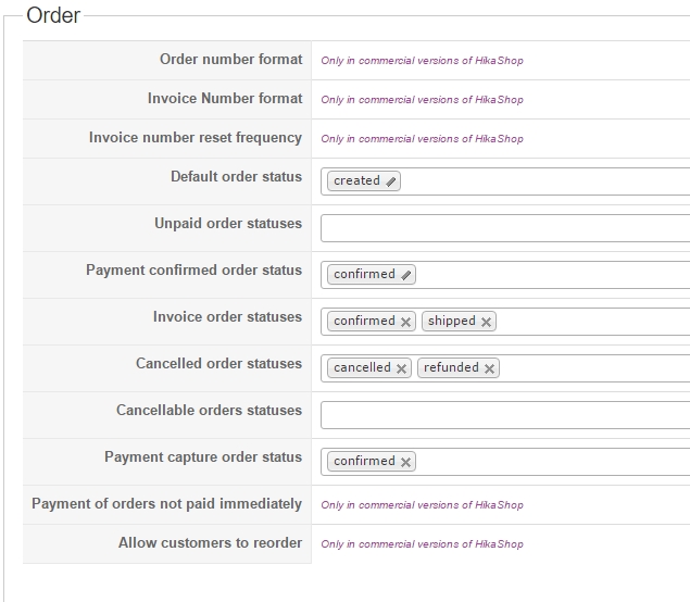

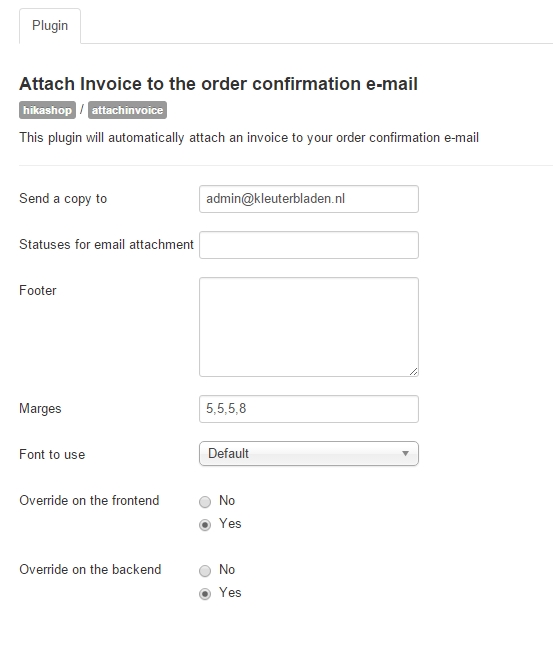

As asked I have attatched some screenshots.

Your settings look fine, so I can only think of the orders not being confirmed, or the plugin not activated or its access being restricted, or something like that.
Please check all that. If you still don't find the problem, please provide a backend access so that we can check your settings and the issue ourselves. www.hikashop.com/support/contact-us.html

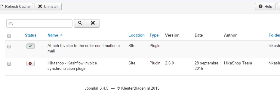

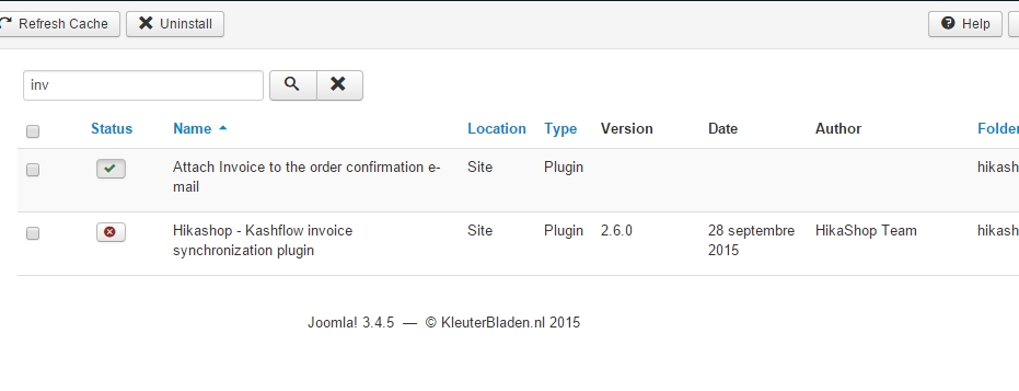

BTW: I noticed something weird in the Extension-list. All extension have dates and authers named, but notthe PDF plugin (see screenshot).
