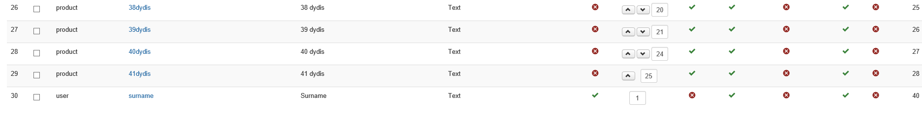

Then I created custom field with column name"surname" in user table (Picture attached) and added this code to user/registration view file:

Everything shows correctly but surname field wont synchronize between joomla user and hikashop user like it does with default field "Name". Also if nothing is entered in that field on hikashop registration, system won't give error message that you need to enter surname first to proceed.
Probably I did something wrong or I miss something.
Any help would be appreciated.
