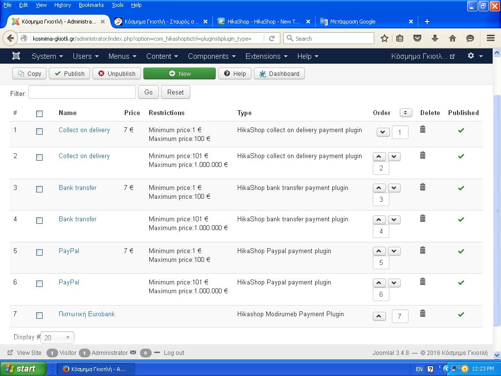

-- url of the page with the problem -- : kosmima-gkiotli.gr
-- Joomla version -- : 3.4.8
-- PHP version -- : 5.4.45
-- Browser(s) name and version -- : 43.0.4
I have made two payment method for each payment plugin ( I give you a image to help you to understand what i had made) the first for price from Minimum price:1 to Maximum price:100 which I have 7euro charge for delivery , and the second from Minimum price:101 to Maximum price:1000000 which have no charge for delivery. I have used the option "Restrictions" to make the filter and it is ok. But I can't make the same for the "credit card" plug in, as it hasn't the options "Minimum price:" and "Maximum price:" Could you help me how could I solve this problem?
Thanks in advances.
  • Posts: 86045
  • Thank you received: 14175
10 years 7 months ago #226221
The Mobirumeb payment plugin is not a payment plugin we developed.
This means that the developer of that payment plugin developed the payment plugin in a way that doesn't give access to the restrictions area.
You can contact the developer of the plugin to see with them if they could add this support (basically, the plugin needs to be based on the example payment plugin that we provide on our developer documentation:
www.hikashop.com/support/support/documen...r-documentation.html
