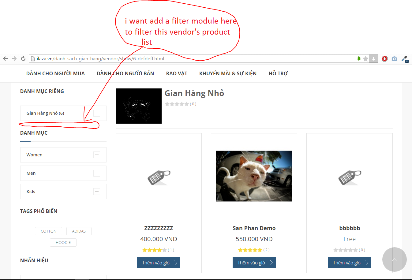

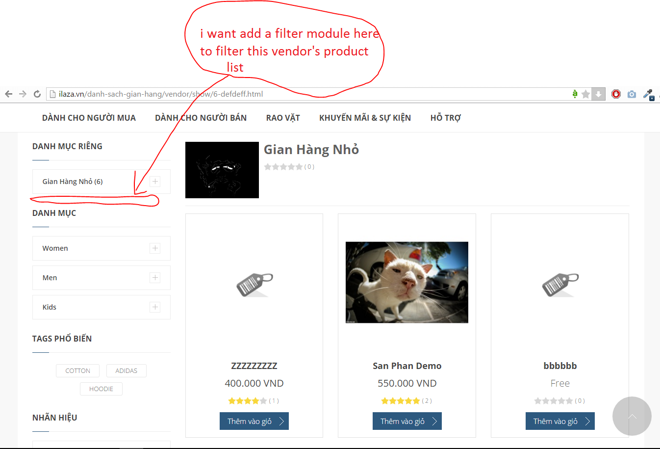

-1 more question:i have a vendor list, when user click into vendor name, it will show up product list, i using vendor page and Modules under the vendor page is a product list( to show product list in vendor page)
how i can add a filter module to vendor page(child page of vendor list page) to apply for product list of this vendor?
