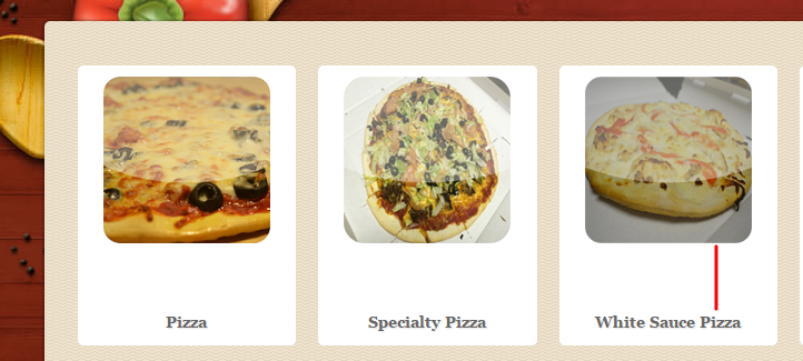

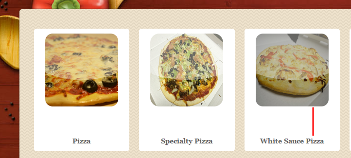

-- Joomla version -- : 3.4.8
-- PHP version -- : 5.5.32
-- Error-message(debug-mod must be tuned on) -- : Hello, there is no error, i'm asking how we can adjustment to the padding
see attachment
see attachment
the distance between the picture and the item name its long! how we can make it shorter ?

You can add such CSS:
div.hikashop_category_image {
height: auto !important;

10 years 5 months ago #232140
where should i add this line?

10 years 5 months ago #232142
In a CSS file on your website. For example:
