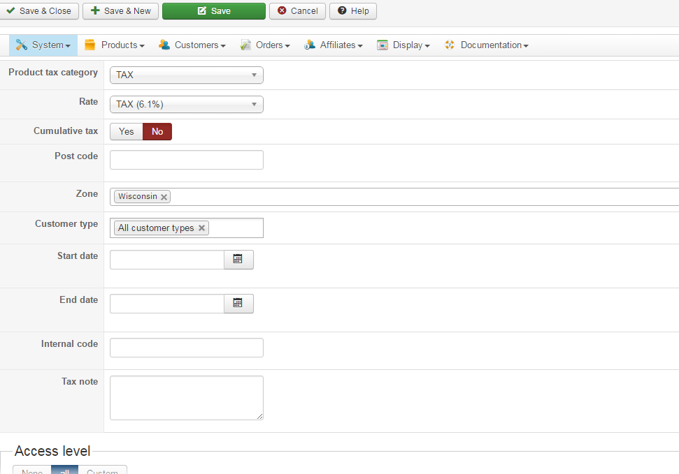

  • Posts: 154
10 years 3 months ago #239623

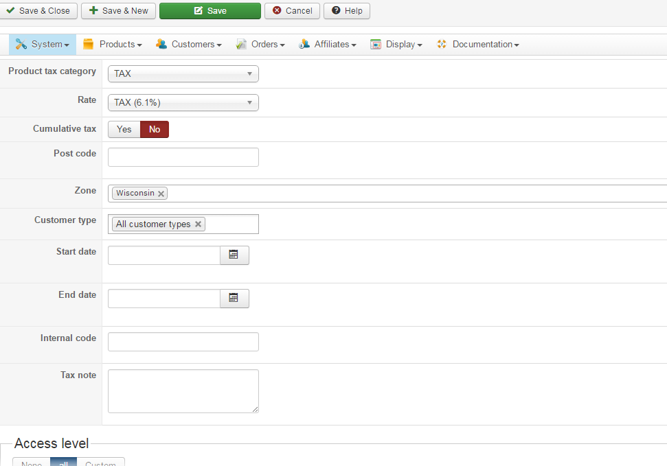

Hello Nick, and thanks for the quick reply,
well i checked that already and here is a screenshot,
do you think there is another scenario, Thanks
  • Posts: 86045
  • Thank you received: 14175
10 years 3 months ago #239701
Try to remove the "all customers type" selected in the "customer type" option and save the tax rule.
If that doesn't help, either your products are not linked to the "TAX" tax category or the wisconsin zone you selected in the tax rule is different from the wisconsin state zone that customers select in their address.

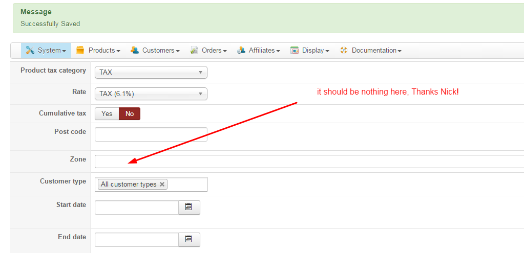

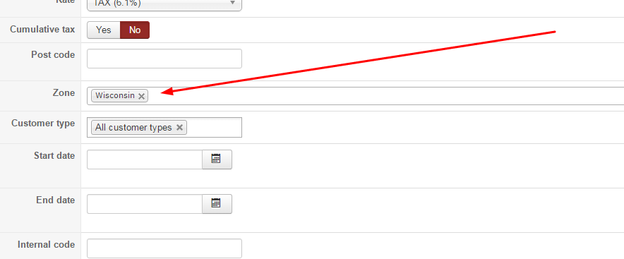

  • Posts: 154
10 years 3 months ago #239708

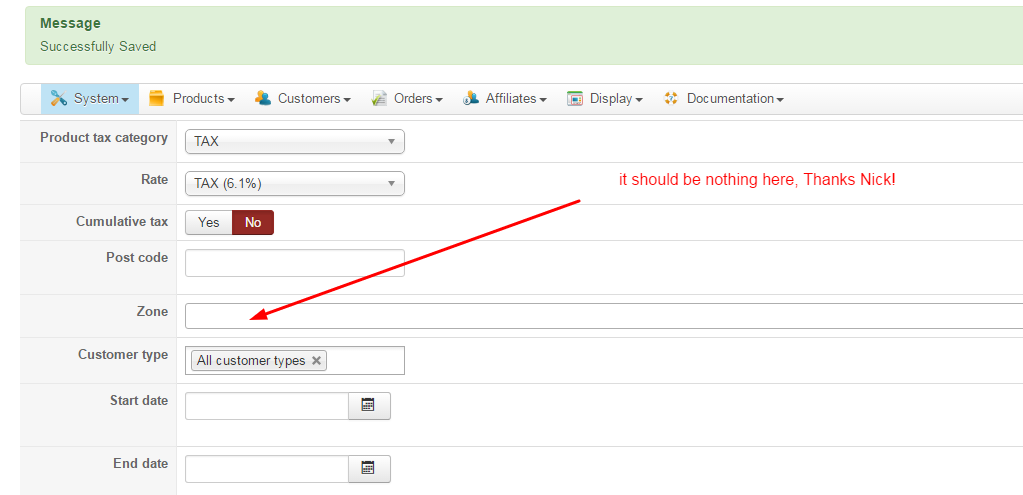

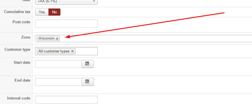

thanks for the help the issue was that i choose Wisconsin as a state that make it restricted , this for other people benefit see attach
the screen shoot shows the mistake the second one the correct
