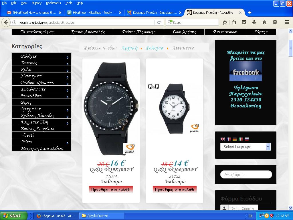

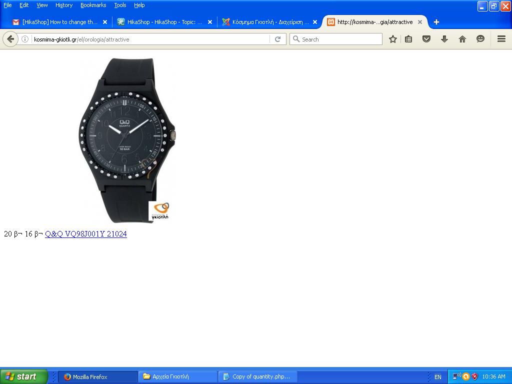

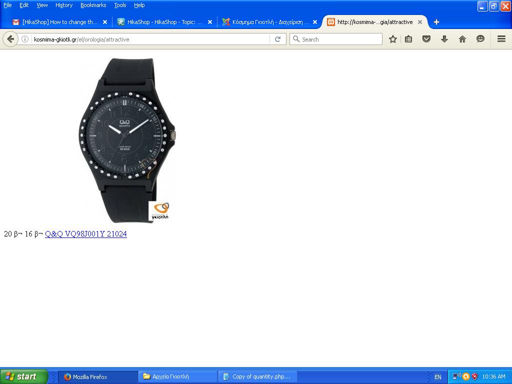

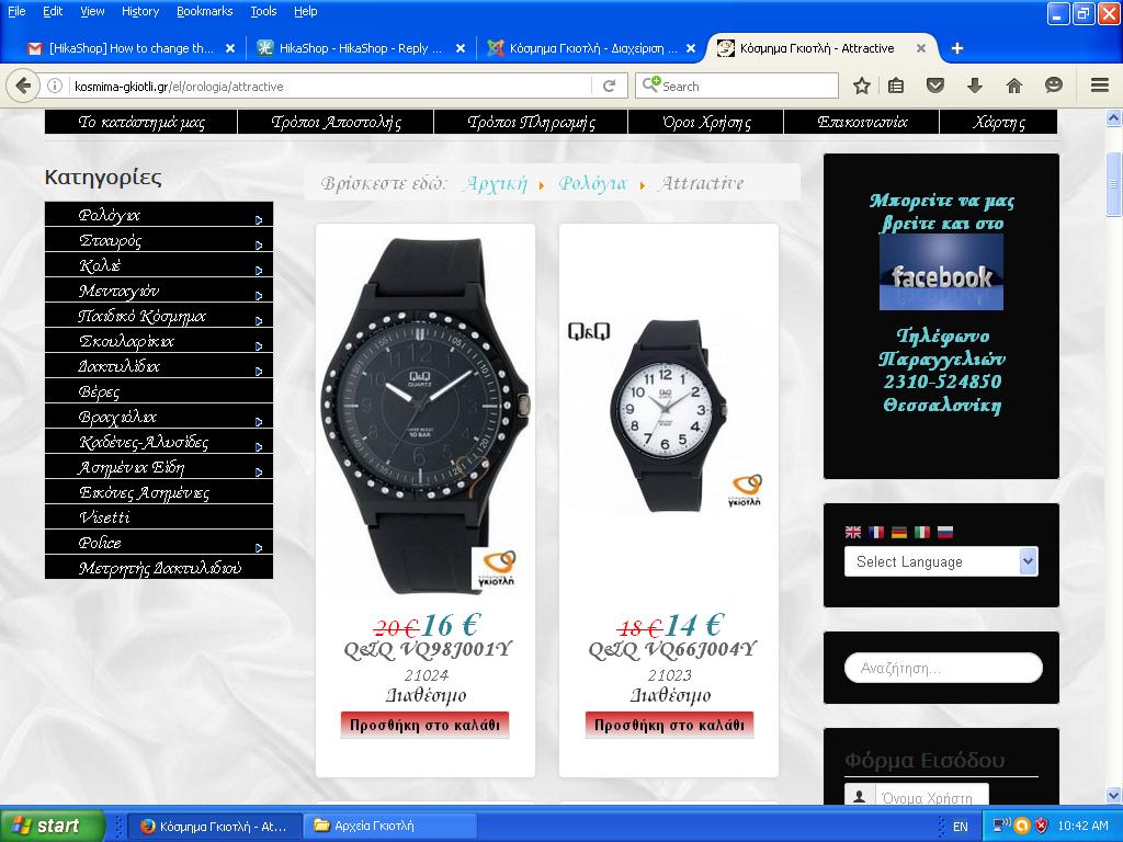

  • Posts: 37
10 years 3 months ago #239895
I try it, but the page is like the photo that I have attached and named "with changed code", you can see the photo named "with normal code" to see the difference. Also I have attached the "normal quantity.php.txt" and the "changed quantity.php.txt" to see the differece, I believe that it will help.
  • Posts: 86042
  • Thank you received: 14175
10 years 3 months ago #239899
Turn on the "error reporting" setting of the Joomla configuration and you'll get the error message with the line number where the problem is.
I would guess that it might be coming from JText.
Try:
$text = 'Παράδοση σε 3 με 5 μέρες';
instead of:
$text = JText::_('Παράδοση σε 3 με 5 μέρες');
(and same for the other quantity)

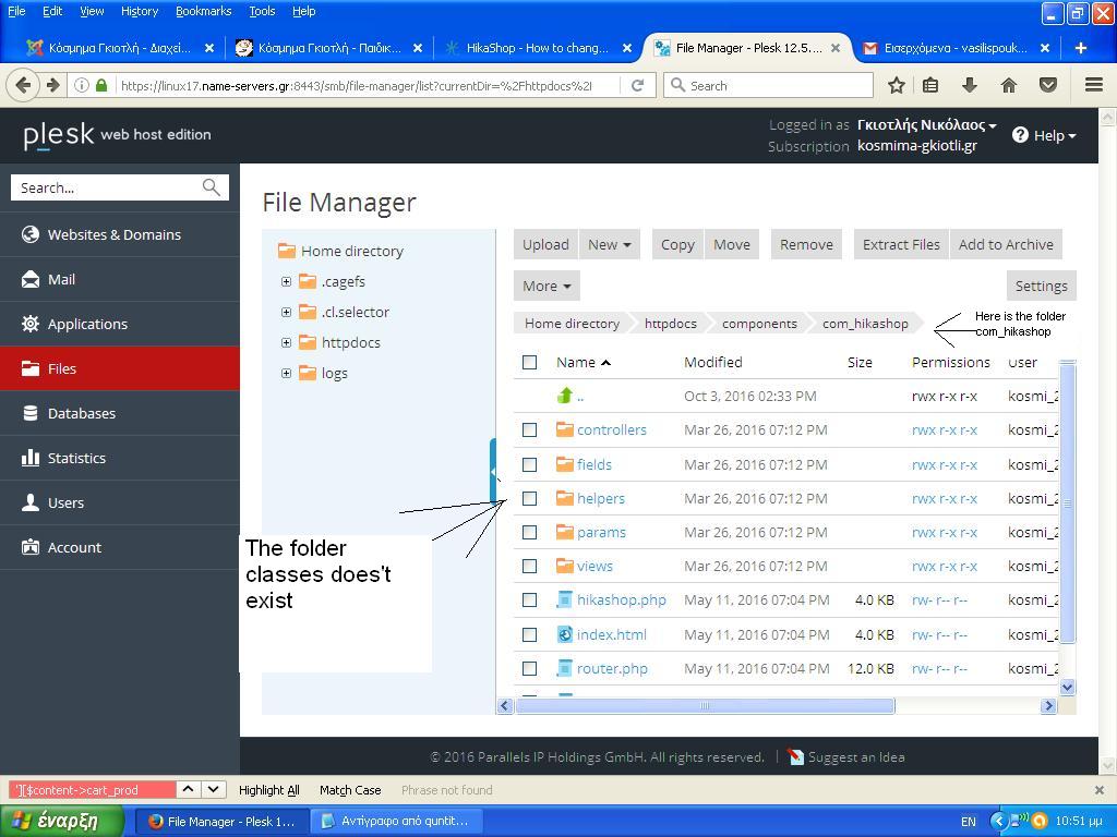

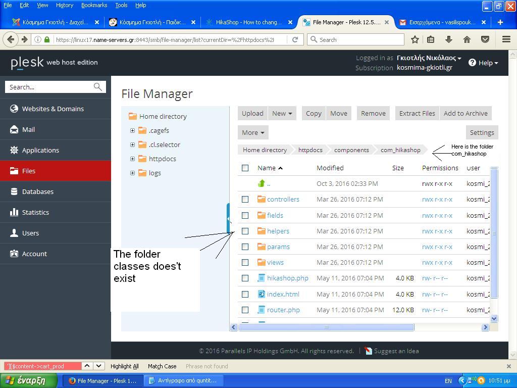

9 years 10 months ago #251697
as you can see on the image that I have attached the folder "classes" does't exist on "administrator/components/com_hikashop", I have found the file "cart.php" on folder "controllers" but there aren't the line
"if($product->product_quantity!=-1 && $product->product_quantity < $product->cart_product_quantity){"
what is wrong?
  • Posts: 86042
9 years 10 months ago #251770
You're looking at components/com_hikashop/ and not administrator/components/com_hikashop/
The following user(s) said Thank You: Poukamisas
