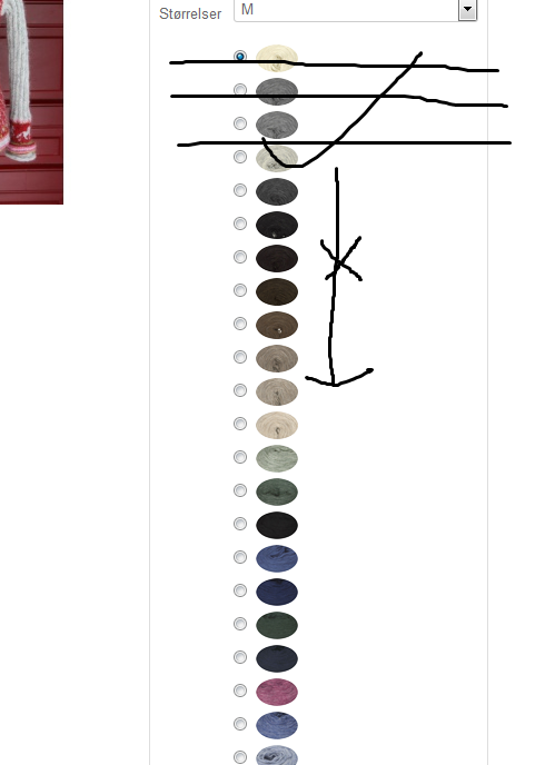

I'm trying to get these colours inline horizontal, but can't get it to work.
It should look likes this.
Attachment not found
Can some1 help me with this? :)

You can use CSS to have it displayed to your liking. Here is a good start to get you going, and telling you how and where to apply custom CSS in HikaShop: www.hikashop.com/support/documentation/1...ize-the-display.html
Across the web are gazillions more tutorials and references for CSS coding.
More can't be said without seeing/inspecting the page, sorry.

Hey and thanks for the fast reply :)
her is a link to the page ^^
My site
My problem is that it is labels and they all have different names. And i need to use this characteristic in other products.
But I'm gonna try something.

First, you are using some "optimizer" (JCH?) on the site, so one can't see where exactly existing CSS etc on your site is coming from, and who knows what else it does. You should consider turning this off during site development.
Then, like so often, there are multiple ways to do this with CSS. Here is one example of code which you could try, it should work in your case and on this page. Just add it in a new line at the very end of a custom CSS file as described under the link I gave you:
@media (min-width: 980px) {
	.hikashop_product_right_part {
	    width: 322px;
.hikashop_product_characteristics label {
    display: inline-block;
    margin-right: 16px;
    float: none !important;

Wow Thank you so much it works perfect :woohoo:
I tried to do something like that for each label id, but it would take a long time.
where did you find ".hikashop_product_characteristics label" and "@media"? i couldn't find something like that when using the inspector.
