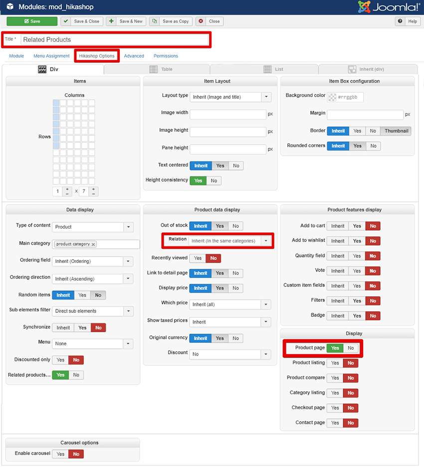

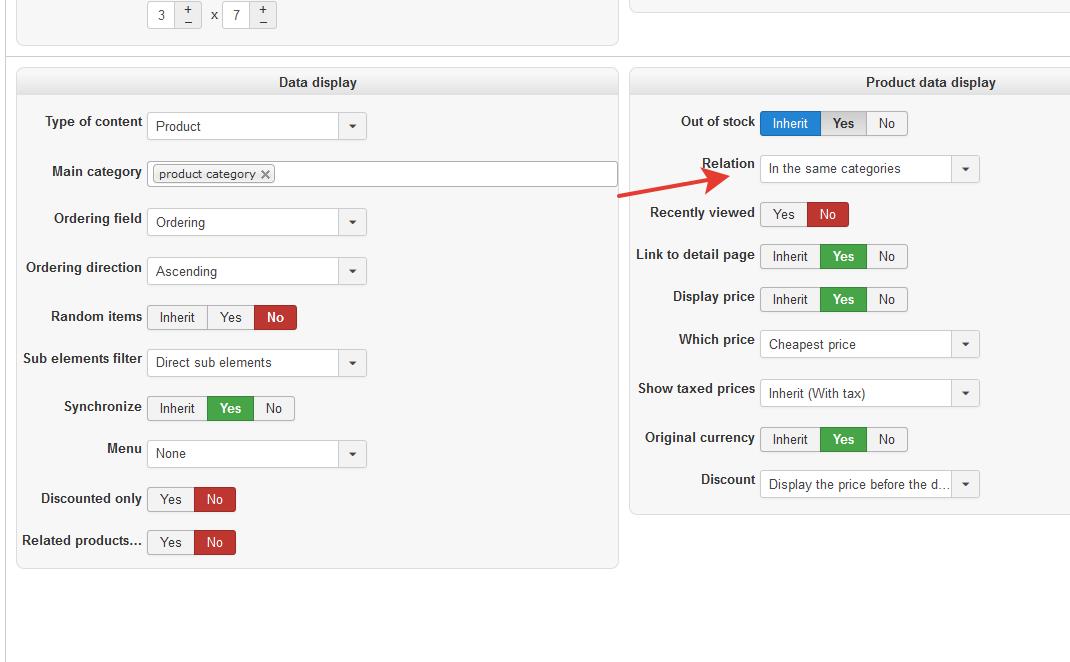

I have tried this settings but there is no luck....

8 years 10 months ago #279114
Make sure that you select "all sub elements" and not "direct sub elements".
Otherwise, you're asking the system to display all the products in the same category AND directly linked to the "product category" category.

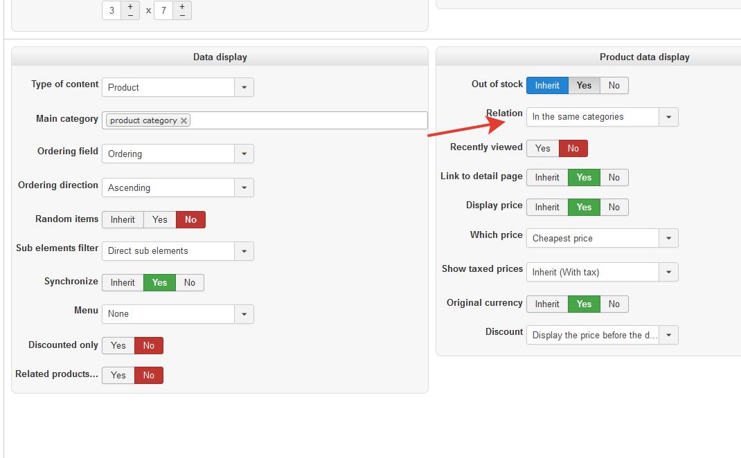

The "relation" setting is to configure what relation you want between the products of the module and the product on the product page.
It's used for the related products module for example. With it, you can display the products in the same category than the current product on the product page.
If you're talking about the products listing, that setting is ignored.
So I'm not sure what you want to do ? On which page are you displaying that module ?

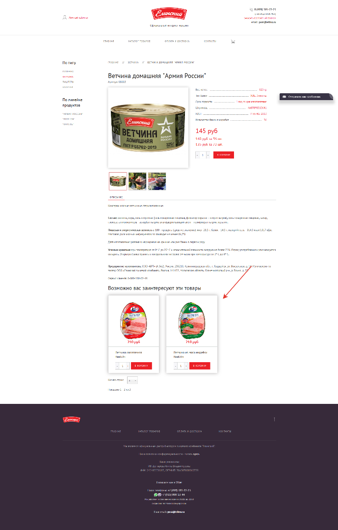

8 years 10 months ago #279200

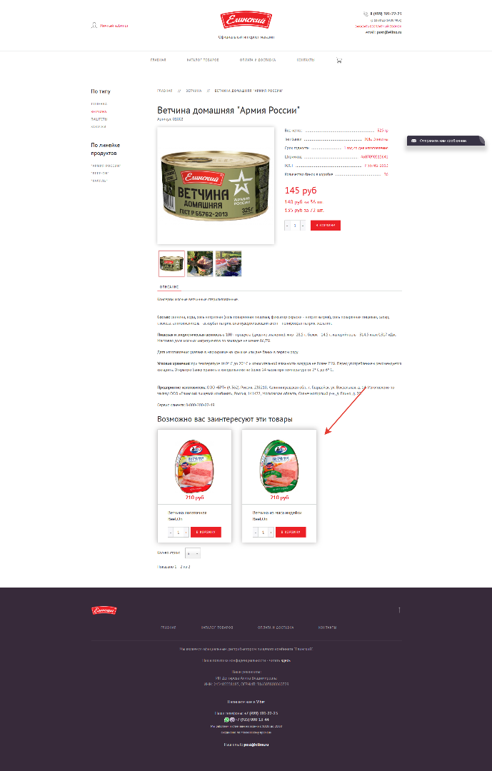

May be I am not so clear....
As stated in the title of this thread - I talk about product page.
under the product page I need to add products from the same category as current (showing) product.
As on the pic
I have added hikashop content module here
with settings that I show in the first post.
But I if go to the product page - I get all products from the main category - not only the same category as current product.

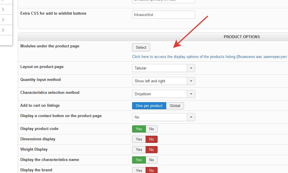

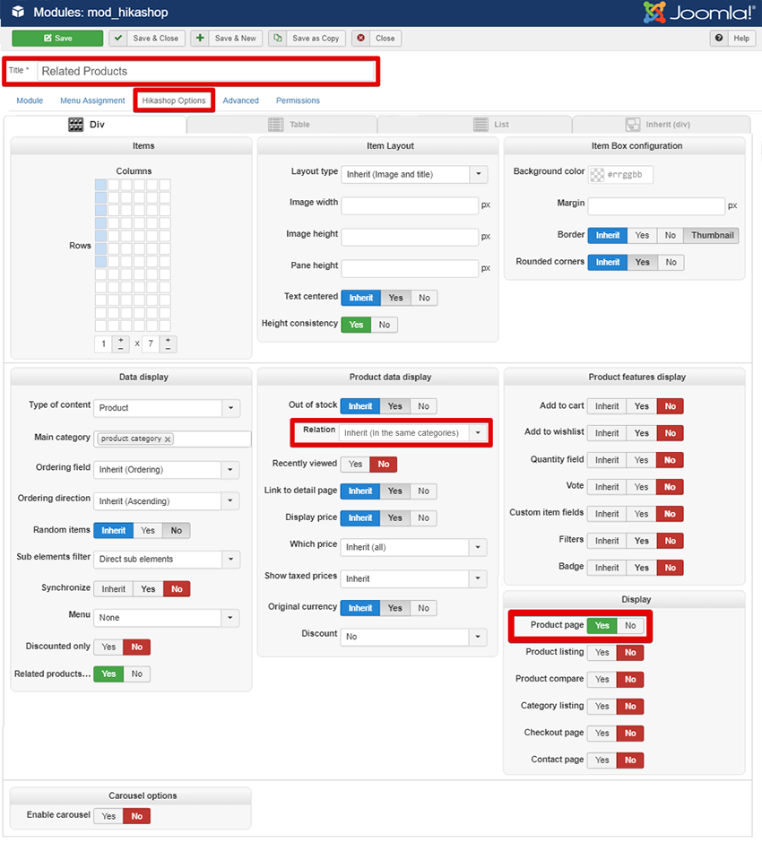

8 years 10 months ago #279220
Try to reproduce this configuration in the HikaShop default "related module", from my side that make the trick :
Don't forget to of course add the module on your product page configuration.
Hope this will fit your needs.

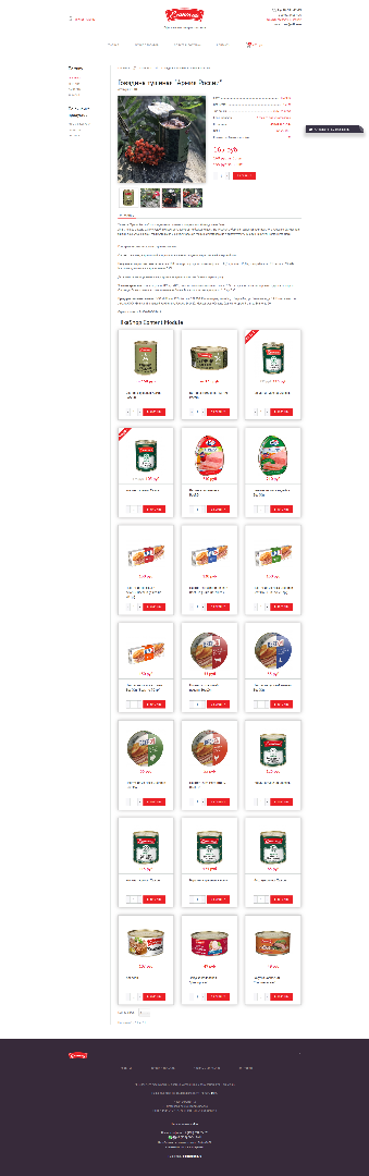

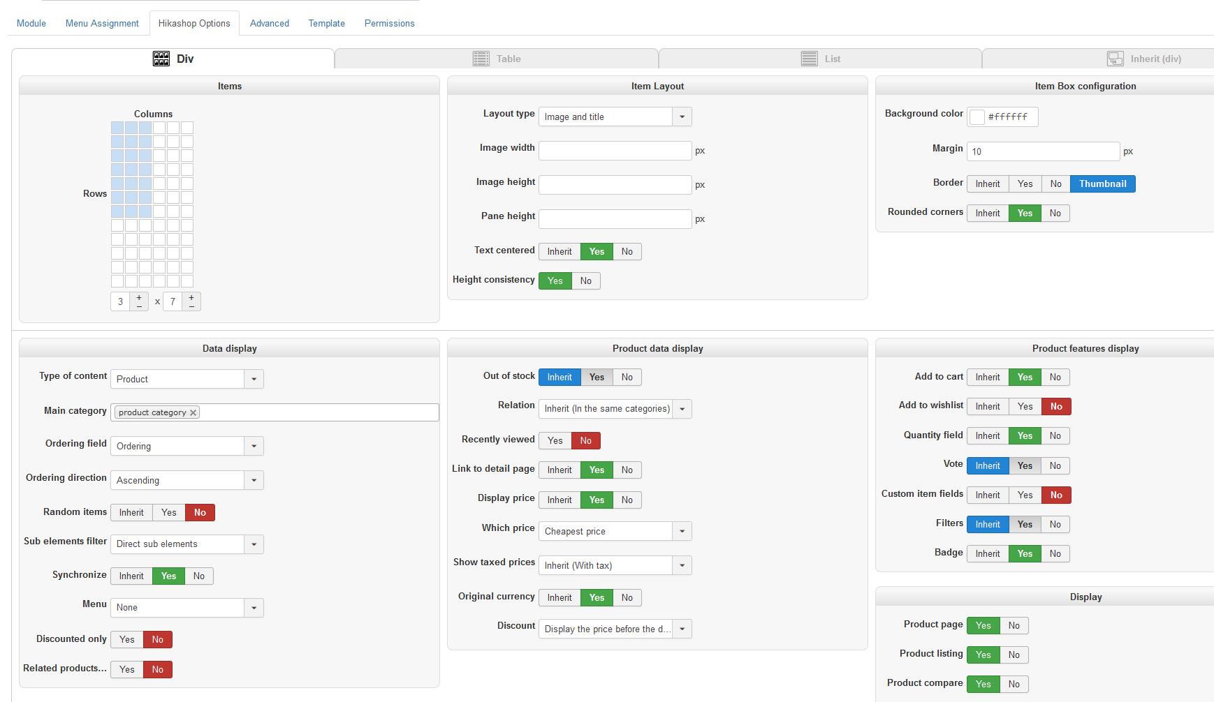

8 years 10 months ago #279291

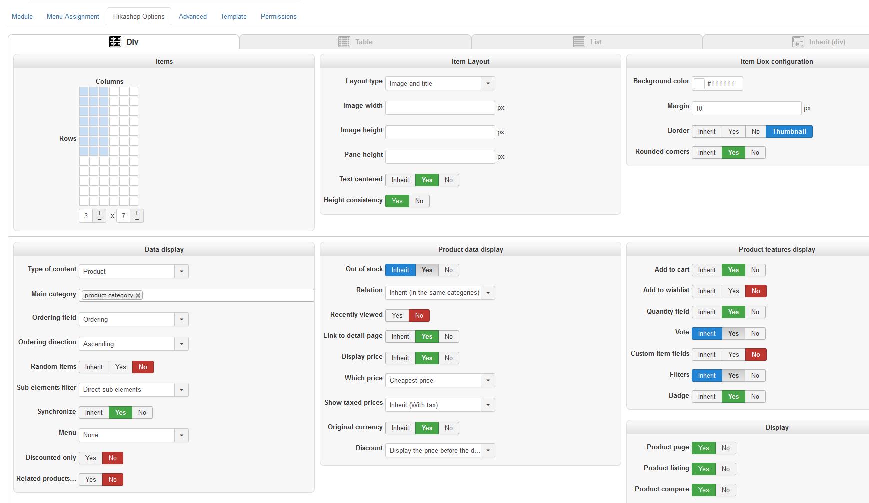

I have tried your method but without success
Here is configuration of the module

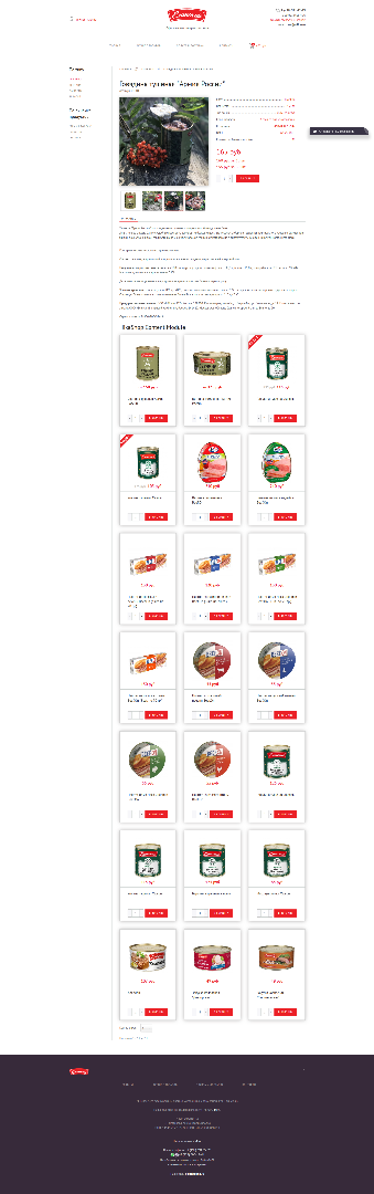

and here is result: (all products of the store - not only this category)

8 years 10 months ago #279300
Then, can you check the categories of the product ?
Because if one of them is the main category of your shop, that would explain the problem.
  • Posts: 2293
  • Thank you received: 315
8 years 10 months ago #279367
nicolas wrote: Hi,
I don't think about it....
Yes, this is that case....
