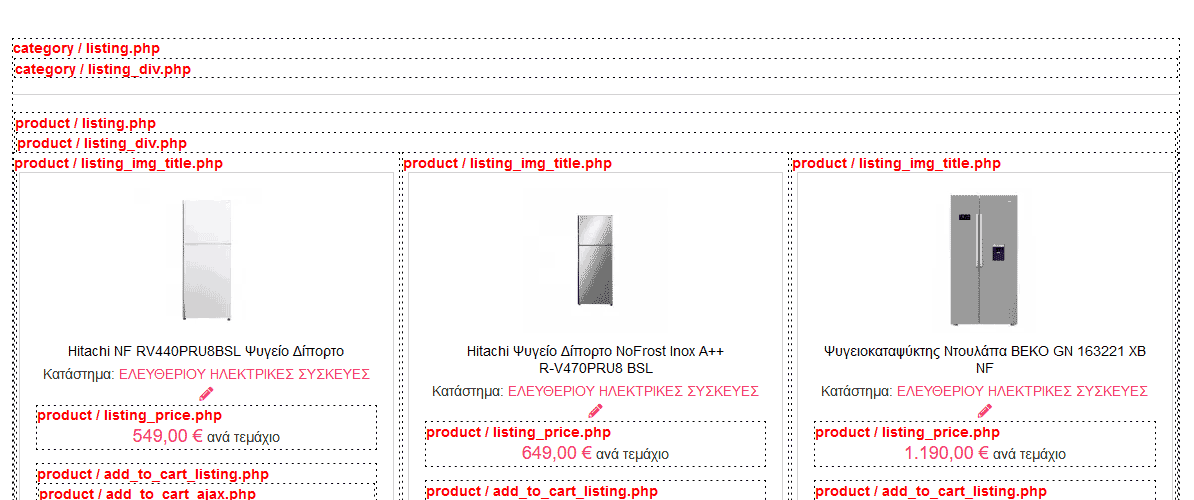

5 years 6 months ago #330451
In order to refine our advice can you provide us with the following elements :
- An url to the context where the message is displayed when this isn't desired.
=> No need to have the current custom message display.
- A screenshot of this same context but with the Display view files option activate on Front-end
=> You will find this option from Main HikaShop Configuration => Advanced tab, first displayed option.
Awaiting your element to better answer you.

5 years 6 months ago #330462
(Removed from post owner) (here we do not want the "NO PRODUCTS AVAILABLE" message to how because as you can see there are products in this category.)
We need to show this message to all lowest level categories that do not have any products, no matter if you visit these categories by menu item or any other way.

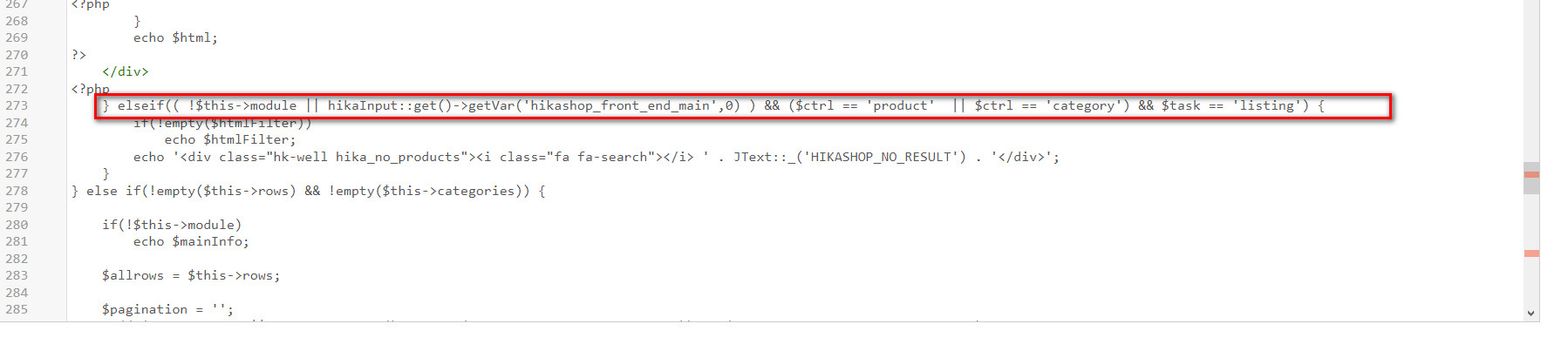

5 years 6 months ago #330663
Sorry for this but I have made a mistake, really sorry for this, I analyze deeper the solution let's restart from scratch, follow me step by step :
- First don't use category/Listing view but rather the product/Listing
- Go around line 270, find this code :
} elseif(( !$this->module || hikaInput::get()->getVar('hikashop_front_end_main',0) ) && ($ctrl == 'product'  || $ctrl == 'category') && $task == 'listing' && !empty($this->filters) && is_array($this->filters) && count($this->filters) && !empty($this->filter_set)) {
Code view :
The part underlined in red is the one that must be deleted.
- Remove the part after the "...|| $ctrl == 'category') && $task == 'listing' ", to have this :
} elseif(( !$this->module || hikaInput::get()->getVar('hikashop_front_end_main',0) ) && ($ctrl == 'product'  || $ctrl == 'category') && $task == 'listing') {
This solution is a little tricky but must better fit your needs, and will display automatically a message thanks to this code :
echo '<div class="hk-well hika_no_products"><i class="fa fa-search"></i> ' . JText::_('HIKASHOP_NO_RESULT') . '</div>';
Hope this will fit your needs.
Last edit: 5 years 6 months ago by Philip.

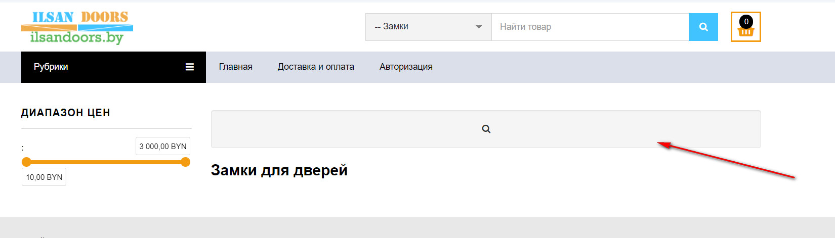

4 years 8 months ago #338588
Hello. Thanks. Helped. But another problem arose. When I open a subcategory in which there are other subcategories, it says that the product was not found. Example:
I would like such a message to appear only for the search, when the product is not found. Is it possible to do it this way?
4 years 8 months ago #338596
You can try 2 differents solutions :
1. First in the relative Item Menu (with the Id 2723), go to Categories options tab, and in Category data display
=> Define the "Only with products" on "Yes"
Il the previous solution didn't work :
2. A custom css command to directl hide this part for required context.
Example :
.required_context_id1 .hikashop_submodules,
.required_context_id2 .hikashop_submodules {
// To hide unwanted "no product found" message
display: none;
Hope this will you to achieved what you need.
Last edit: 4 years 8 months ago by Philip.

4 years 7 months ago #338650
I think it comes from the code in product / listing.php
By default you should now have:
You're basically missing the part
which says "only when filters are there and used".
