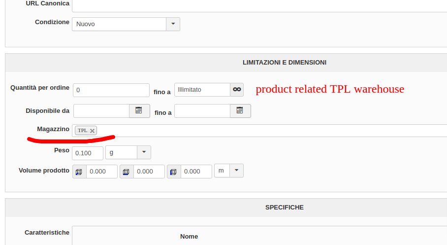

Hi there,

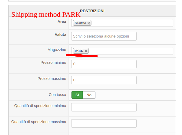

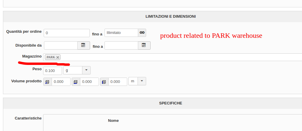

We would like to be able to have separate payment methods in the same cart, as is the case with shipping methods using the warehouse and restrictions technique.

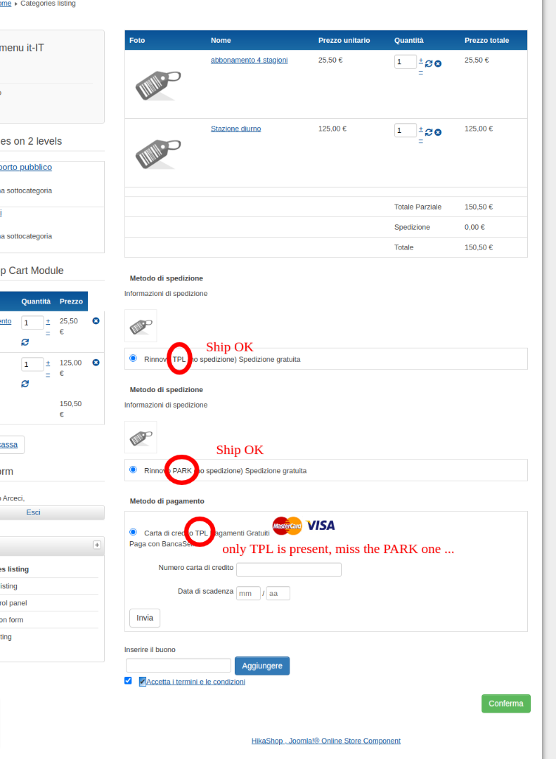

As you can see from the screenshots, products on different warehouses in the same cart have shipping methods that match the warehouse, but the payment is only one!

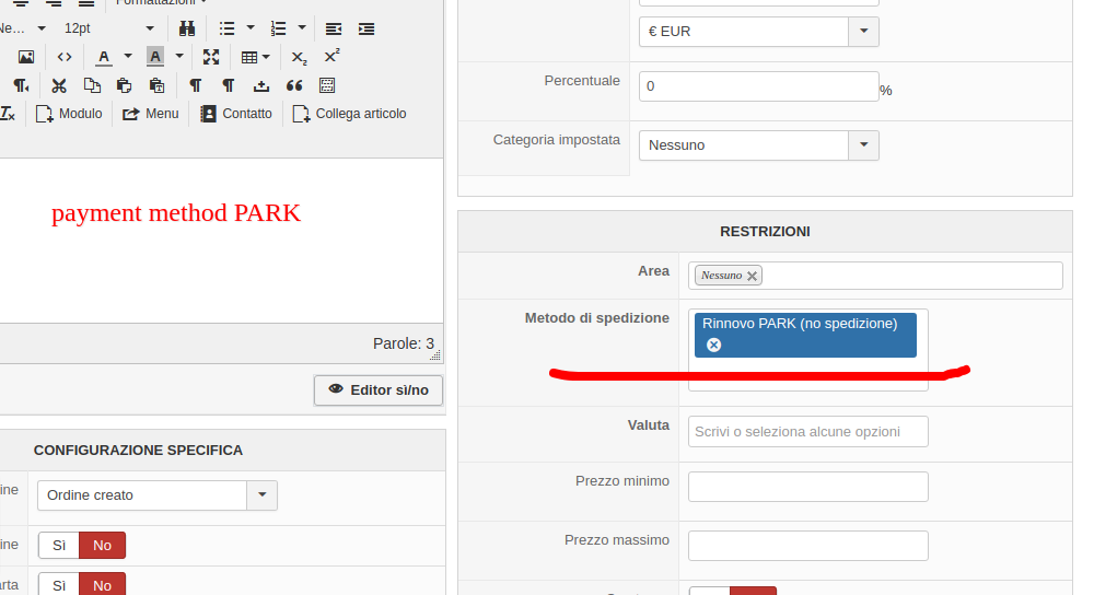

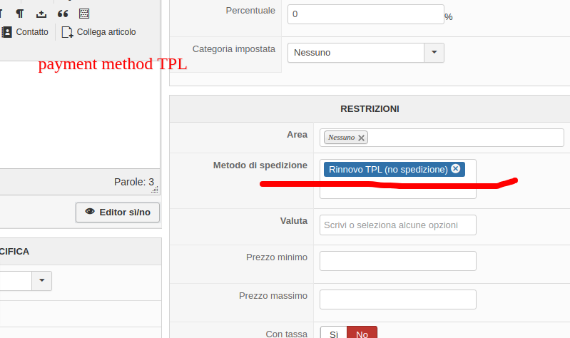

Payments have been successfully configured with the right shipping method as a restriction (following the wharehouse and so the related products).
It would be useful to have the payment method for the products in the first section along with a specific "Confirm" button.
Same scenario for the products in the second section.
When you press one of the "Confirm" buttons present in the Cart, you proceed to pay for that specific section using the payment method chosen from the possible ones in list.
At the end of payment session, it will return to the Cart with remaining products (second section), and you can proceed with the second payment.
Is it possible to achieve this result?

When you edit a payment method in the System>Payment methods menu, you have a "vendor" setting there. So you can select a vendor in it and the payment method will only be available when the products in the cart are for that vendor.
