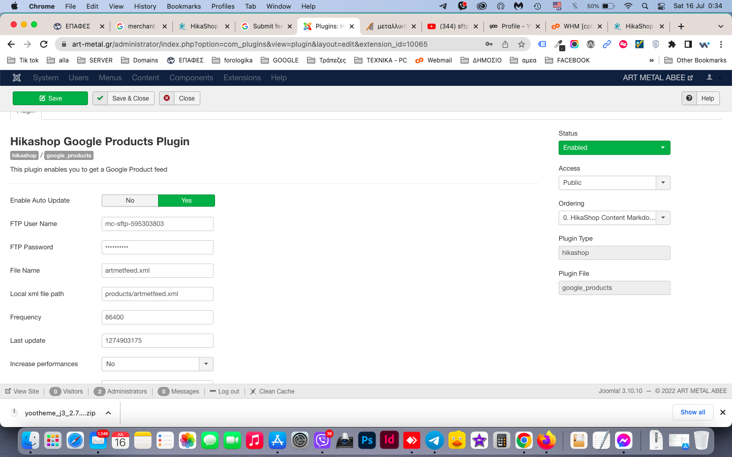

Hello!
While I m trying to create the feed for google merchants I ended up uploading my feed manually.
But it would be good If I good make the url work .
I added the url on the plugin but I get 404 error while I m trying to access www.site.com/products/artmetfeed.xml
  • Posts: 85786
  • Thank you received: 14079
3 years 11 months ago #343272
The xml file will be created when the plugin is triggered by your cron task.
From what I can see, the problem is that your cron task is not running.
Here is a documentation page on how to setup your cron task and how to make sure it is working:
www.hikashop.com/support/documentation/5...ashop-cron-task.html
