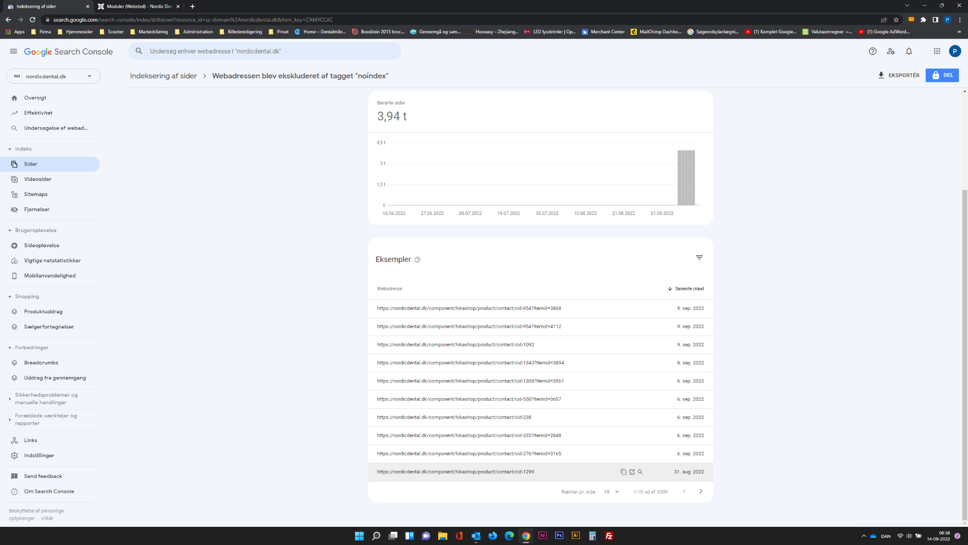

  • Posts: 159
  • Thank you received: 5
3 years 10 months ago #344654
Please see photo.
  • Posts: 86042
  • Thank you received: 14174
3 years 10 months ago #344660
I don't see any errors there.
It's just a list of the noindex URLs. And that's normal you see the contact form pages there as you don't want them to be indexed for each product.
So there's nothing to worry.
