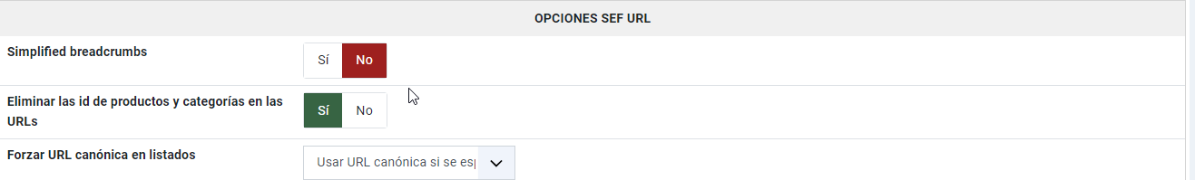

3 years 3 months ago #352160
How to display full tree path of the categary product in bredcrams joomla module. Everythings is ok, but when I go last level of category doesn`t show any path only -> Home-product (without category)
In attachments you can see configuration.

3 years 3 months ago #352162
You indeed have to turn off that "simplified breadcrumbs" setting. Once you do that, HikaShop will add an extra "category_pathway" parameter to the products URL when generating them.
Now, this means that if you already have canonical URLs in your products with the "force canonical URLs on listings" setting activated in the HikaShop configurartion, HikaShop won't be generating the URLs since he'll directly use the canonical URLs.
In that case, you would have to empty the canonical URLs using a mass action to have HikaShop regenerate them with the extra parameter.

3 years 3 months ago #352173
Can you explain to me that bulk action to flush the canonicals?
I'll also need to know how I can auto-refill them to make it a friendly URL.

3 years 3 months ago #352179
To reset all the canonical URLs at once, you can use a mass action with an action "update the values" on the "product_canonical" column and an empty value:
www.hikashop.com/support/support/documen...massaction-form.html
