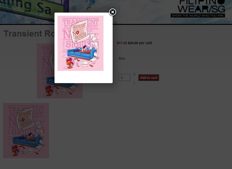

HI, i have an inquiry on my product image, i have a thumbnail view of my product but when i click it to zoom in and magnify, i also see the same image size. I did try to upload a bigger version of the image so when you click the thumbnail it will show the enlarged version but to no avail. Is there a way to do this? please advise. Thanks

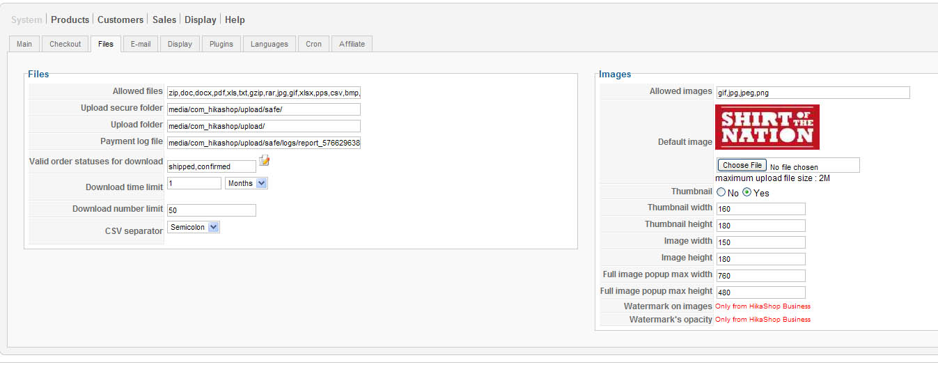

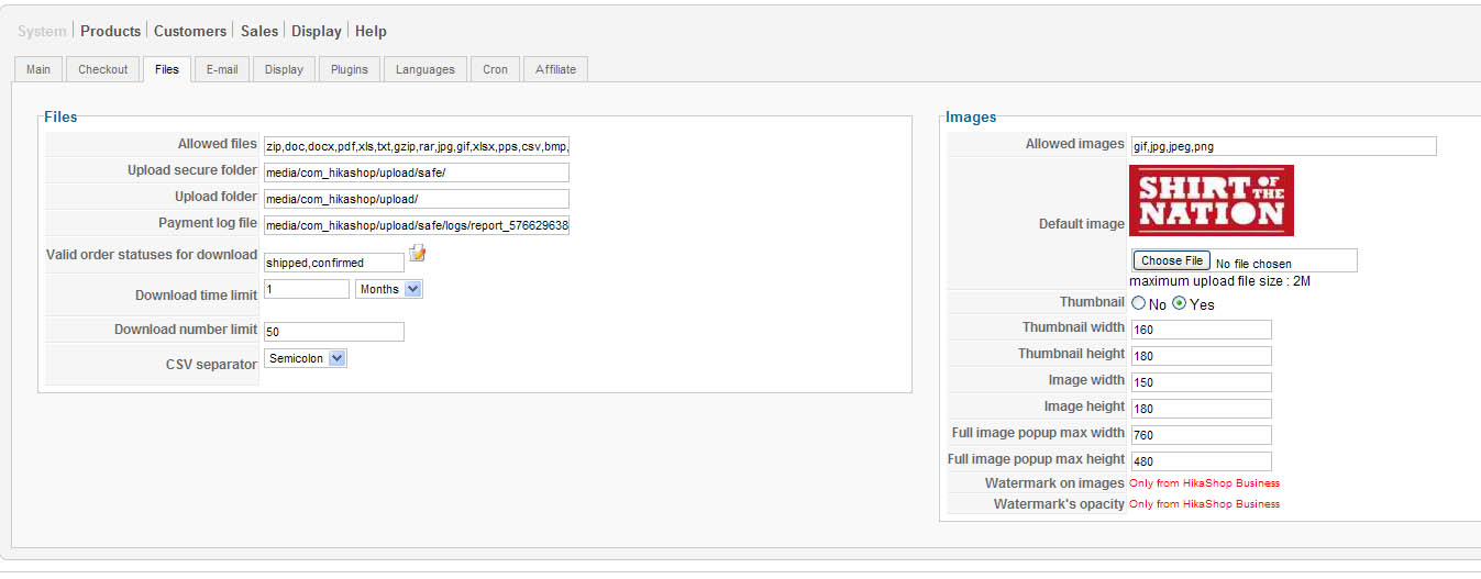

Could you do a screenshot of your options under the tab files of the config of hikashop ?
  • Posts: 18
15 years 5 months ago #9583
Hi, Here is the screen capture. Hope you can help me on this, Thanks!
  • Posts: 86045
  • Thank you received: 14175
15 years 5 months ago #9587
The "image width" and "image height" options define the size of your main images. If you don't want to resize your main images you should leave both fields blank. Right now your main images have the same size as your thumbnails since that's what you set there.
