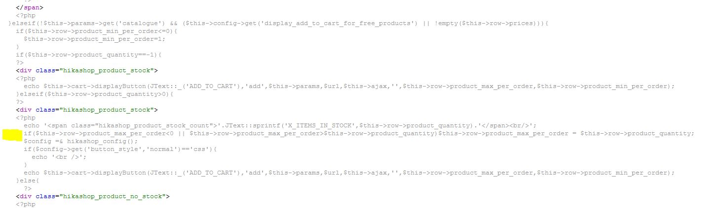

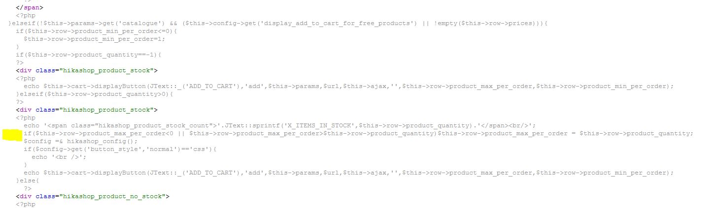

Ajout de la ligne:

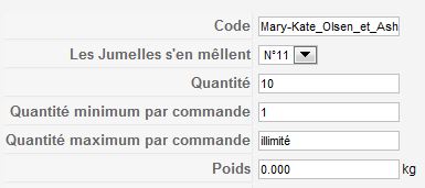

Config produit coté backend:

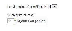

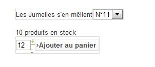

Symptome coté frontend:

Ah oui, essayez comme cela alors:
if($this->row->product_max_per_order<=0 || $this->row->product_max_per_order>$this->row->product_quantity) $this->row->product_max_per_order = $this->row->product_quantity;
