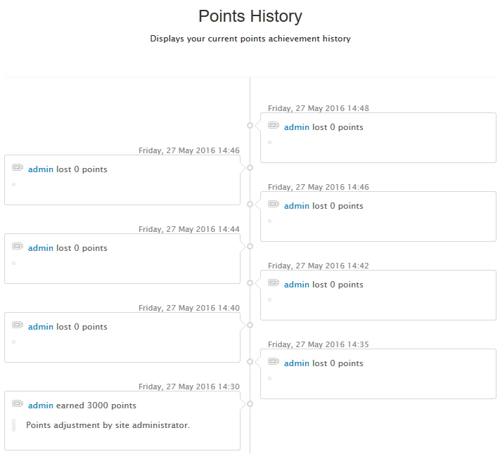

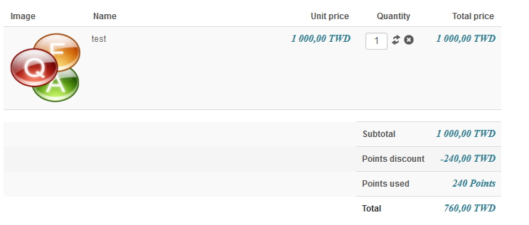

Hi:
Easysocial Points + hikashop Shopping credits applications
What is how to solve
your points problems?
Admin lost 0 points error
Admin lost -240 points correct
test a few times has always been a error
thanks!
