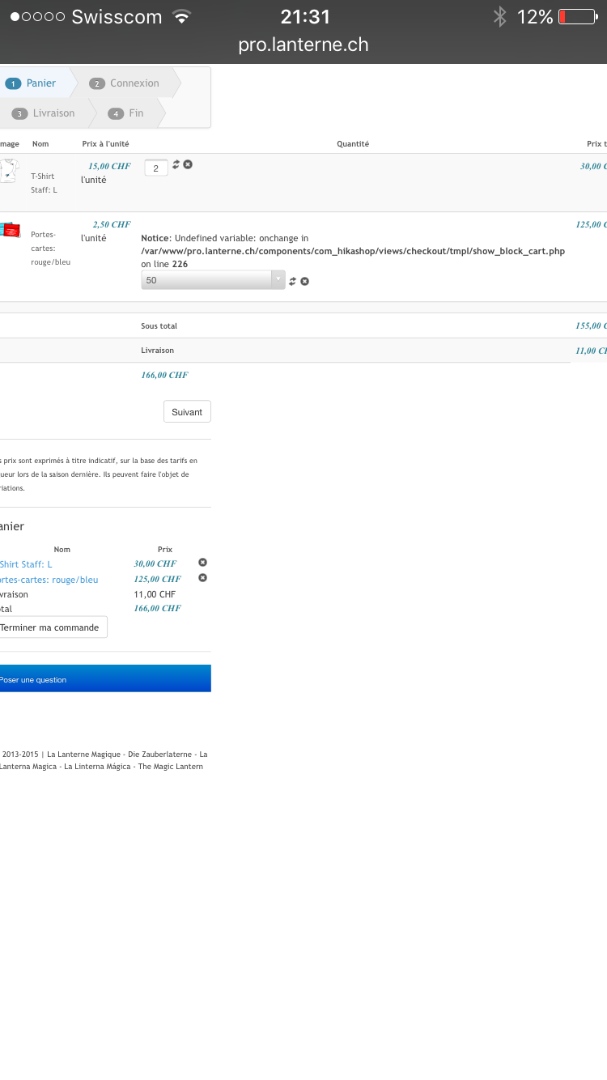

An other problem when I choose a variant; error message (see attached).
Thanks.

5. The warning has been fixed, thanks !

5. The warning remain; I presume because the update fails...

2 - The JS patch is now present in your website.
5 - The patch was not present.
