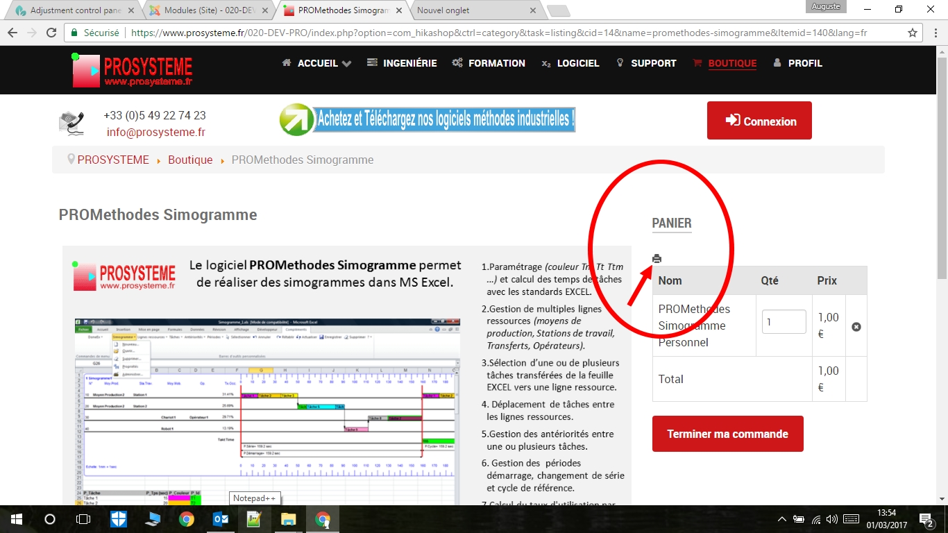

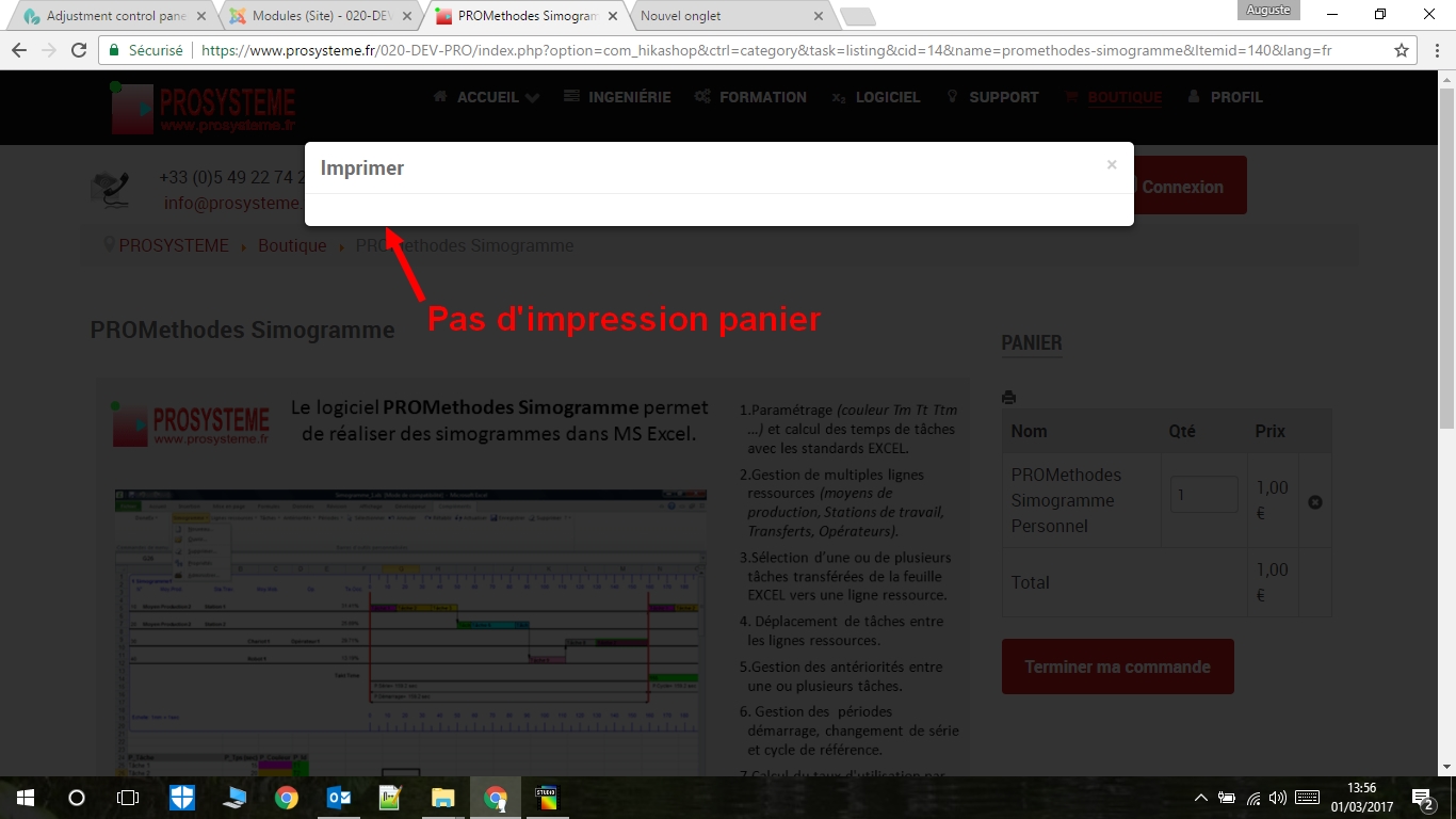

J'ai activé l'impression du panier et en cliquant sur l'icône :
Le contenu du panier est vide
Merci de votre aide

I have create a patch in order to fix the issue of the "print cart".
We first need to perform few tests and we will include the patch into the HikaShop 3 package.

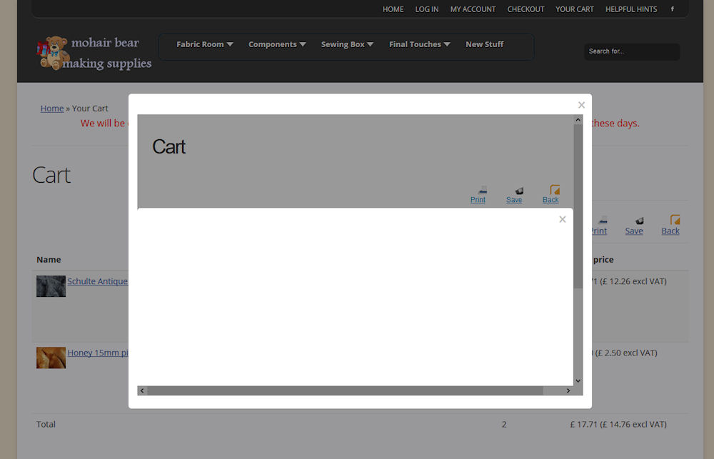

Did this get get fixed as we cannot print the cart, the pop up is blank?
  • Posts: 26387
  • Thank you received: 4078
9 years 3 months ago #270665
Please provide more details about your website (HikaShop version number, if you have view overrides, etc).
The content we can see in the "first" popup is not what is should be ; so I'm afraid that I don't understand how you got it.
If you can explain the workflow ; it will help us to understand and try to reproduce in our side.

HI, As far as I am aware there are no over rides. Version 3.0.1, just upgraded from 2.6.4. In carts select the print button, it opens the pop up that you can see says 'cart' then press print again and it's then the blank screen?
9 years 3 months ago #270751
Can you try to process some test with a default template like ProtoStar and see if that able to display pop-up content.
If the default template don't solve your issue, can you provide an Url link to your issue page and maybe some user frontend & backend access.
Note : You can use our Contact us form, in order to provide important references and add in your message an Url link to this topic.
Awaiting news from you.
Last edit: 9 years 3 months ago by Philip.
