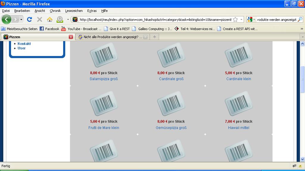

15 years 4 months ago #12836
My boss don't want to set the page online as long as it isn't finished. So i can only show you this pic.

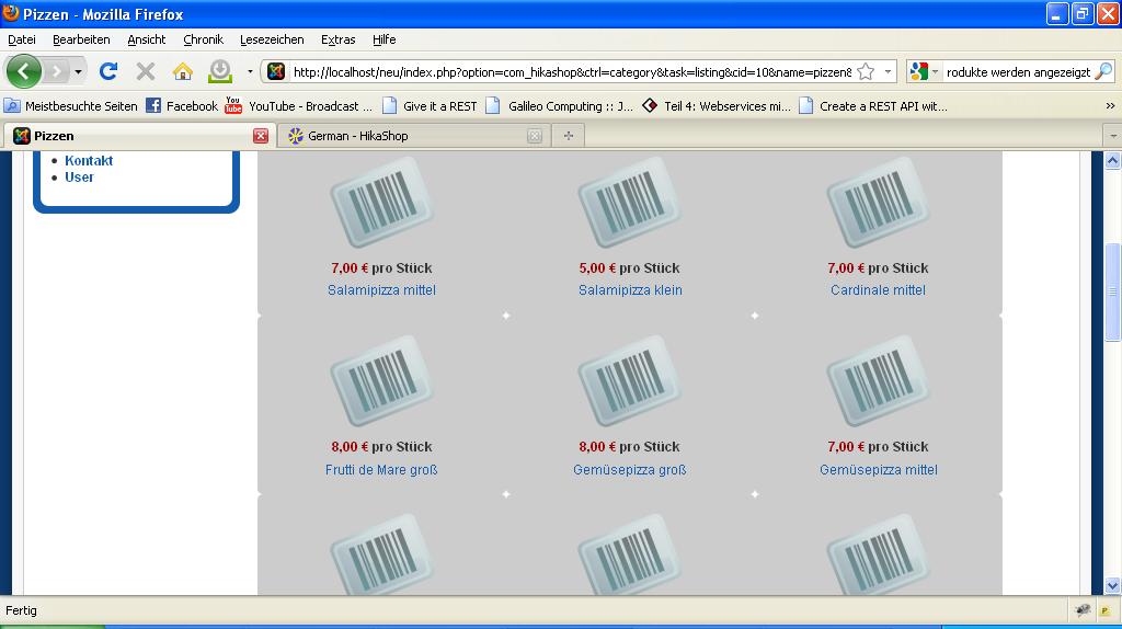

15 years 4 months ago #12838
And after i refresh the page it looks like:

15 years 4 months ago #12845
It seems that you activated the "random" option of the listing of products.
You need to go in the menu Display->Content modules and edit all the modules and make sure that the random option is turned off.
