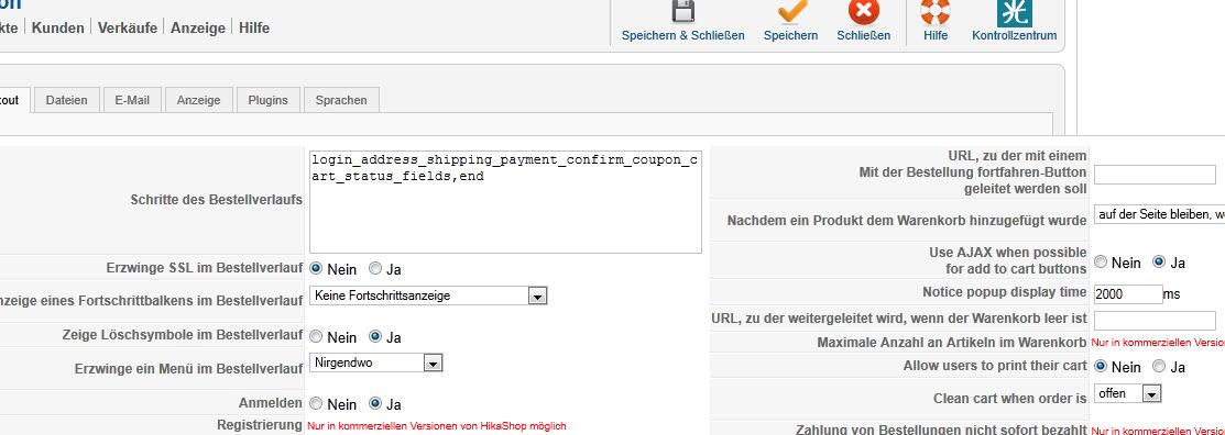

Could you do a screenshot of the Checkout tab of the config ?

  • Posts: 13
14 years 11 months ago #24104
Maybe you can see anything
  • Posts: 86042
  • Thank you received: 14174
14 years 11 months ago #24111
That seems right indeed.
