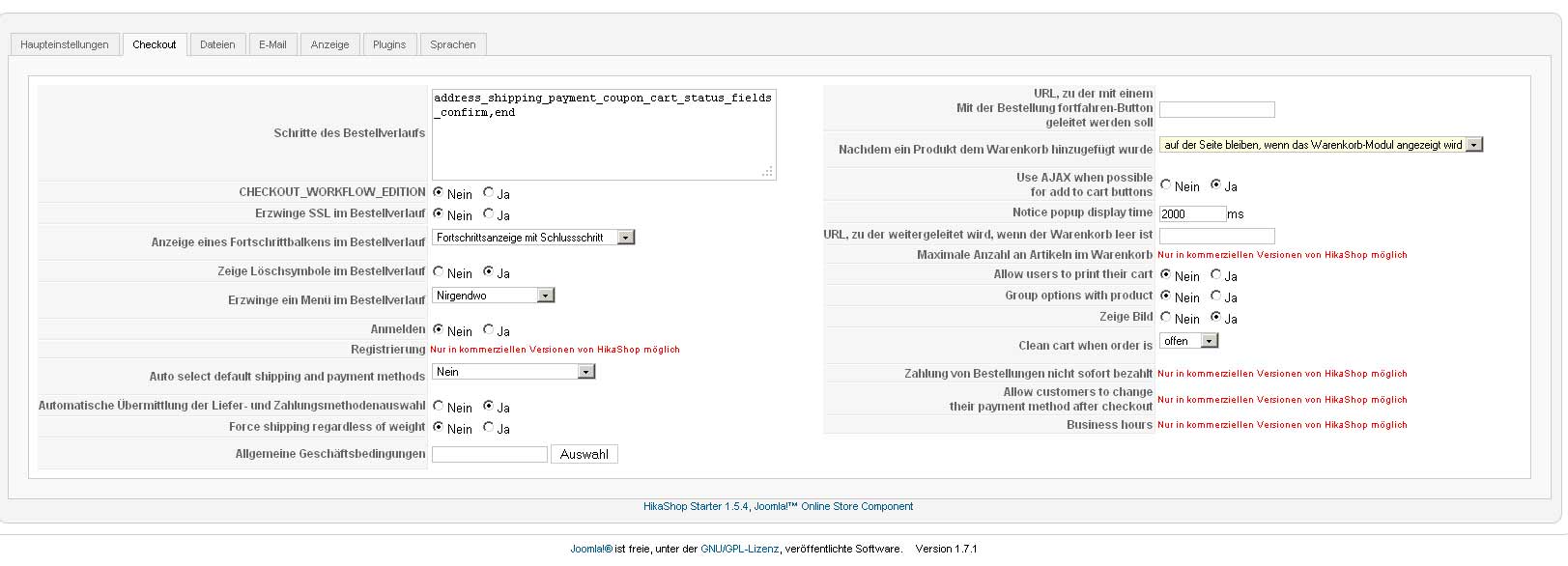

You could give the checkout workflow you're using?
Maybe you could do a screenshot of the tab "Checkout" of the configuration ?

14 years 9 months ago #29201
Danke für Deine Hilfe..
Ich hoffe Du kannst den Fehler entdecken!

The problem is that you can't have the "address" view without the "login" view on the checkout workflow.
You need to add it back or remove both.
