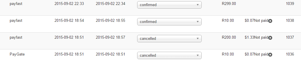

  • Posts: 152
  • Hikashop Essential
10 years 11 months ago #213205
On the orders listing in the back

  • Posts: 26381
10 years 11 months ago #213231
I clearly don't see any specific problem or issue there.
You have the indication that the order has been made with an affiliation ; and what the affiliation total is.
Okay, they are two cancelled orders ; but these orders can be "created" or "refunded".
Why do you want to loose information, to loose knowledge just because of that ?
The orders are cancelled so you can't pay the affiliate for these ; it is just not possible.
But you still have the information that the order has been made with an affiliation ; you have the knowledge and you can still use it even if it's not to pay the affiliate (but for statistics or else).
So, there is no bug and no issue.
Now if you want to loose information, you can create a "mass action" to modify the orders are remove the affiliation data.
It is not something I'll recommend, like I just explain but it's your right.
