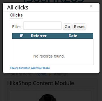

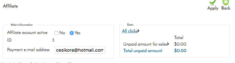

When affiliates log in and try to see the "all clicks" page under stats, nothing happens when they click the button (the page goes nowhere.)

As you can see, a popup window is expecting, from this many reasons can lead to this kind of issue.
Can you try to test with ProtoStar in order to see if that solve your issue, if yes it's linked to your template and so contact his creator.

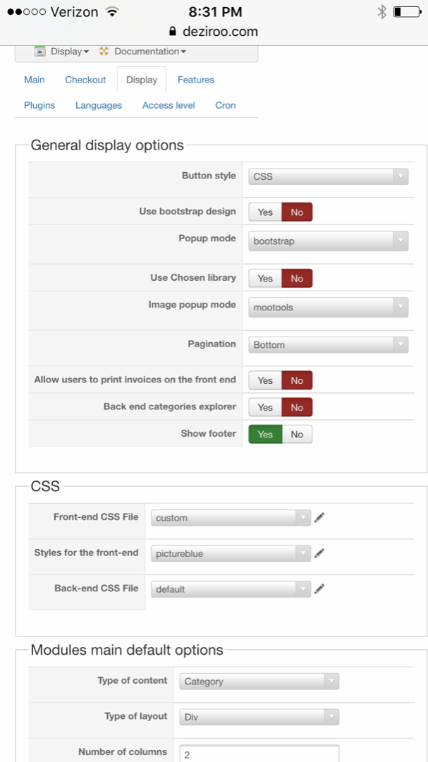

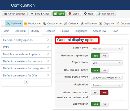

- A screenshot of your General display options (in Components => HikaShop => Configuration, then Display tab), like this :

Here is the screenshot and I sent more info via the contact page.

The problem comes from your template which doesn't support the Joomla popup system.
Go in the HikaShop configuration under the "Display" tab and try the different options of the "popup mode" setting.
