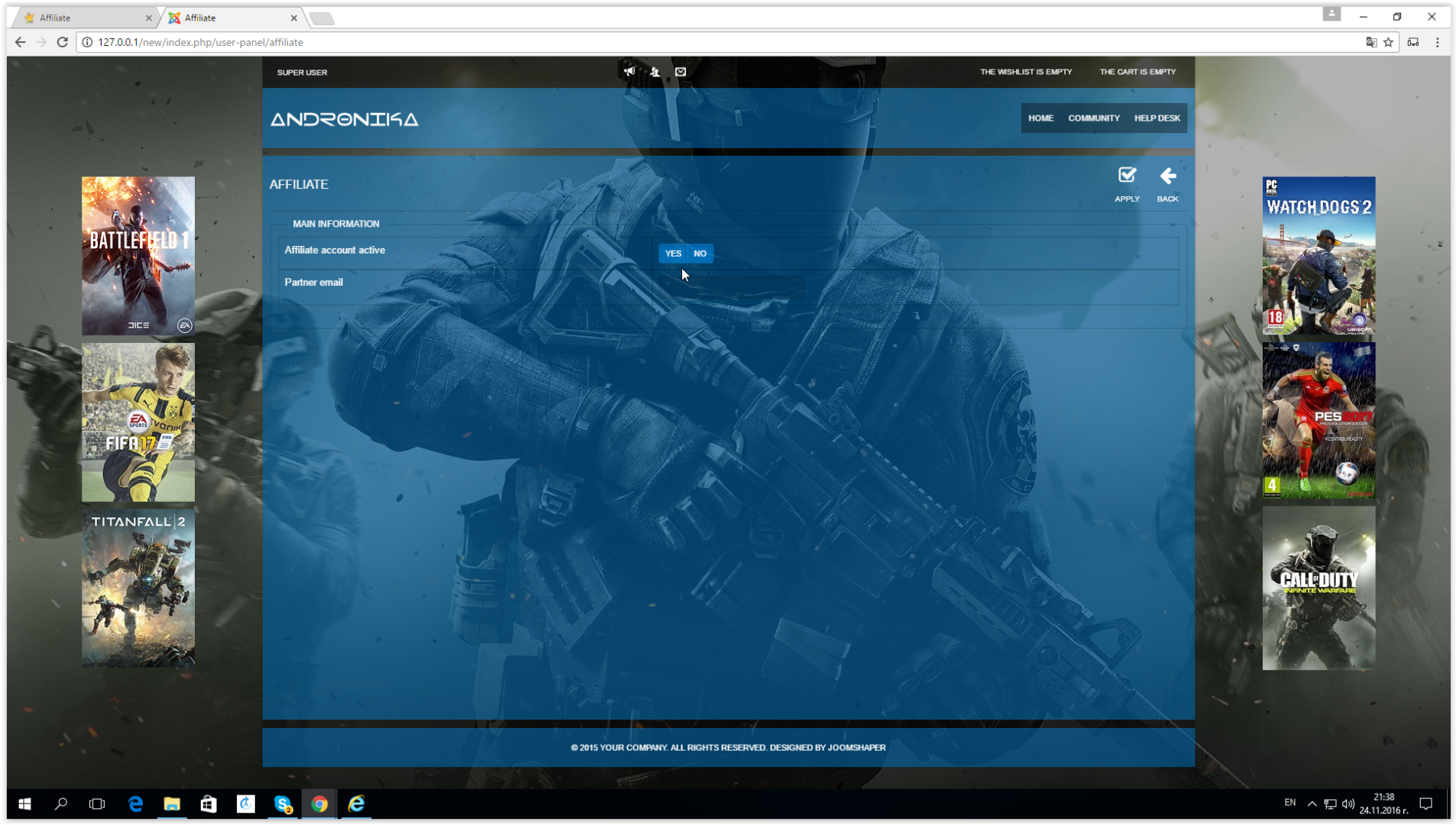

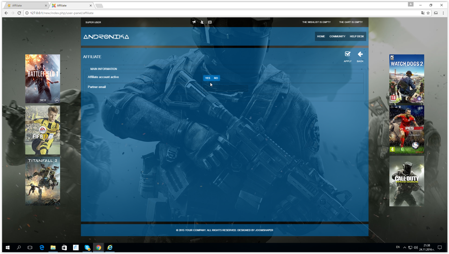

Hi currently use Helix3 v1.7 that uses the latest version of Bootstrap v3.3.7, and now I have a problem with two buttons - they do not function properly. How can I fix this problem?

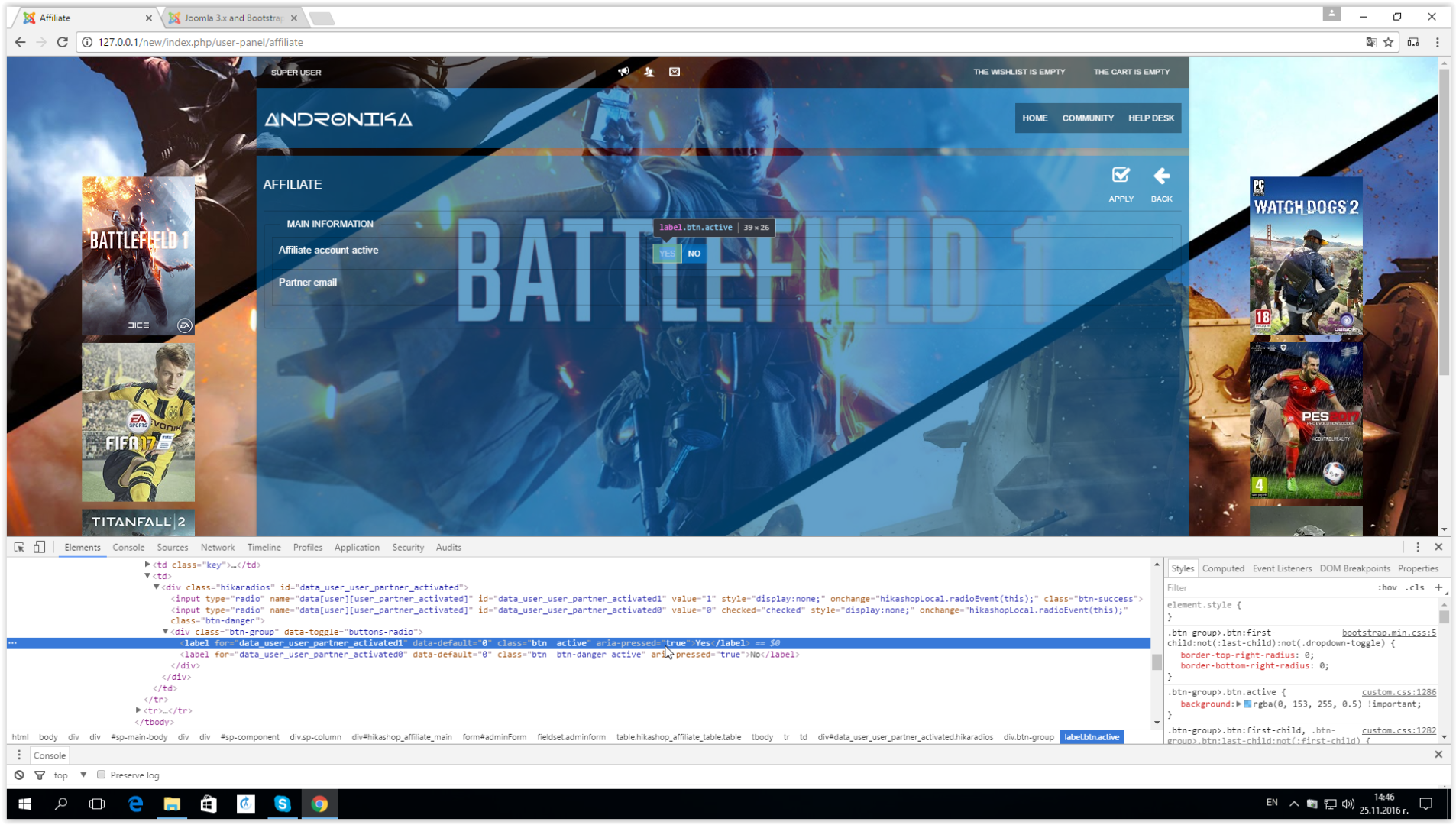

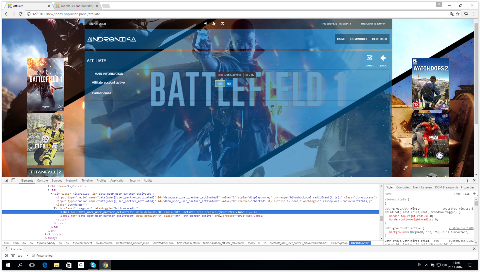

Hi, unfortunately, does not work for me. I noticed that when you press the buttons to receive an generated additional code may be why.
This generated code is aria-pressed="true" or aria-pressed="false".

It looks like a CSS issue with the template CSS not handling the btn-success and btn-danger classes.
Removing the hika from the code should prevent the use of boostrap for the radio so that it uses instead standard HTML radios.
If you don't see any change I would then think that either there is something converting them dynamically on the page, or that you didn't edit the correct code or you didn't edit the view file for the correct template.
Could you check on these ?
