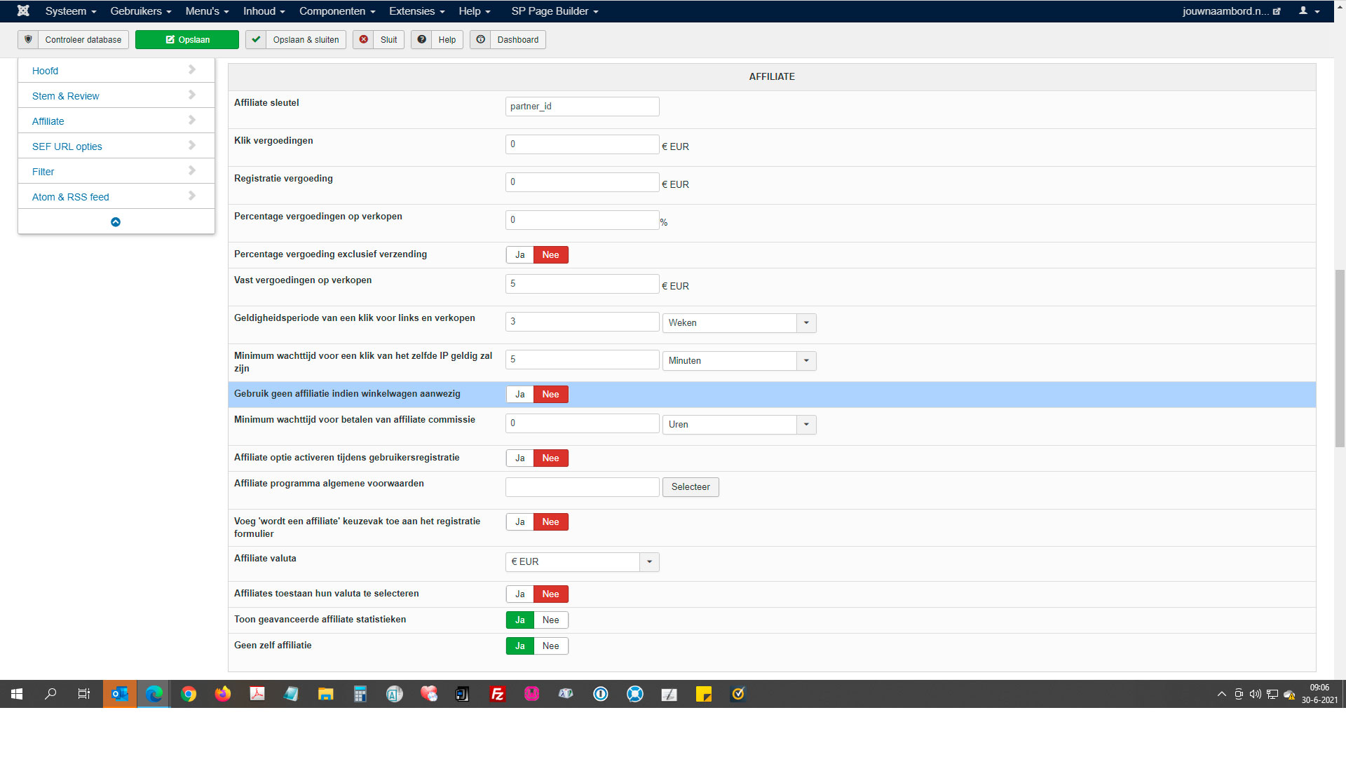

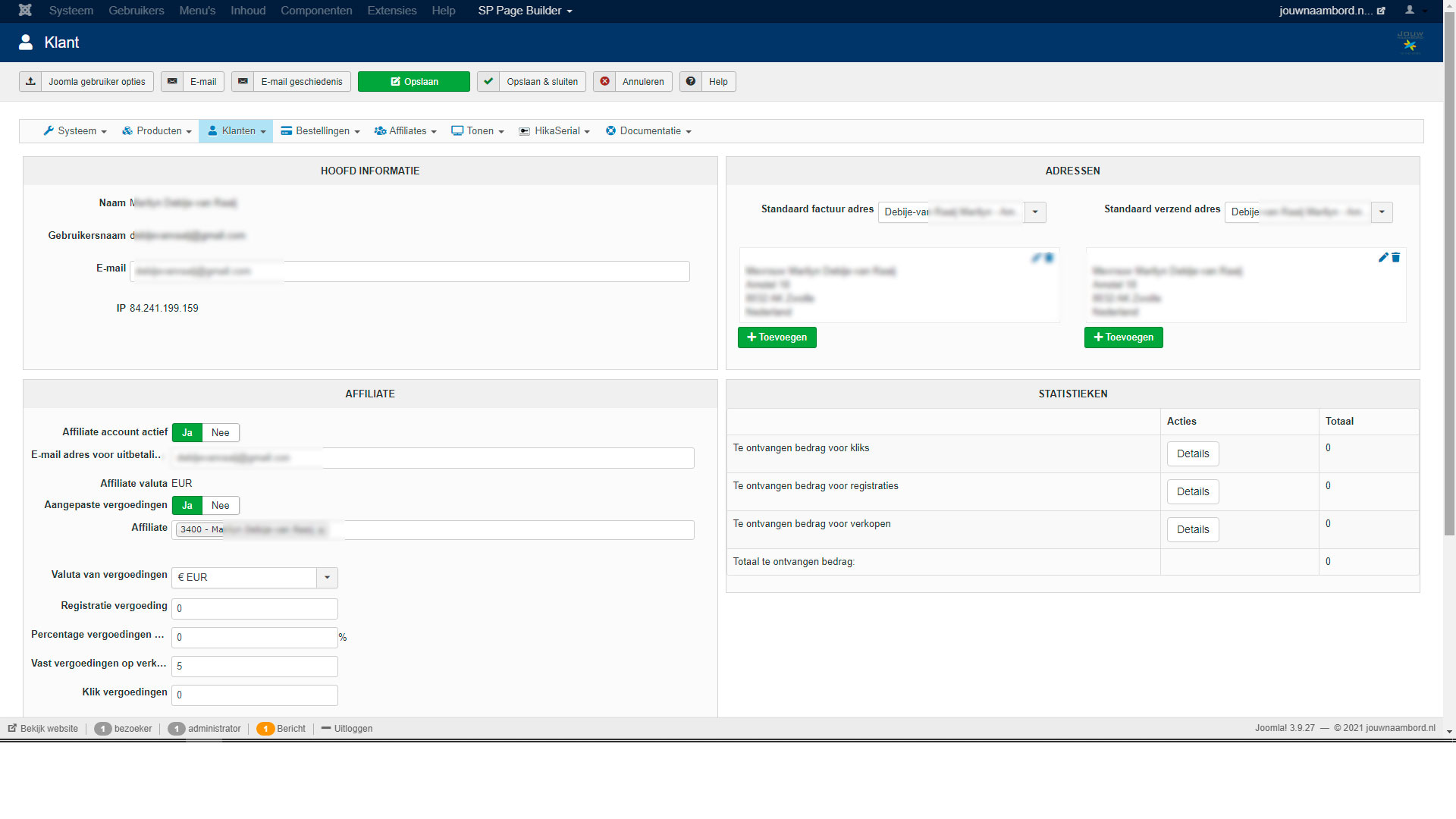

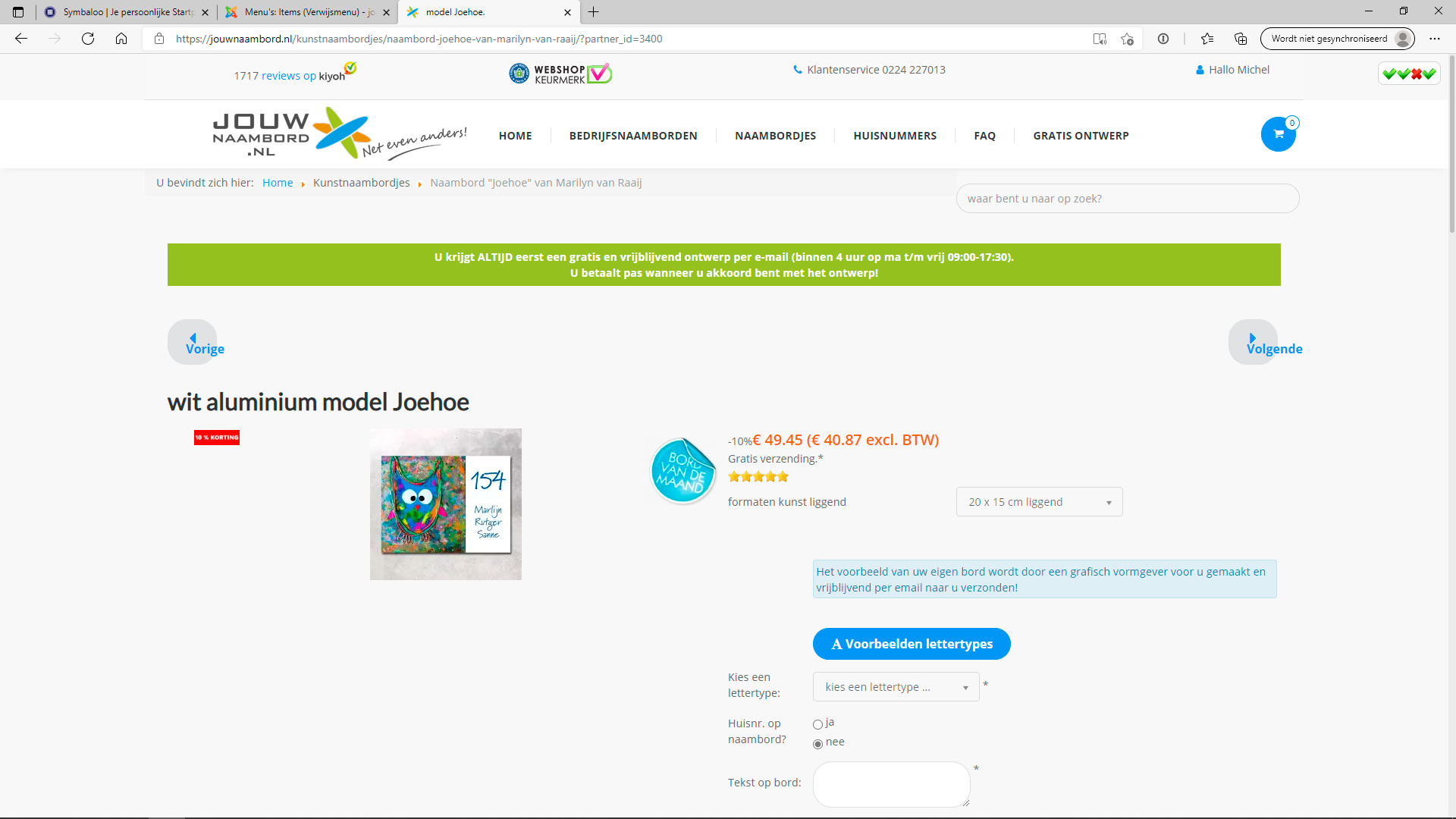

Since some time the orders are not added to the affiliates anymore. I've made some screenshots to show the orderpages.

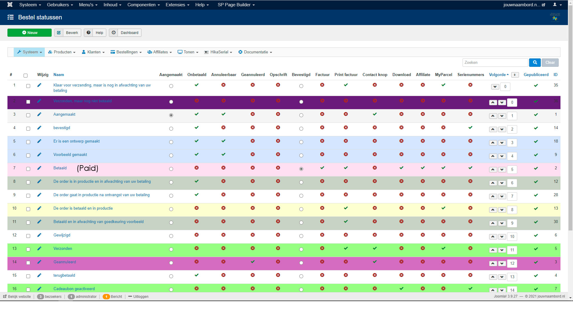

Did you use the affiliate link of a partner before making that order ? Did you create a new account or used an existing account ?
Could you provide a screenshot of the "affiliate" section of the HikaShop configuration ? And one from the System>Order statuses menu ?

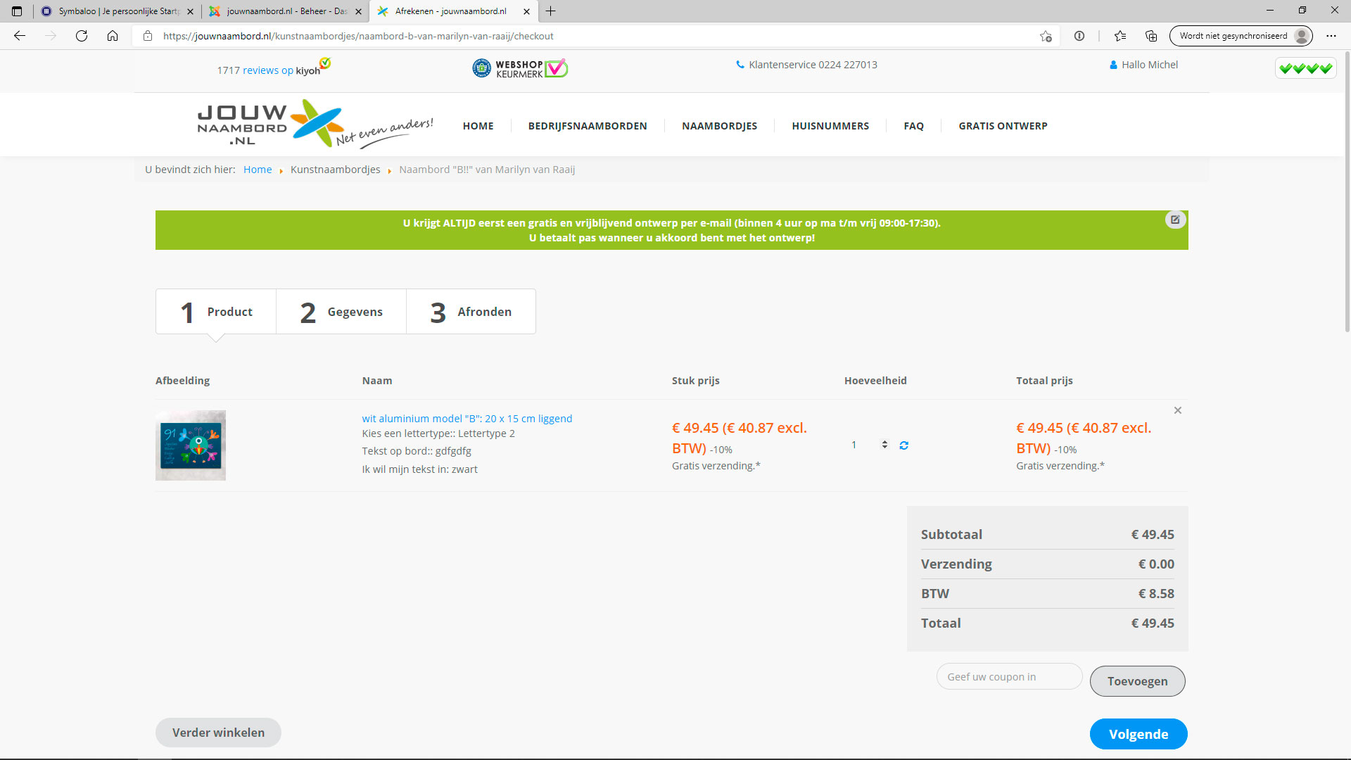

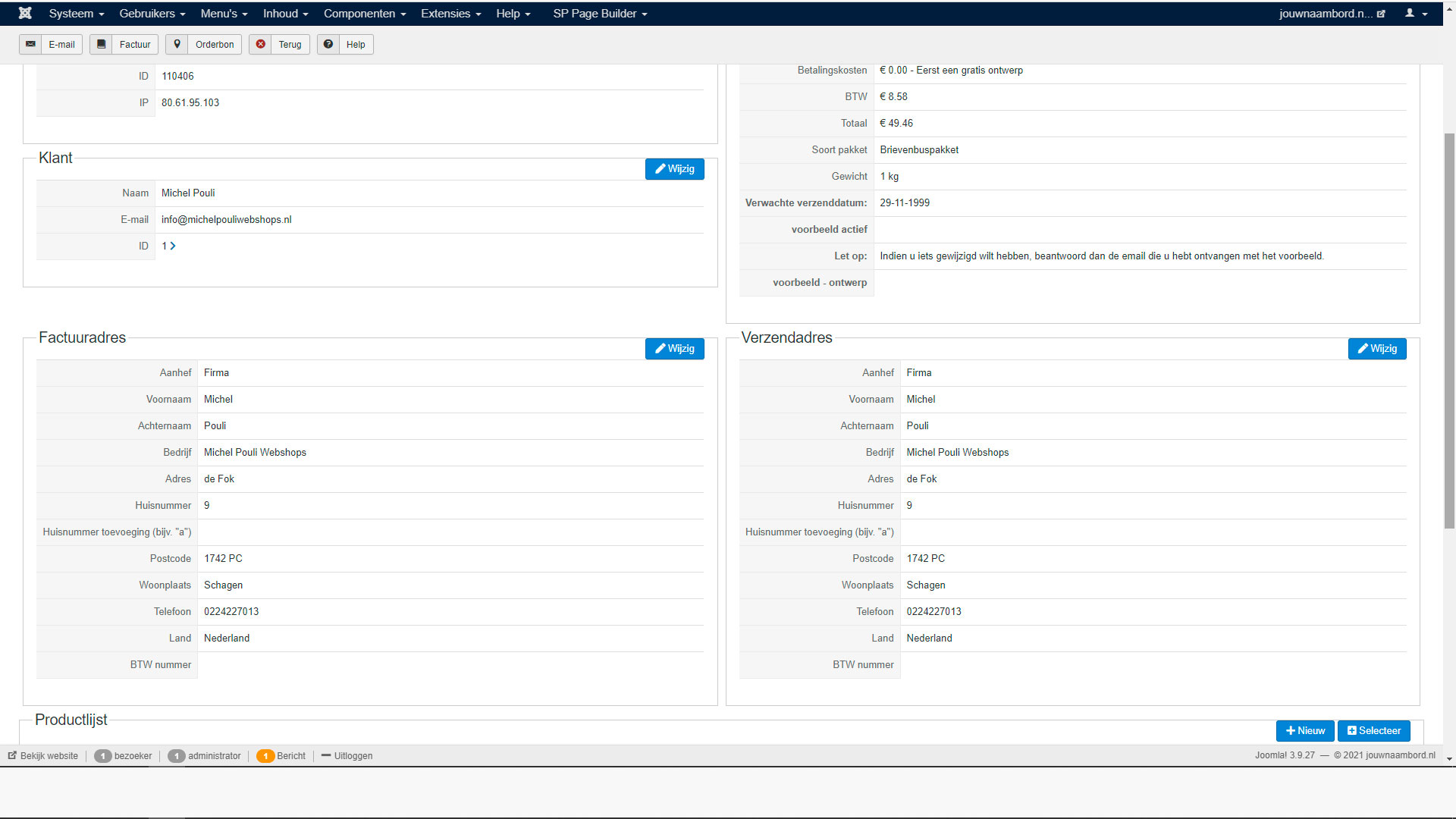

  • Posts: 515
  • Thank you received: 22
5 years 5 days ago #334002

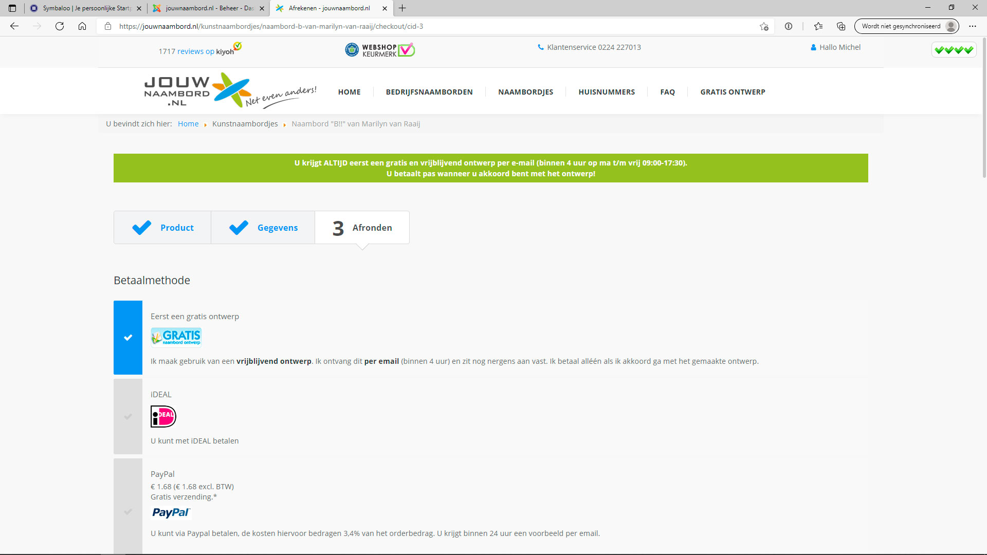

The orders are made directly on the website (see screen1.jpg, the right link is in the addressbar). It's an existing account, it has worked fine for years. Here are the screenshots.

5 years 4 days ago #334004
You set a "Validity period" of 3 weeks. So the affiliate cookie added to the browser of the user will be valid for 3 weeks after you click on the affiliate link. After that, there will be no cookie so the system won't know that you came from somewhere else and won't add the affiliate to the order.
Also, you have the setting "Add partner to user account during registration" turned off. When turned on, if someone registers to your website while the affiliate cookie is still in his browser, the information will be transfered to his user account and in that case, the affiliation will be valid without a validity period.
Finally, you have the "No self affiliation" activated, so the user account you're using for your test purchase cannot use the affiliate link he got as a partner. It needs to be the link of another partner.
So the way you setup the affiliate program, it should only work if you click on the affliate link of a user account and then place an order. I would recommend that you test this first.
If it worked with existing accounts for years without validity period, it's probably that you had the "Add partner to user account during registration" setting turned on before.

No, the orders always are placed directly on our own website and not coming from any external affiliatelink.
I work together with some painters who allow us to use some of their paintings for producing unique nameplates. These artists are the only affiliates we work with. So we don't wan't customers to become affiliates, just artists we choose ourselves.

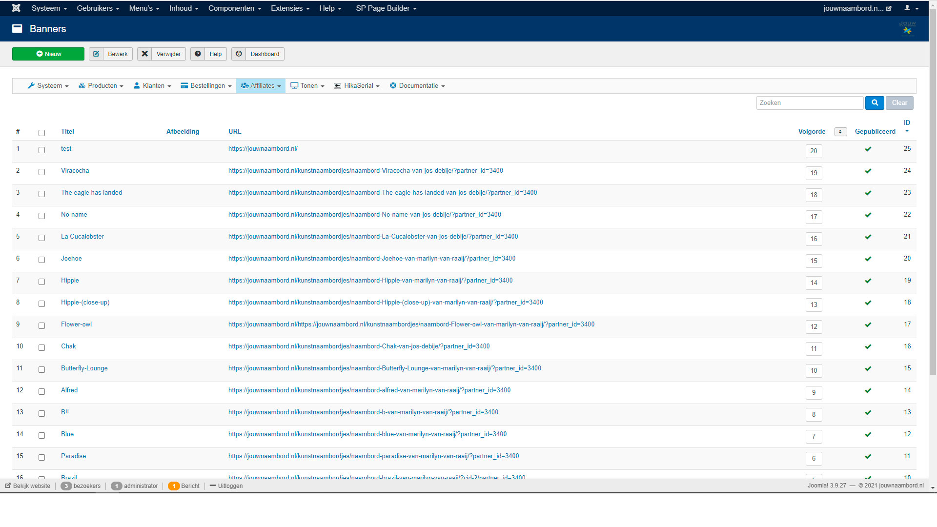

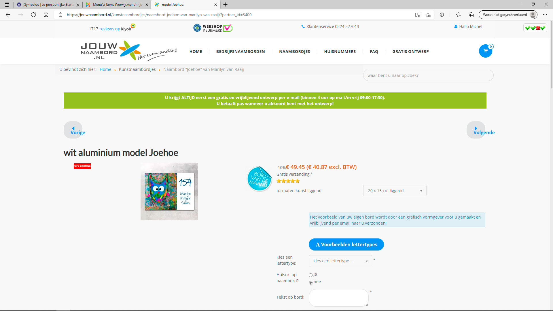

In the past I made for every product with art from these artists an affiliatebanner as shown in screenshot 9. When any customer choose this product on our website, the affiliatelink is visible in the addressbar and used for the checkoutproces (screenshot 1).

Since the user will be directed to the link with the affiliate parameter before the order, then it sure is not a validity period issue.

Thanks to your first screenshot, I got the partner_id and URL of your website to check a bit the situation. And when I use a URL on your website with the partner_id parameter set to 3400, I don't get any cookie added on my browser by your website.

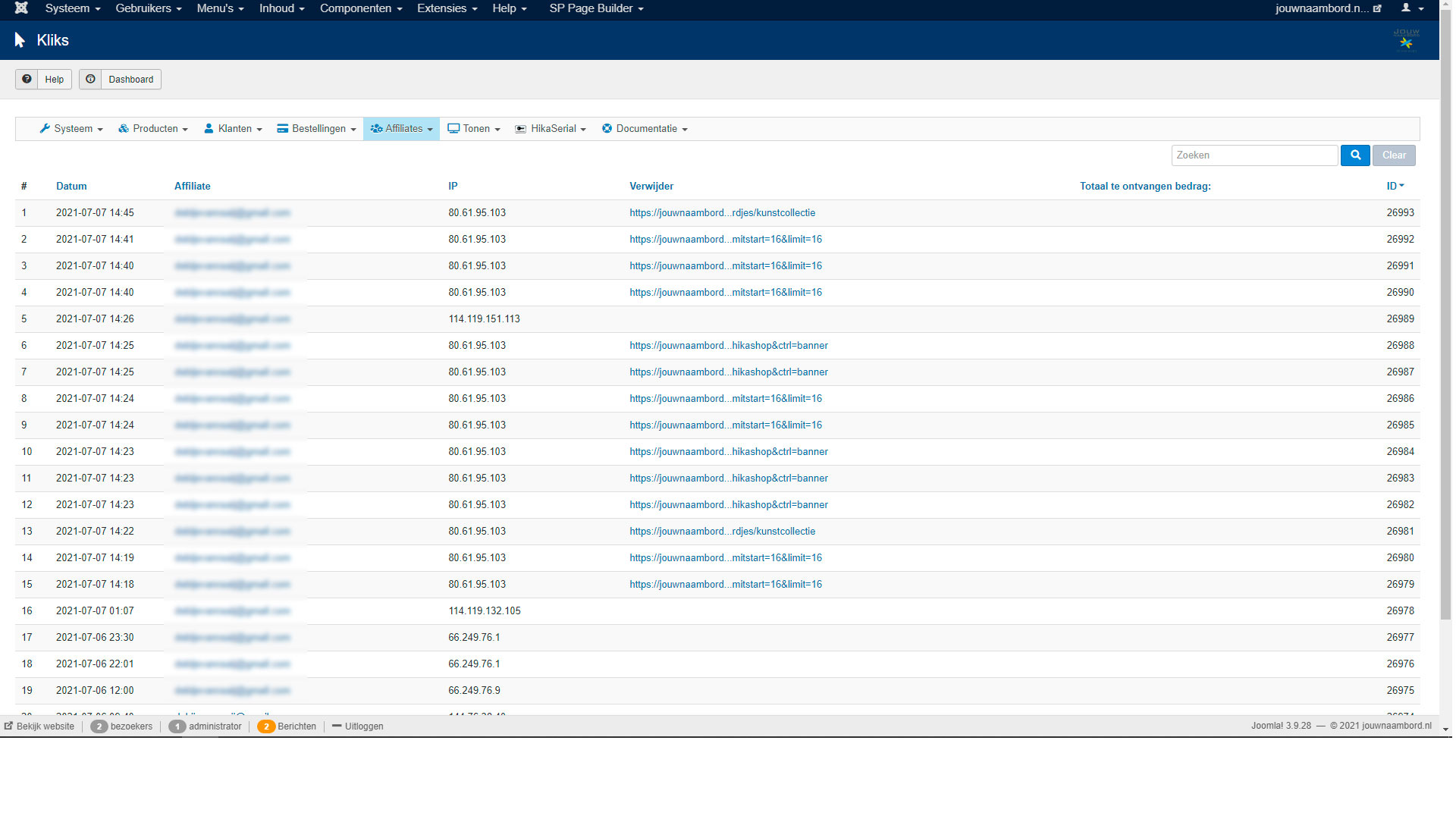

Well, the user is active and the affiliate is turned on and the partnername didn't change (screen 11). The entries are added to the clicks menu (screen13).

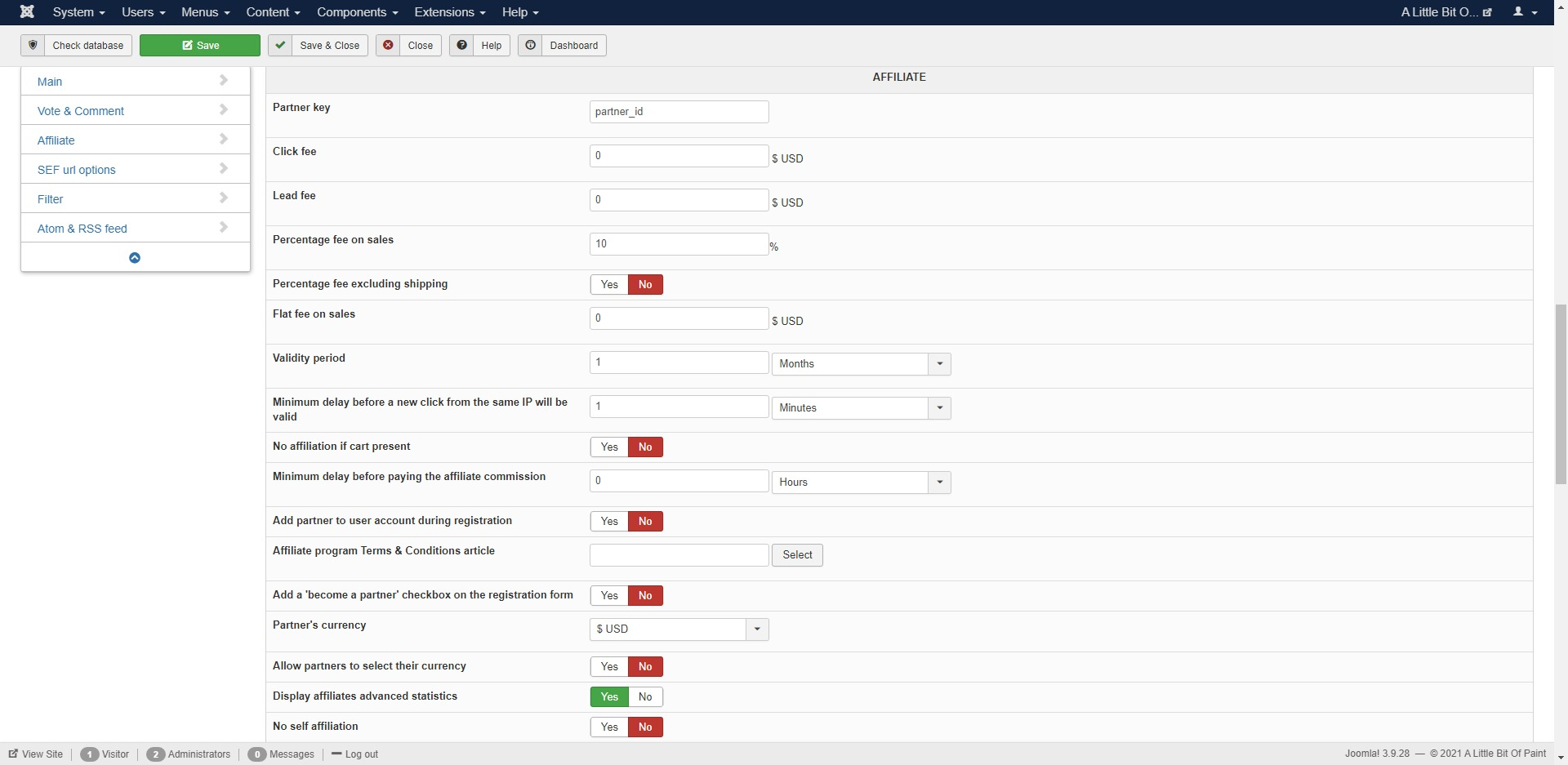

Hello, we are having a similar if not the same issue. A customer that had previously used an affiliate link with no issues placed another order with the same affiliate link and the second order does not show up. I am posting here and not a new thread because we have much in common. We also do not want customers to have access to the affiliate program. It is only for people the business owner chooses. Any ideas?
  • Posts: 85796
  • Thank you received: 14091
4 years 11 months ago #334757
So do you have cookie control extension like @michelpouli has on his website ?
Could you give an example affiliate link so that we can try it out ?
  • Posts: 5
4 years 11 months ago #334776
No I do not have any extensions like that. We only have one affiliate at this time. Here is the link.
www.alittlebitofpaint.com/index.php?partner_id=16
  • Posts: 85796
4 years 11 months ago #334781
I checked the link and the affiliate cookie is properly set in my browser when I use your affiliate link:
i.imgur.com/RzLJzdf.png
Are you able to reproduce the problem by placing an order from that affiliate link ?
Because looking at your affiliate settings and seeing that the cookie is set properly, I don't see why it wouldn't work.
