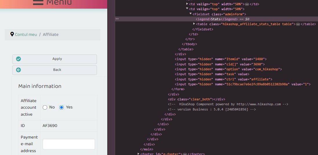

If I try to access the affiliation page from a mobilephone, to see my stats about my sails, there is a table with 2 colums, on the left side I can see "main info" and on the right side is "Statistics", but if I hit F12 and I use a small screen, like for mobile, tha right side of the table where the stats are, that information is not visible, it is under "main information".
Because if I delete from DOM the <td> element of "main information, the second <td> with stats become visible.

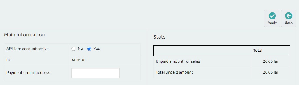

When there is not enough width available, the right side automatically moves below the left side so that both sides can use 100% of the width available.
So, if you scroll down, you should see the statistics area below the main information area.
