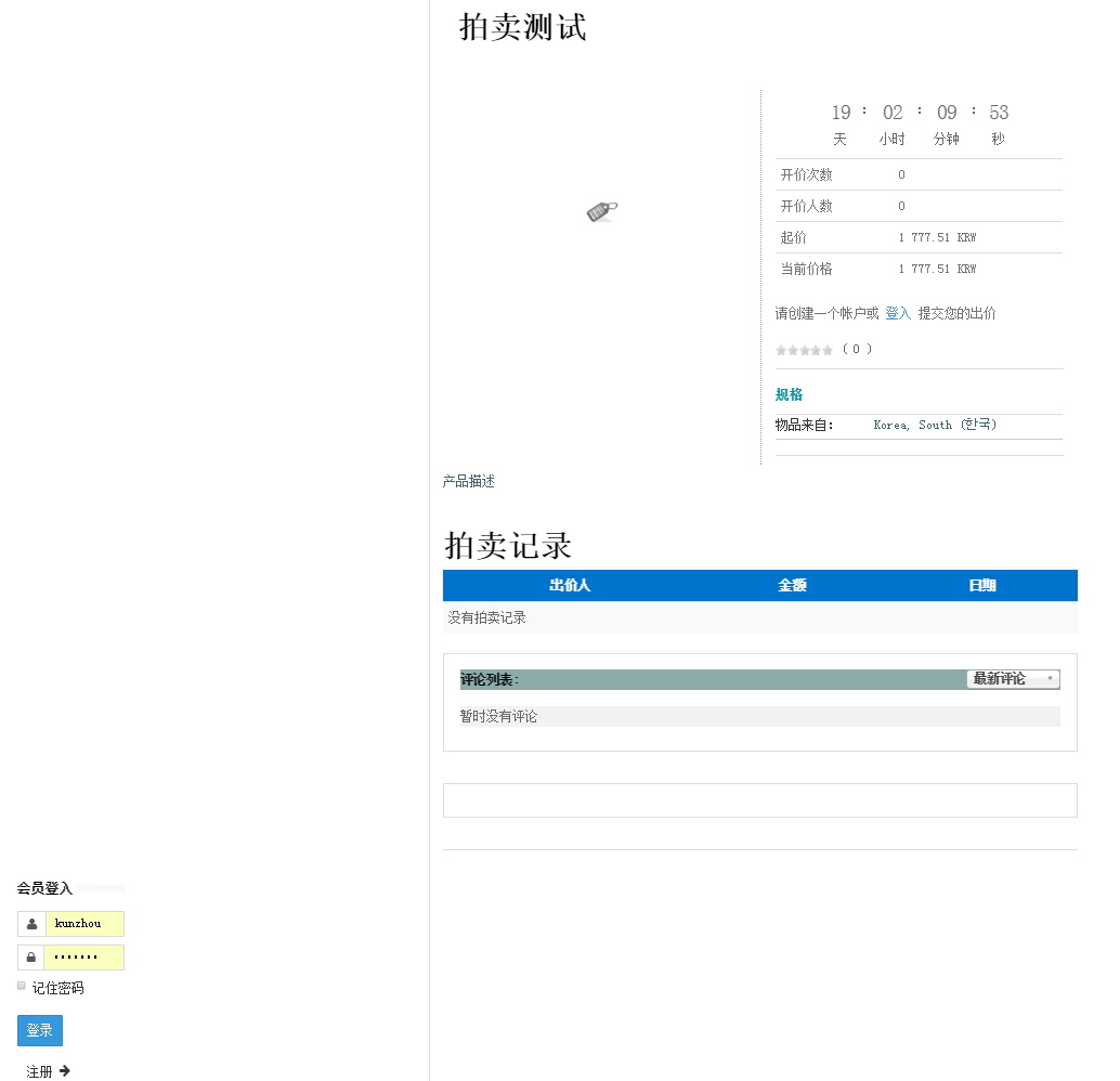

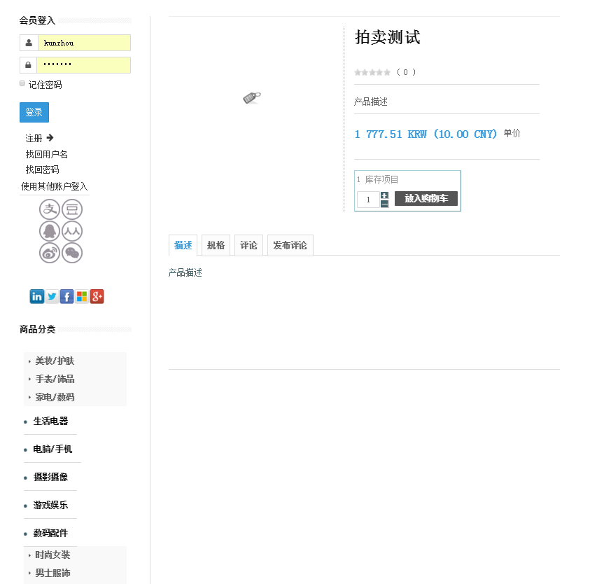

  • Posts: 49
10 years 8 months ago #223971
When the auction disabled, the product page displayed normally as shown below
the sidebar is close to the mainbody
however if the auction enabled, the product pagewill be like this:
the sidebar runs far away
you can use these two pages to compare the difference

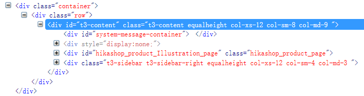

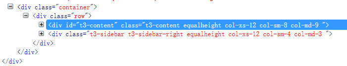

10 years 8 months ago #224263
Can you :
- Go to the page "Hikashop->Display->Views"
- Edit the file "Show_auction" of the "productauction" view of your front-end template
- Change that line :
<?php if(!empty($this->element->extraData->bottomEnd)) { echo implode("\r\n",$this->element->extraData->bottomEnd); } ?>
</div>
By :
</div> </div>
And test it again ?
Thanks.
