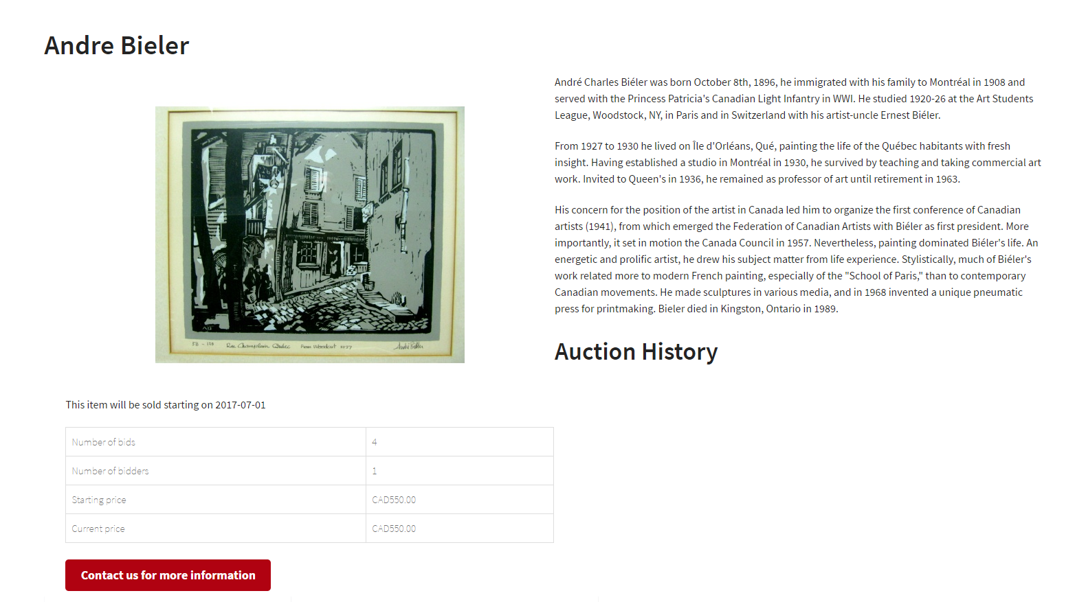

You actually had a view override through the "show_auction" file of the "poductauction" view of your front-end template, via "Hikashop->Display->Views". You'll find attached, a screenshots of what I have when I remove your changes.
Your view's override prevented the fix that was added on the last HikaAuction to be applied so you should remove it and adapt again the new version of the "show_auction" file if you need it.

Sure, but you won't have to add any code, you'll just have to remove your customization on the "Show_auction" file of the "Auction" view of your front-end template using the "trash" button via "Hikashop->Display->Views", then it should work fine.
