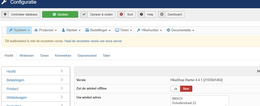

  • Posts: 6
5 years 5 months ago #330648
hi Mohamed,
Thx for te info, but I don't see a cron tab in configuration, we have to activate this somewhere.
5 years 5 months ago #330659
That's probably coming from the edition of Hikashop you are using, the cron available in all commercial version of Hikashop.
Kind regards,
Mohamed
