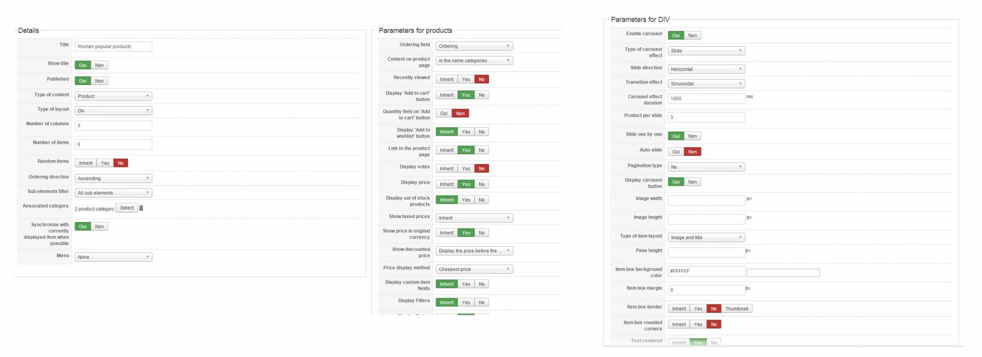

  • Posts: 47
11 years 2 months ago #204812
I attached you a screenshot of my module.

11 years 2 months ago #204929
This looks good. Can you make sure that you cleared your website caching ?
Also, could you enable the access to your website again so that we can look at it again ?

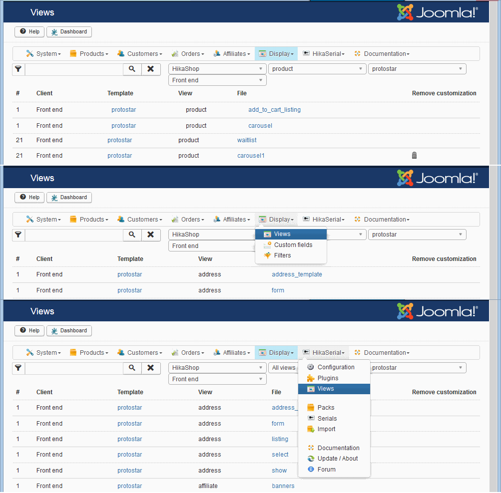

@nicolas could you explain what can we achieve when overide system plugin in this case ?
Carousel is a module so How can we achieve carousel overide ?
1) since hikashop is not follow the joomla way ( overide article ) i understand now that i need ot understand how design custom layout work !
If i spy how hikashop backend work , whe ni click on display icon i can override ( copy file name and content php code to another location ) by clicking on the name link
hikashop do that on file system :
a.) copy the file components/com_hikashop/views/product/tmpl/carousel.php
b.) paste the file /templates/protostar/html/com_hikashop/product/carousel.php ( rename carousel1.php manually)
here it seem we try to override a component ? ( to be confirm)

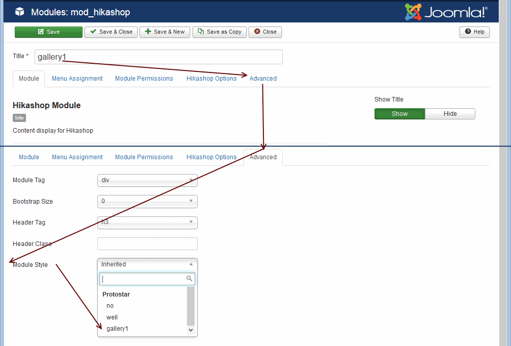

the questio nis what i have to do more to be able to instanciate carousel1.php module ?
Attachment not found
OR
do i need to create a mod_chrome function call gallery1 and configure module to use it ?

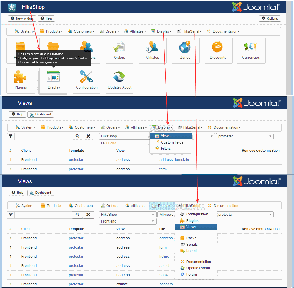

B.) What the difference with the display icon ,the hikaserial->views, the Display->views in hiakshop backEnd .?
a display= View + layout ?
$model = $this->getModel('teams');
$view = $this->getView('teams','html');
$view->setModel($model);
$view->setLayout('modal');
$view->display();
Does the meaning of the both term display or view change beetween hikashop and joomla ?

0. Nothing. That's why I said that it was not related.
The carousel system is handled with views, so you can override it with normal view overrides. For the example, the one which contains all the logic of the carousel is the file "carousel" of the view "product".
1.A Why do you say that ? HikaShop does follow the "joomla way". You can override the views like other joomla views. In fact your could override the HikaShop views via the Joomla template manager if you want. It's just easier (I think) to do it through HikaShop's interface).
1.B they are the same.
The following user(s) said Thank You: lionel75
