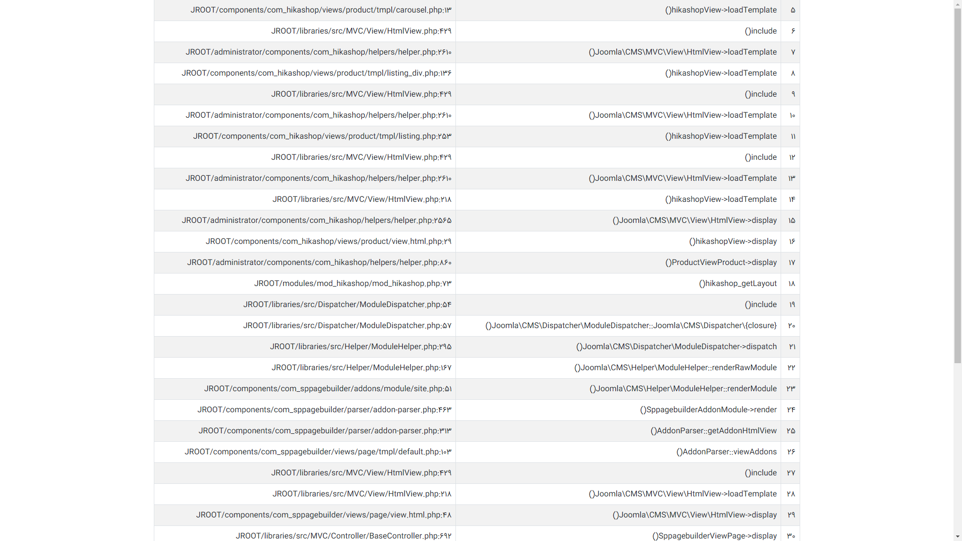

I get a 500 behavior::framework not found error when I select the carousel display option in the hikashop content module.
The debug mode image was also attached.
thank you very much.

I can't read the numbers on your screenshot.
However, I suppose that the issue is that you have the legacy carousel system activated under the advanced tab of the HikaShop configuration.
Please turn that off as the legacy carousel is not compatible with Joomla 4.

Thank you very very much.
You said right. The problem was the same.
