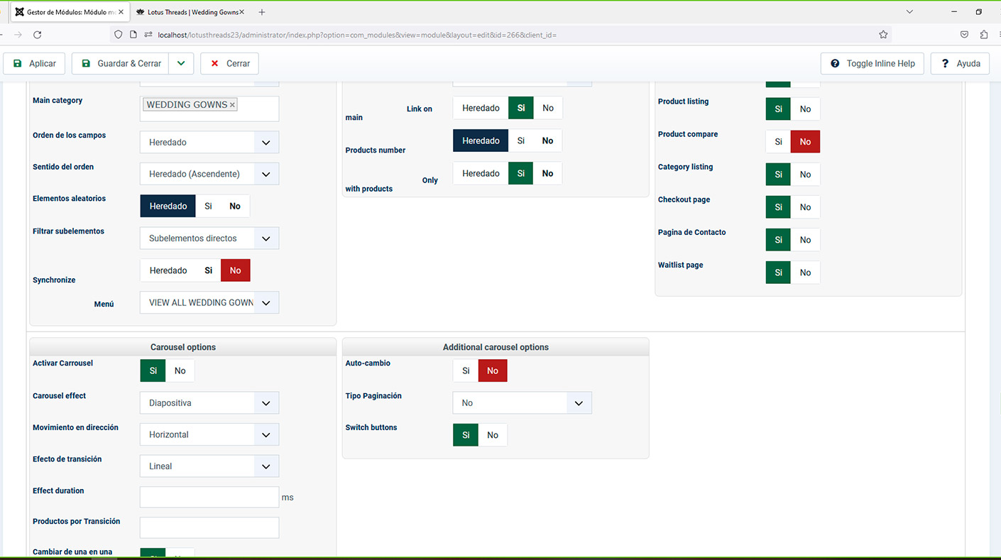

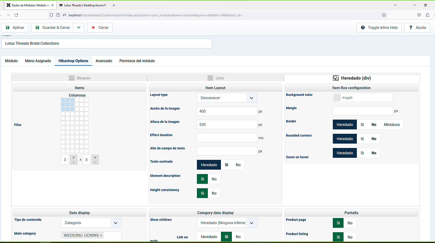

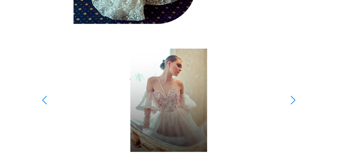

After the latest hikashop update, the Carousel Switch buttons do not work when the content is categories.
Also, when the page loads only one slide appears, it does not show the three that are configured. Refreshing the browser does not update the view, I have to navigate within the website and return for it to load.

Thanks. I was able to investigate the issue and I've added a patch which should fix the problem.
Download again the install package of HikaShop on our website and install it on yours to get the patch.
