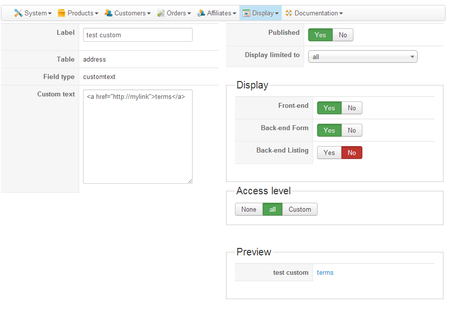

There is indeed no option to add such a link to the label of a field. I would recommend instead to create a custom field of the type "custom text" to add such link just before the checkbox custom field.

Ok I got the custom text showing up but it drops the link. How do I get it to show as a link instead of plain text.

12 years 11 months ago #120057
It works fine for me on my end with a link in it:

12 years 11 months ago #120071
Thank you very much, Nicolas. Mine is working fine now as well thanks to the code you showed me. I really appreciate your patience with my ignorance.
