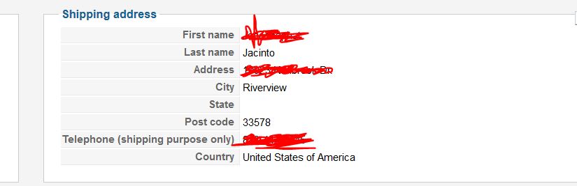

12 years 10 months ago #124608
This shows the state not showing. State is published and shows in checkout but orders listing does not show it.
12 years 10 months ago #124697
This has been corrected on our end, and it will be in the next release.
Thanks for the report.

12 years 10 months ago #124762
We fixed several things in the "zone" custom fields system, it is possible that we fixed the problem you have.
If you want to send us an access to your store, we can see to install a preview version of HikaShop 2.2.2 and see if the problem is right fixed.
HikaShop 2.2.2 is currently in test in our side, we want to release it before the end of the month.
